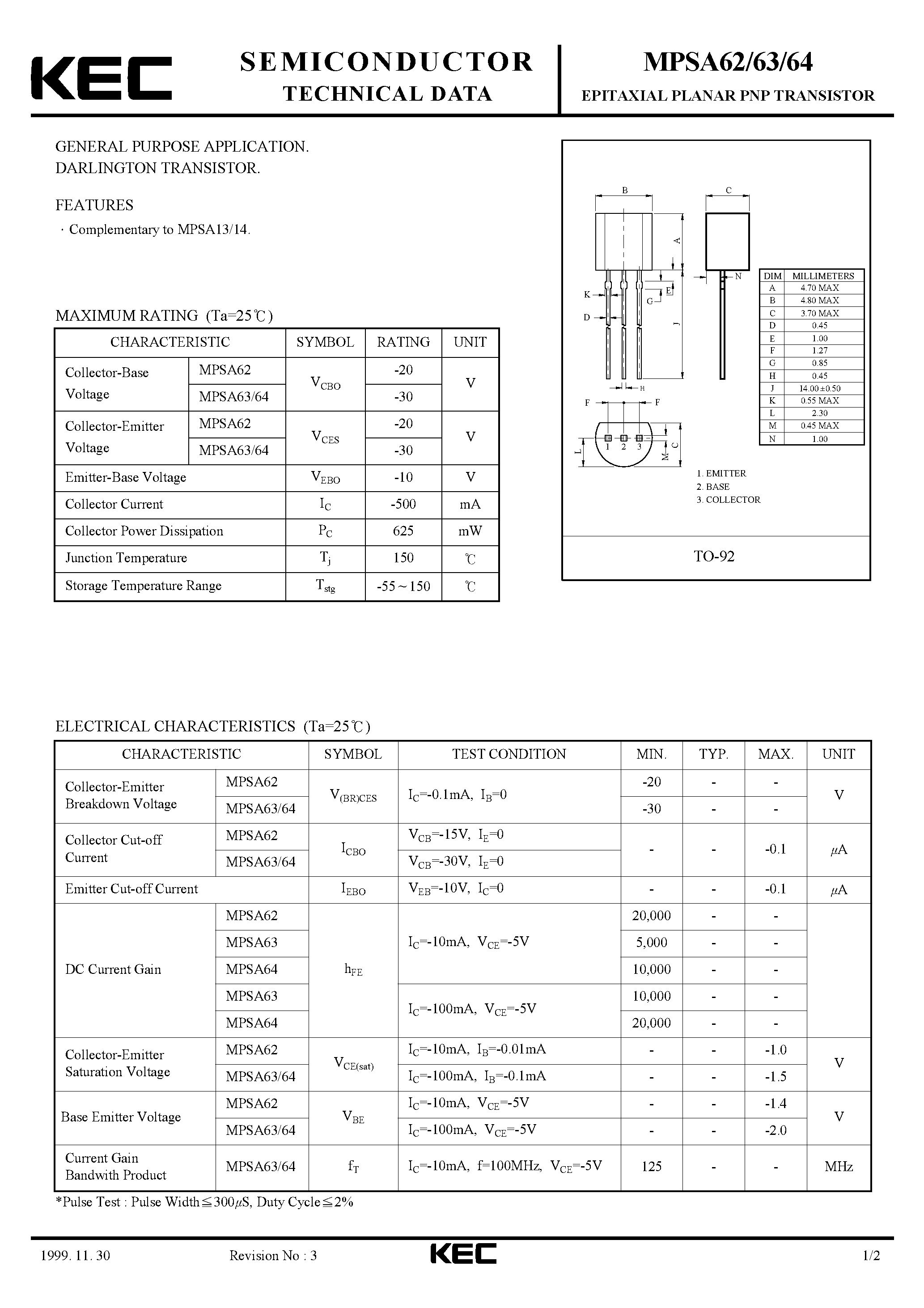

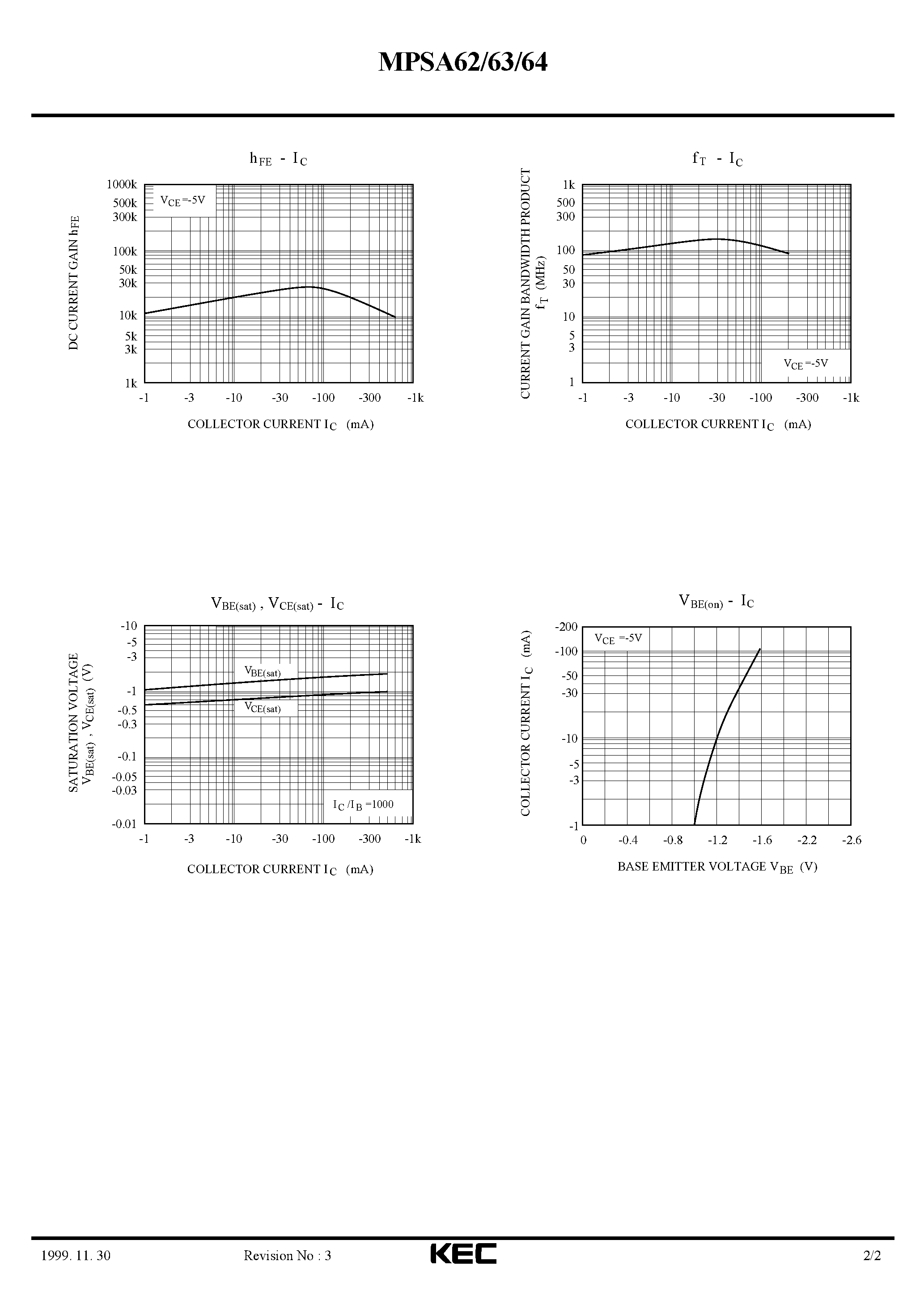

MPSA63-EPITAXIAL PLANAR PNP TRANSISTOR (GENERAL PURPOSE DARLINGTON TRANSISTOR)
Producer:KEC
Description:EPITAXIAL PLANAR PNP TRANSISTOR (GENERAL PURPOSE DARLINGTON TRANSISTOR)
Others with the same file: MPSA63
Datasheet MPSA63 - EPITAXIAL PLANAR PNP TRANSISTOR (GENERAL PURPOSE DARLINGTON TRANSISTOR) page 1
Datasheet MPSA63 - EPITAXIAL PLANAR PNP TRANSISTOR (GENERAL PURPOSE DARLINGTON TRANSISTOR) page 2
