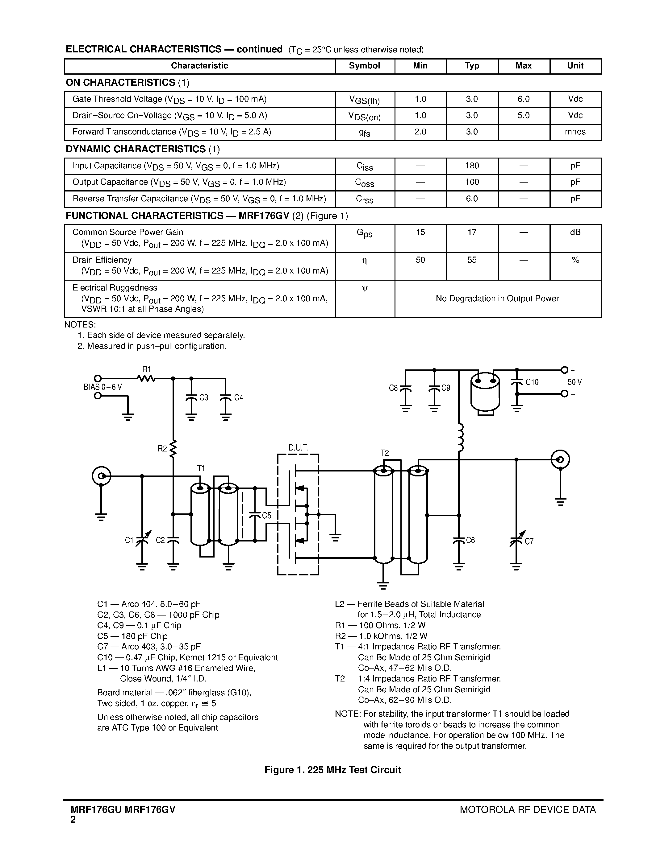

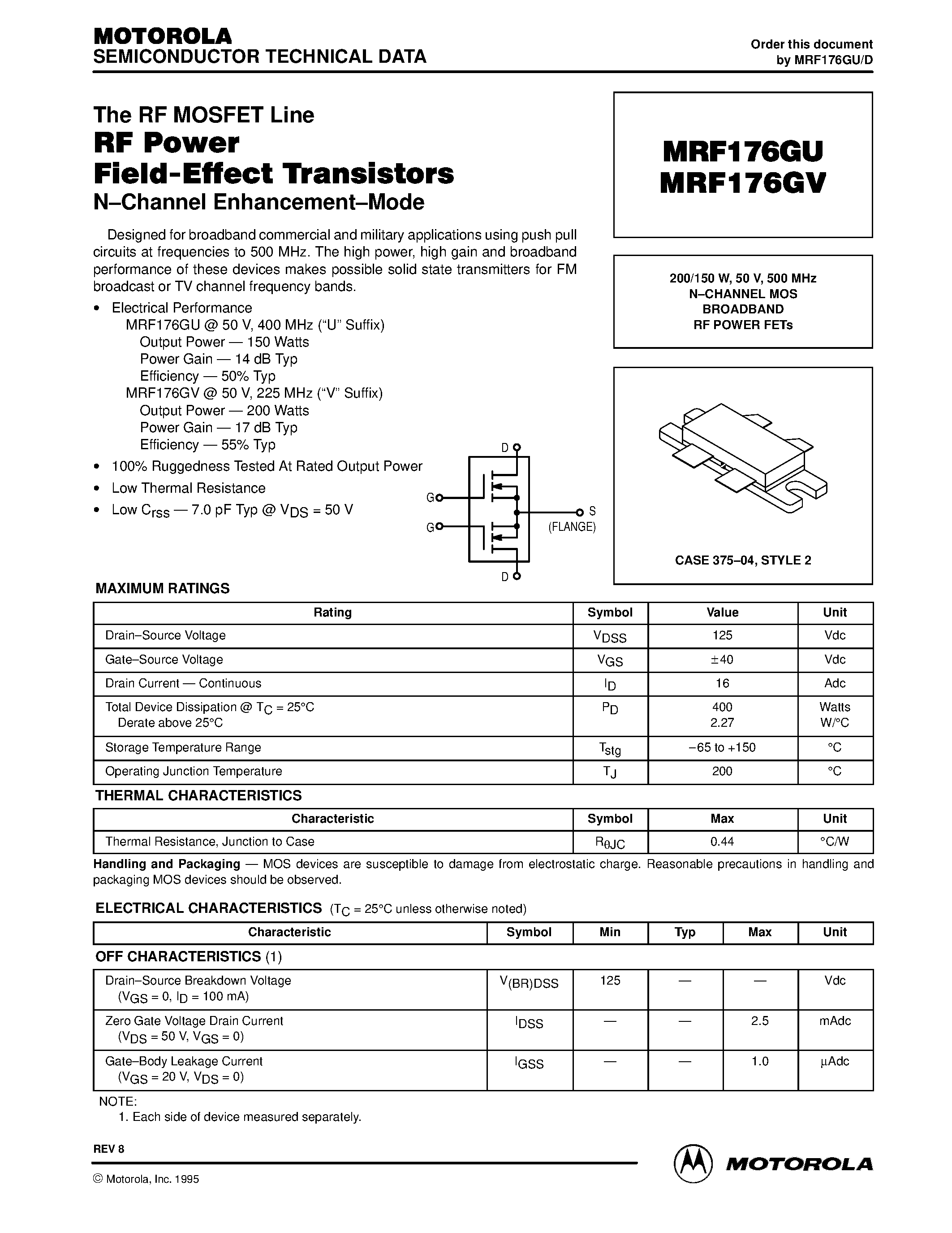

MRF176GU-(MRF176GU/GV) N-CHANNEL MOS BROADBAND RF POWER FETs
Producer:Motorola
Description:(MRF176GU/GV) N-CHANNEL MOS BROADBAND RF POWER FETs
Others with the same file: MRF176GU | MRF176GV
