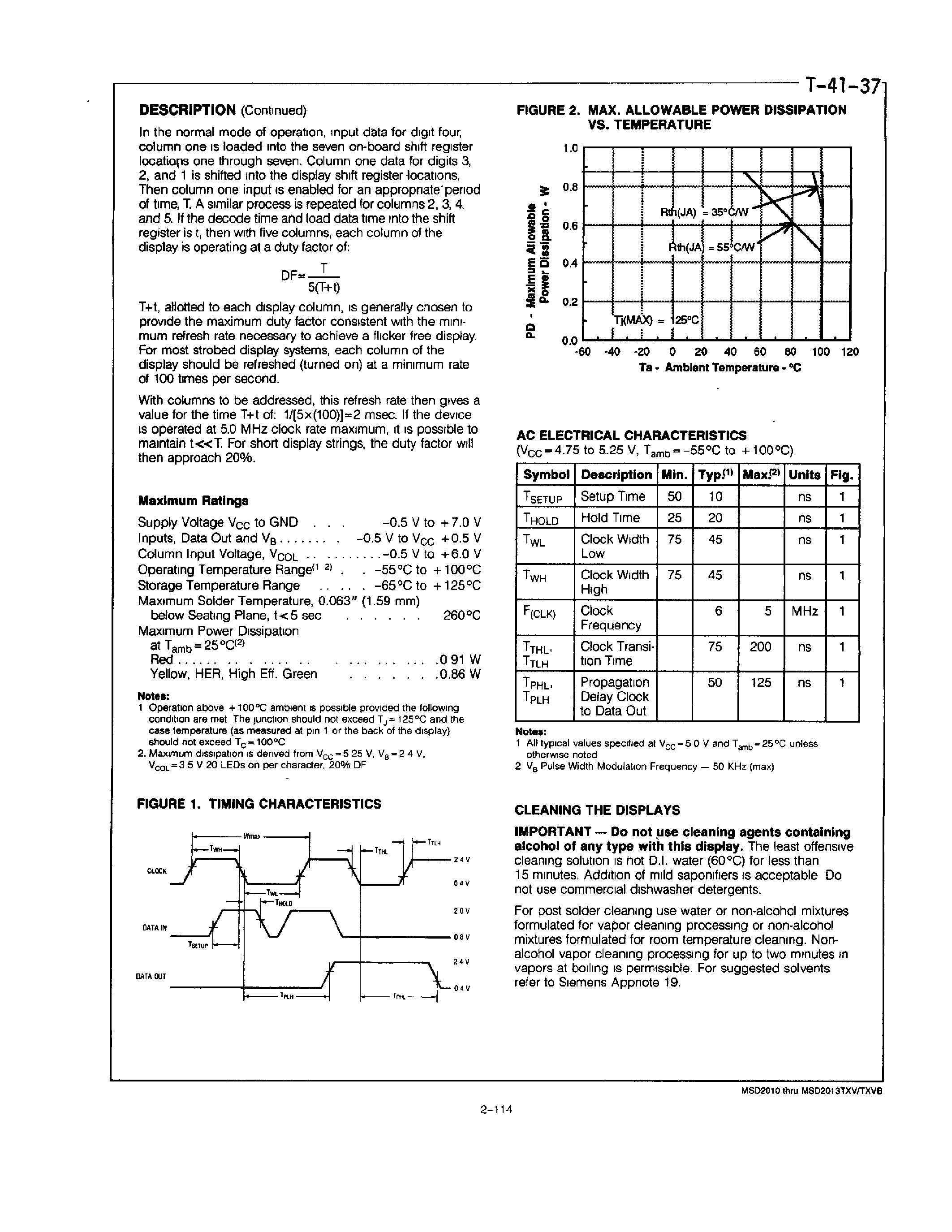

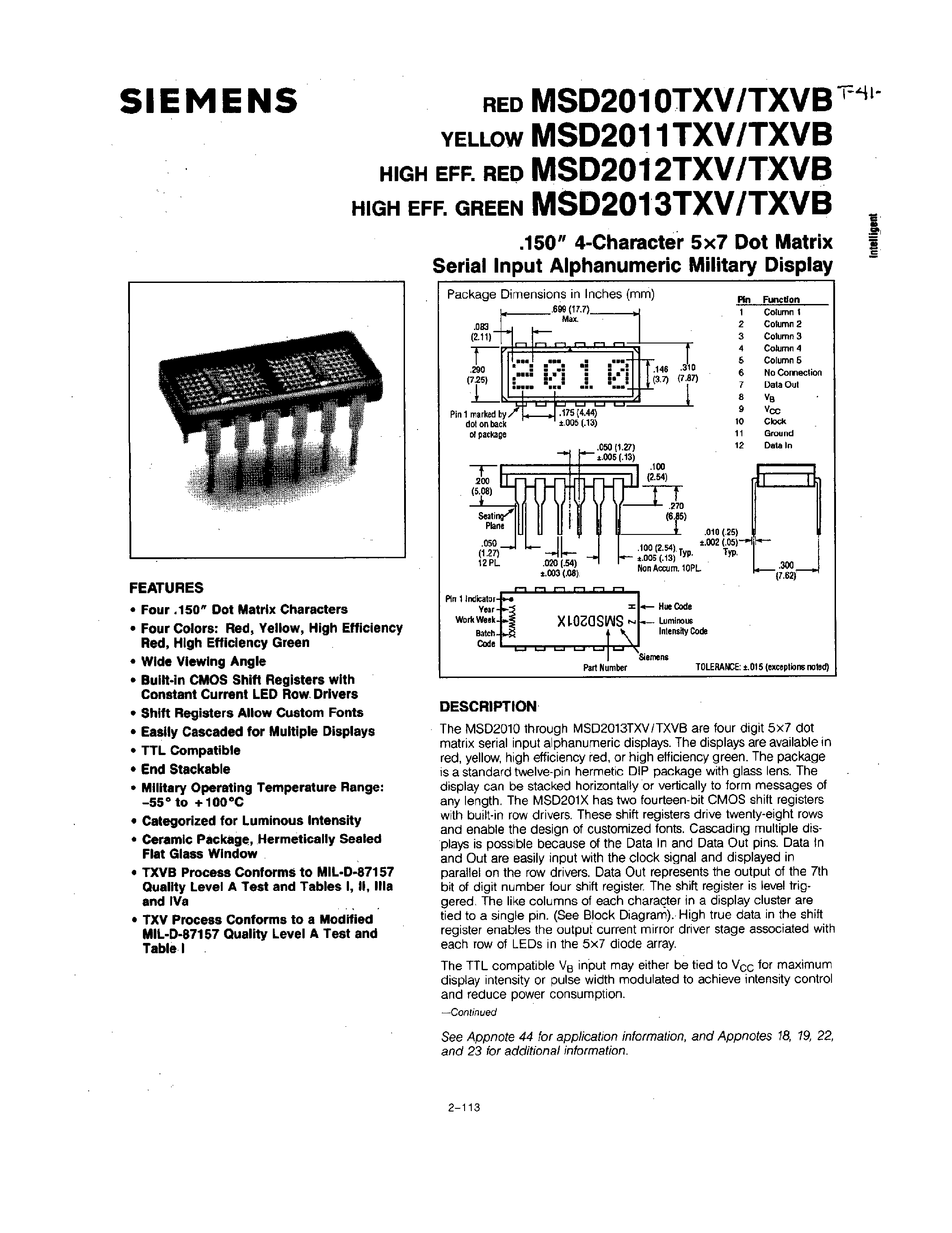

MSD2010TXV-(MSD2010 - MSD2013) 150 4-Character 5x7 Dot Matrix Serial Input Alphanumeric Military Display
Producer:Siemens Semiconductor
Description:(MSD2010 - MSD2013) 150 4-Character 5x7 Dot Matrix Serial Input Alphanumeric Military Display
