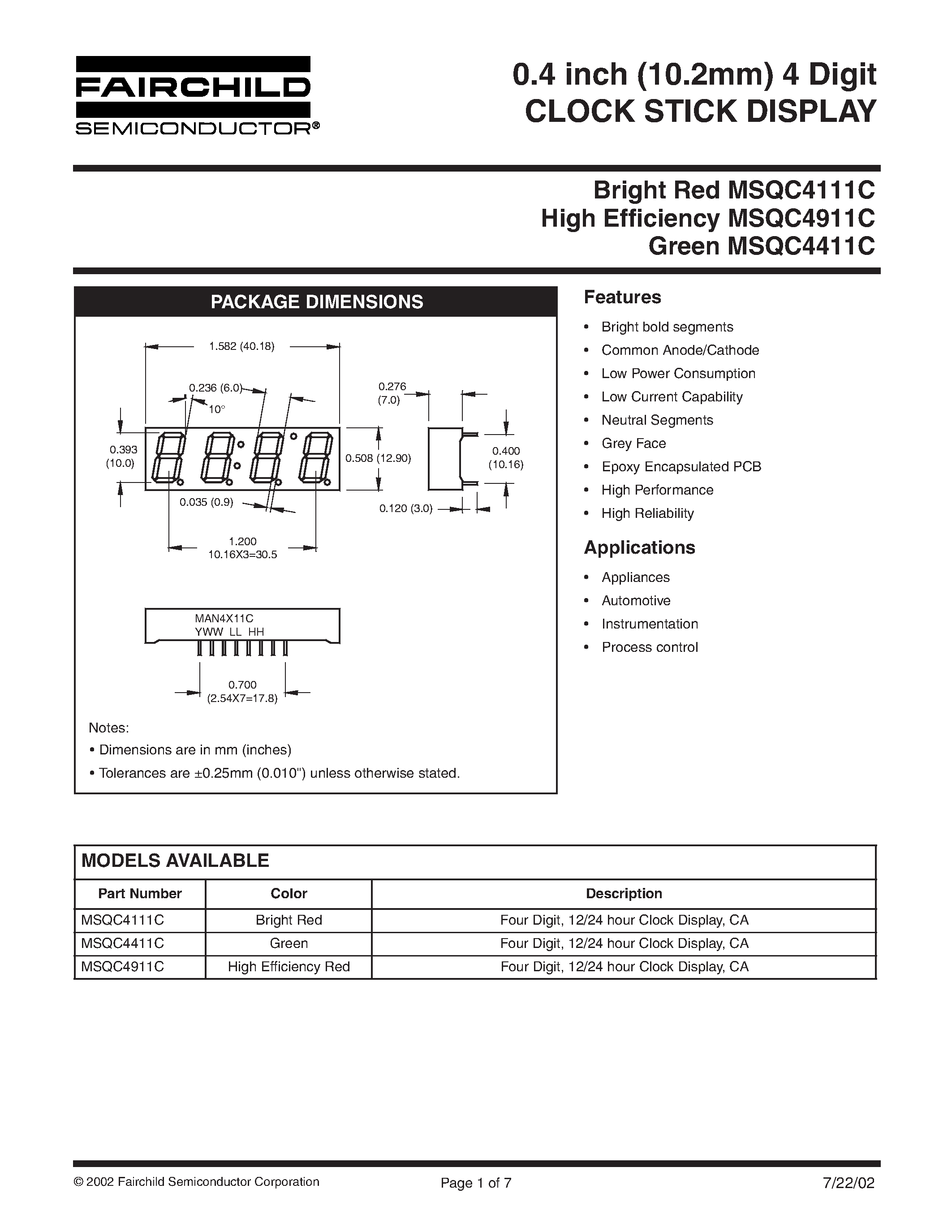

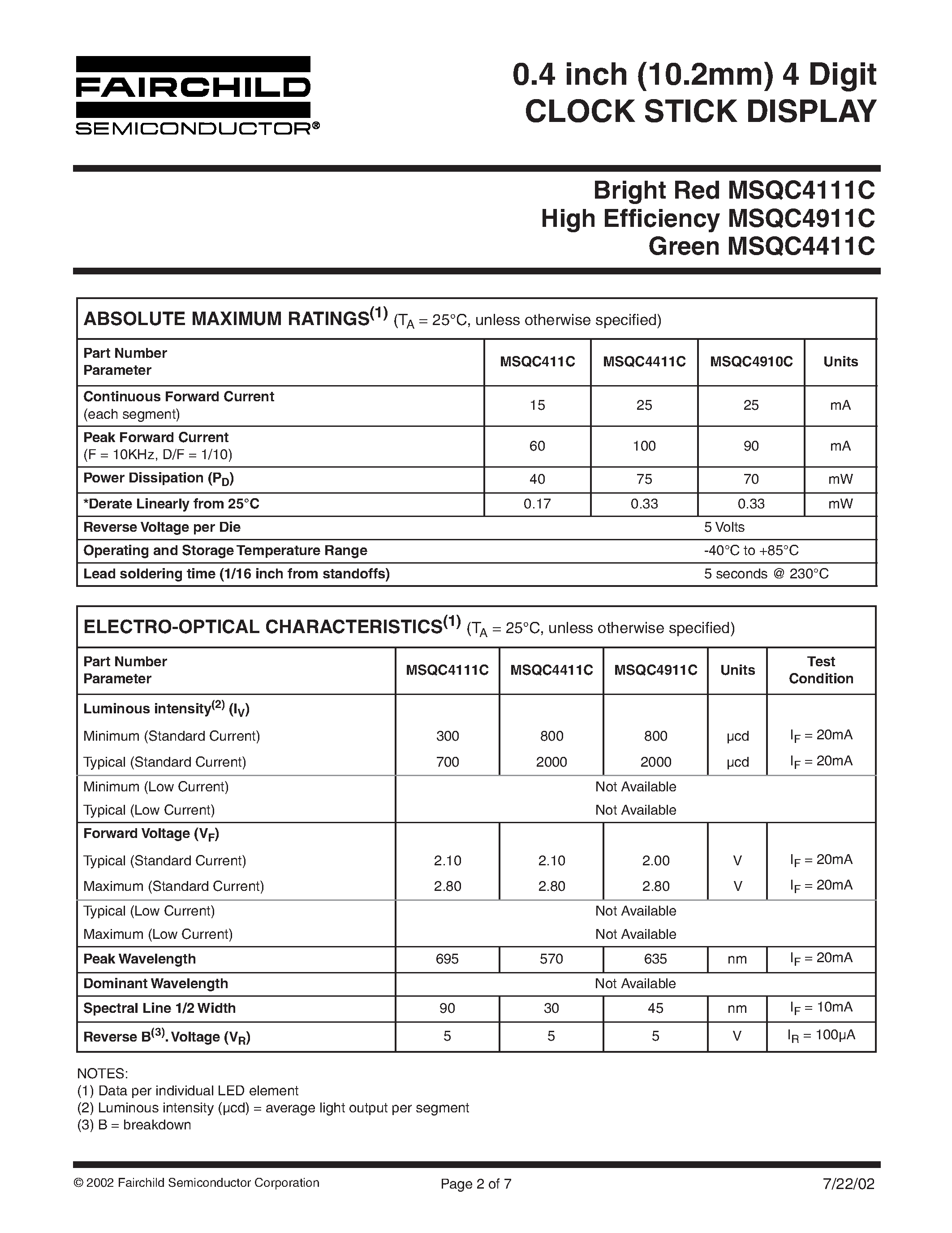

MSQC4111C-(MSQC4111C - MSQC4911C) 0.4 inch (10.2mm) 4 Digit CLOCK STICK DISPLAY
Description:(MSQC4111C - MSQC4911C) 0.4 inch (10.2mm) 4 Digit CLOCK STICK DISPLAY
Others with the same file: MSQC4111C | MSQC4411C
MSQC4911C
Datasheet MSQC4111C - (MSQC4111C - MSQC4911C) 0.4 inch (10.2mm) 4 Digit CLOCK STICK DISPLAY page 1
Datasheet MSQC4111C - (MSQC4111C - MSQC4911C) 0.4 inch (10.2mm) 4 Digit CLOCK STICK DISPLAY page 2
