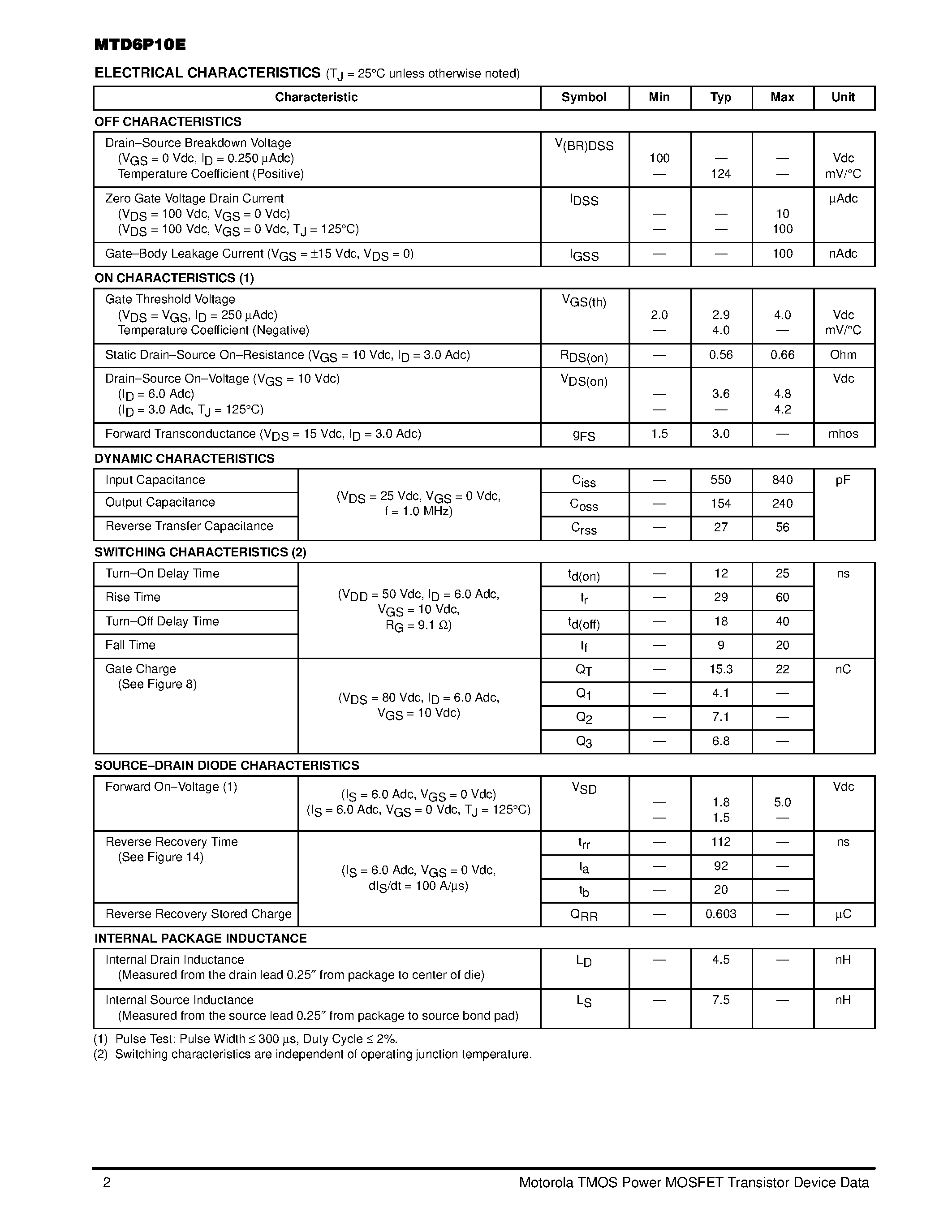

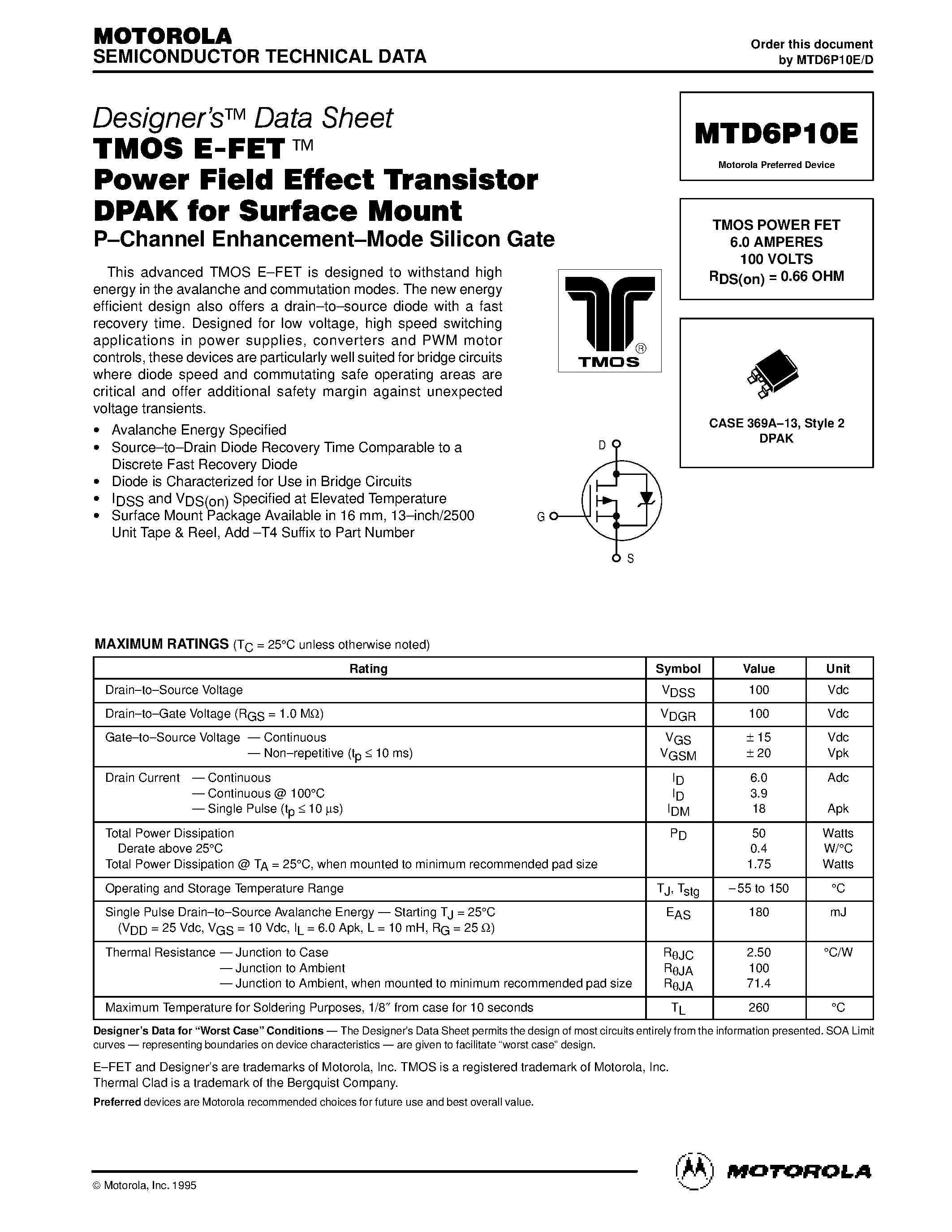

MTD6P10E-TMOS POWER FET 6.0 AMPERES 100 VOLTS RDS(on) = 0.66 OHM
Producer:Motorola
Description:TMOS POWER FET 6.0 AMPERES 100 VOLTS RDS(on) = 0.66 OHM
Others with the same file: MTD6P10E
Datasheet MTD6P10E - TMOS POWER FET 6.0 AMPERES 100 VOLTS RDS(on) = 0.66 OHM page 1
Datasheet MTD6P10E - TMOS POWER FET 6.0 AMPERES 100 VOLTS RDS(on) = 0.66 OHM page 2
