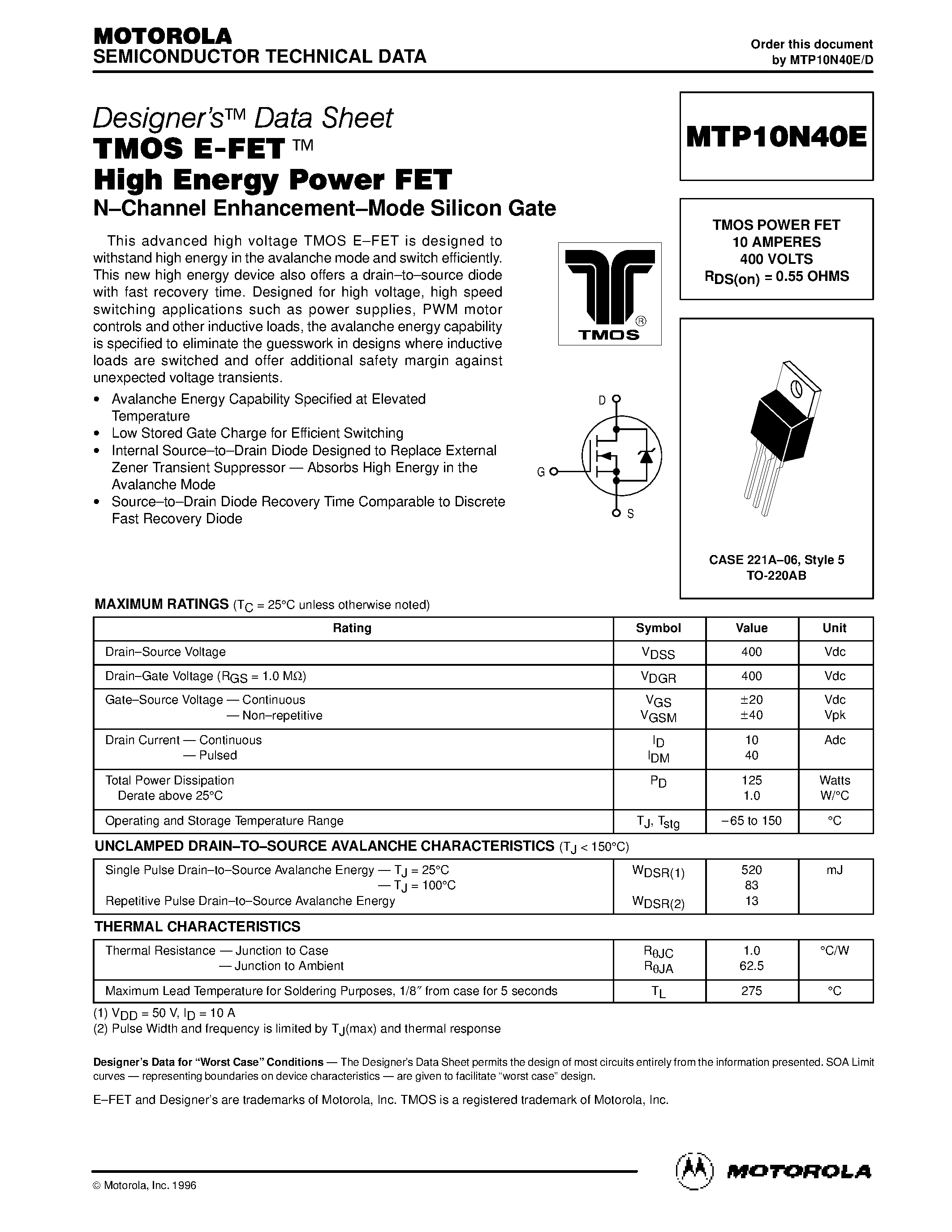

MTP10N40E-TMOS POWER FET 10 AMPERES 400 VOLTS RDS(on) = 0.55 OHMS
Producer:Motorola
Description:TMOS POWER FET 10 AMPERES 400 VOLTS RDS(on) = 0.55 OHMS
Others with the same file: MTP10N40E
Datasheet MTP10N40E - TMOS POWER FET 10 AMPERES 400 VOLTS RDS(on) = 0.55 OHMS page 1

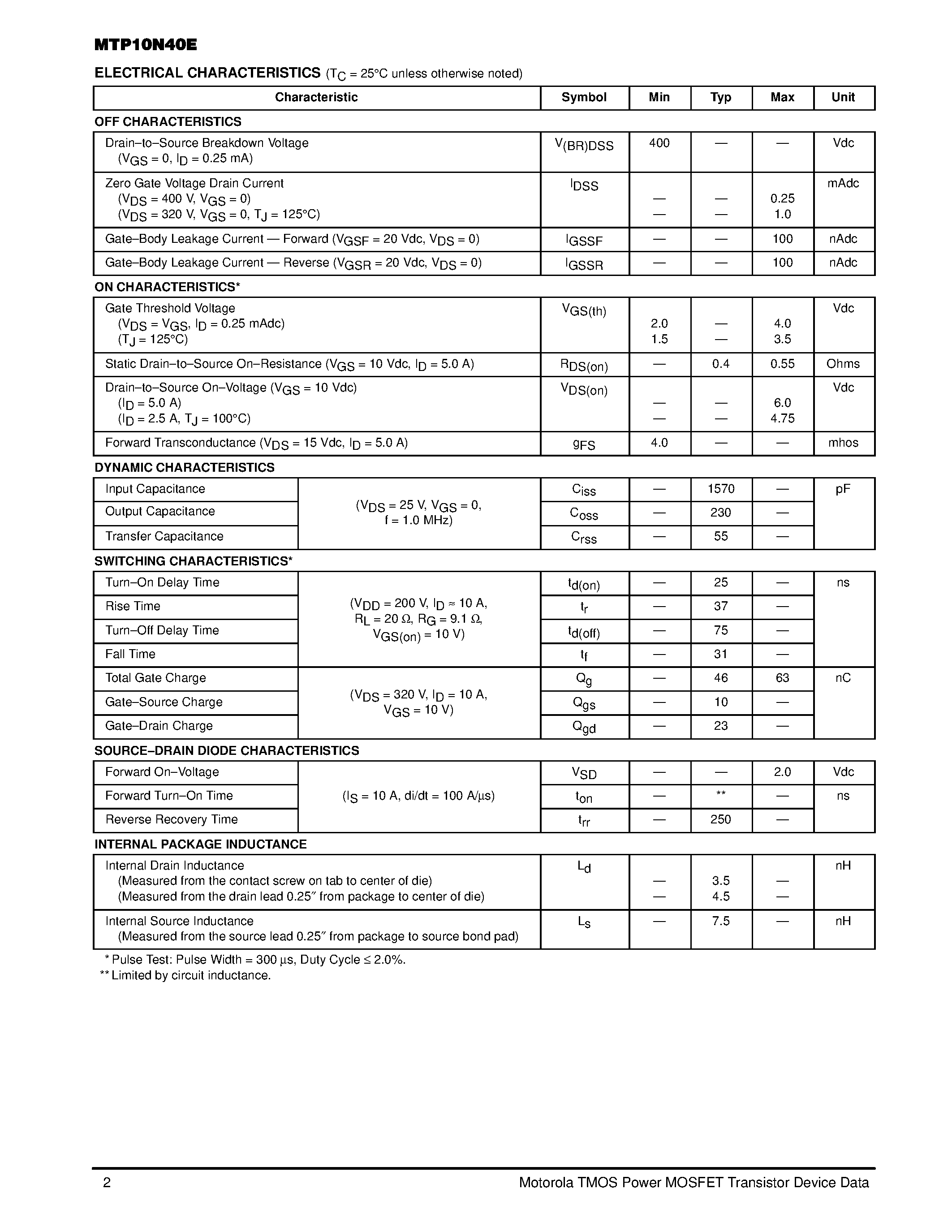

Datasheet MTP10N40E - TMOS POWER FET 10 AMPERES 400 VOLTS RDS(on) = 0.55 OHMS page 2
