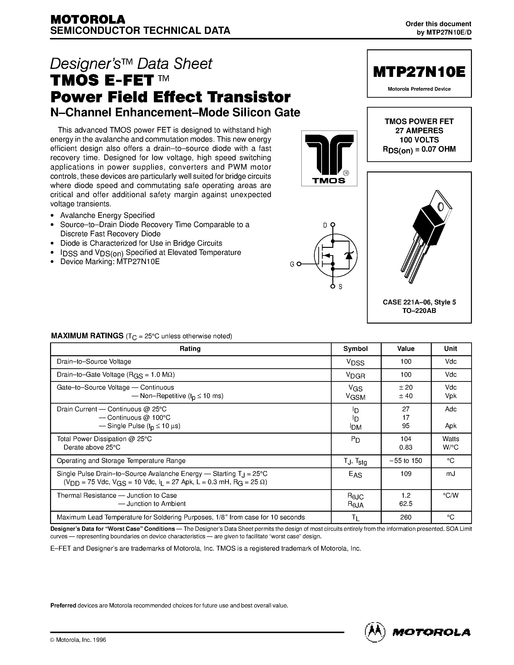

MTP12N10E-TMOS POWER FET 12 AMPERES 100 VOLTS RDS(on) = 0.16 OHM
Producer:Motorola
Description:TMOS POWER FET 12 AMPERES 100 VOLTS RDS(on) = 0.16 OHM
Others with the same file: MTP12N10E
Datasheet MTP12N10E - TMOS POWER FET 12 AMPERES 100 VOLTS RDS(on) = 0.16 OHM page 1
Datasheet MTP12N10E - TMOS POWER FET 12 AMPERES 100 VOLTS RDS(on) = 0.16 OHM page 2
