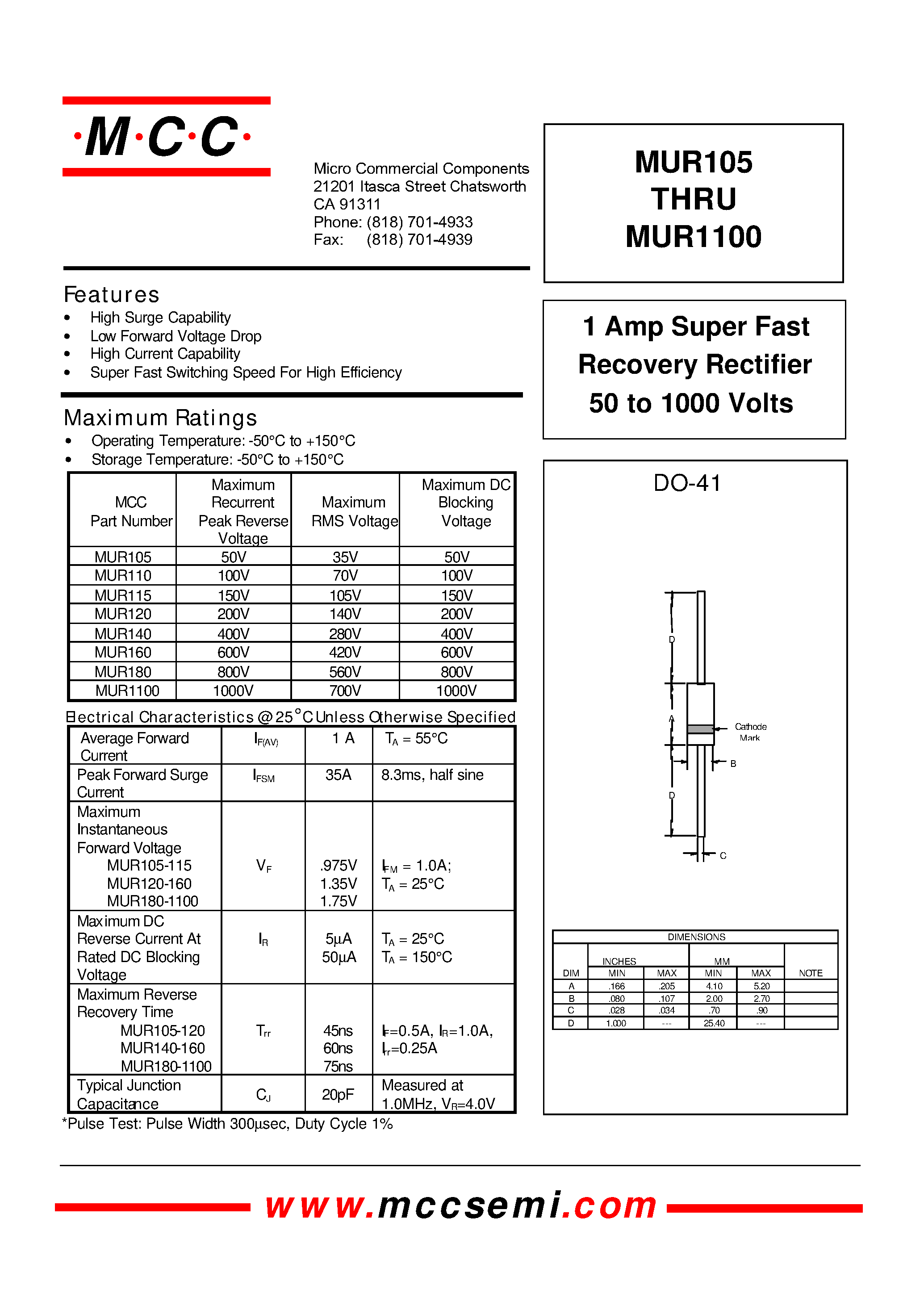

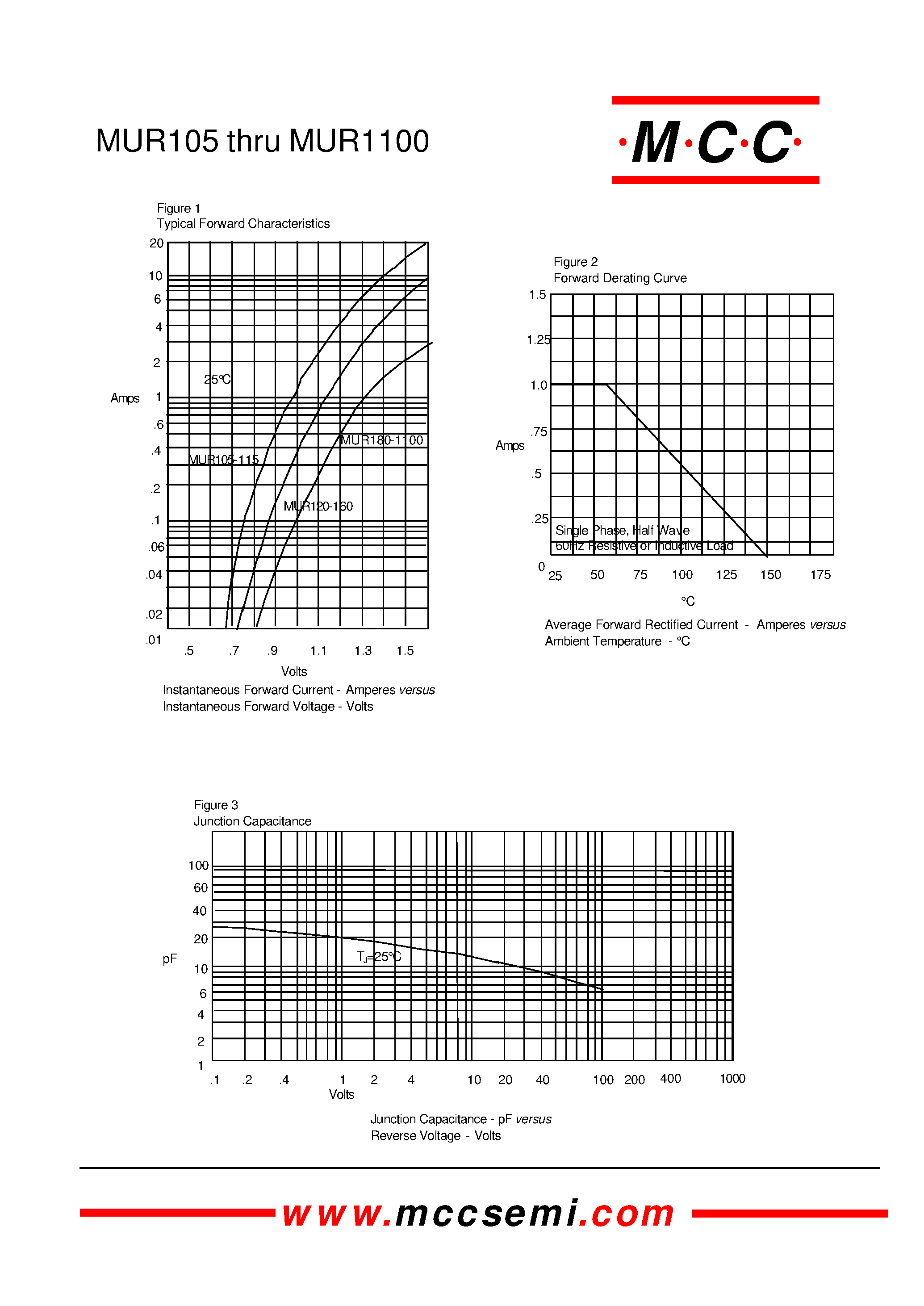

MUR105-(MUR105 - MUR1100) 1 Amp Super Fast Recovery Rectifier 50 to 1000 Volts
Producer:MCC
Description:(MUR105 - MUR1100) 1 Amp Super Fast Recovery Rectifier 50 to 1000 Volts
