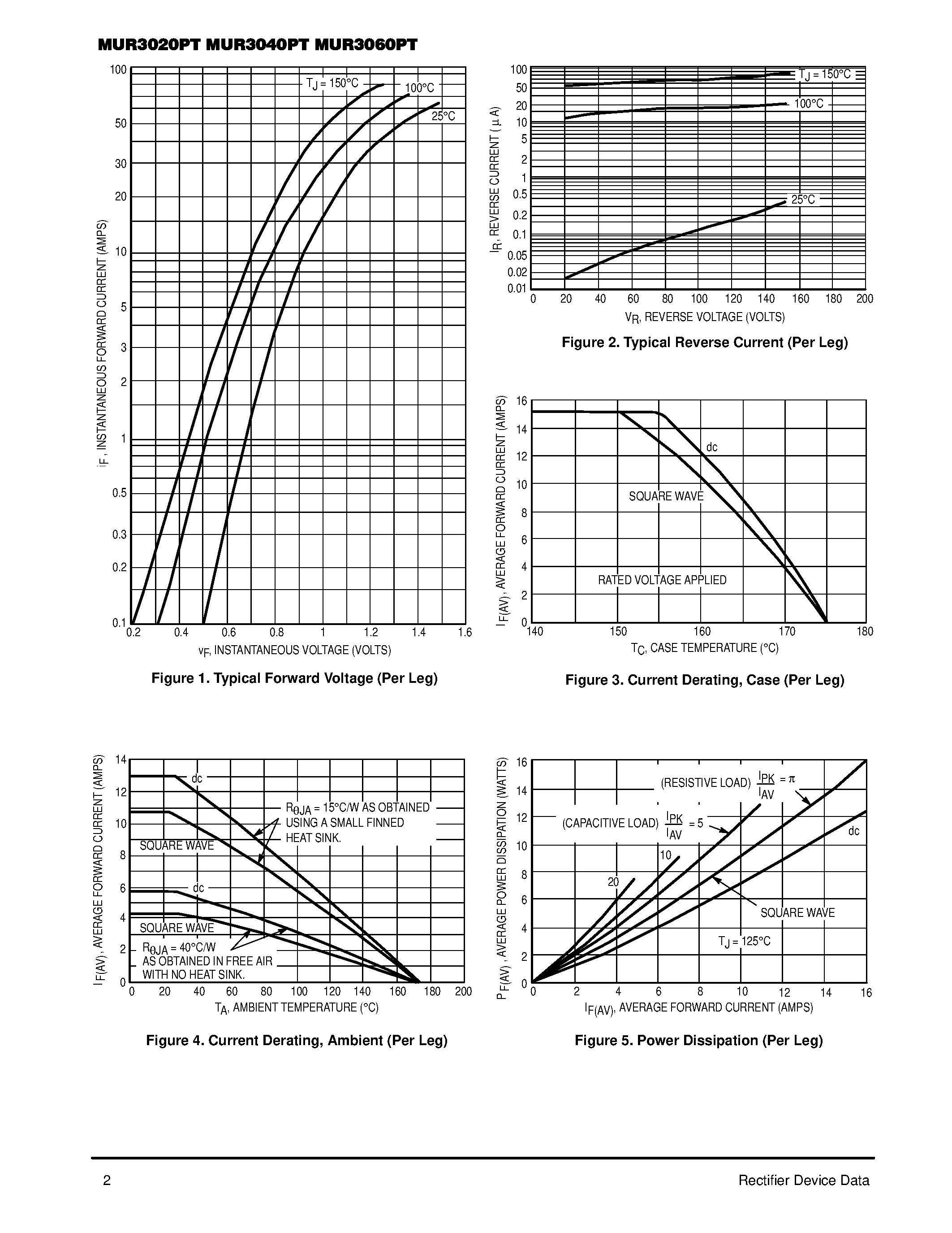

MUR3020PT-(MUR3020PT - MUR3060PT) ULTRAFAST RECTIFIERS 30 AMPERES 200-400-600 VOLTS
Producer:Motorola
Description:(MUR3020PT - MUR3060PT) ULTRAFAST RECTIFIERS 30 AMPERES 200-400-600 VOLTS
