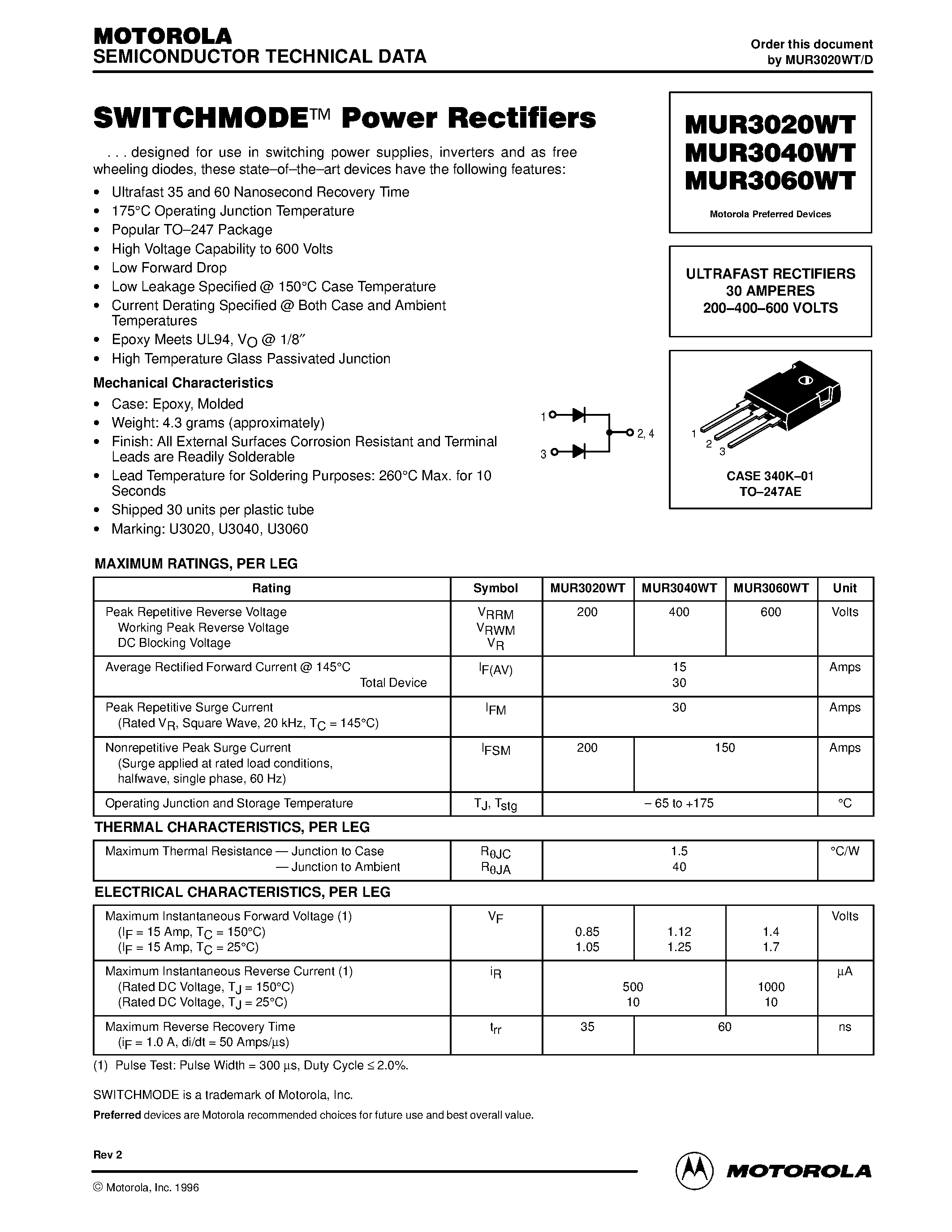

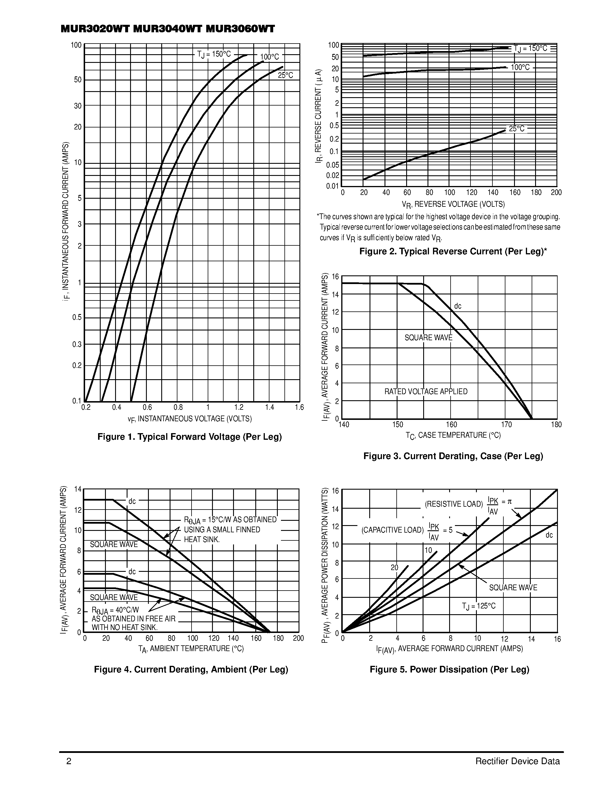

MUR3020WT-(MUR3020WT - MUR3060WT) ULTRAFAST RECTIFIERS 30 AMPERES 200-400-600 VOLTS
Producer:Motorola
Description:(MUR3020WT - MUR3060WT) ULTRAFAST RECTIFIERS 30 AMPERES 200-400-600 VOLTS
Others with the same file: MUR3020WT | MUR3040WT
MUR3060WT
Datasheet MUR3020WT - (MUR3020WT - MUR3060WT) ULTRAFAST RECTIFIERS 30 AMPERES 200-400-600 VOLTS page 1
Datasheet MUR3020WT - (MUR3020WT - MUR3060WT) ULTRAFAST RECTIFIERS 30 AMPERES 200-400-600 VOLTS page 2
