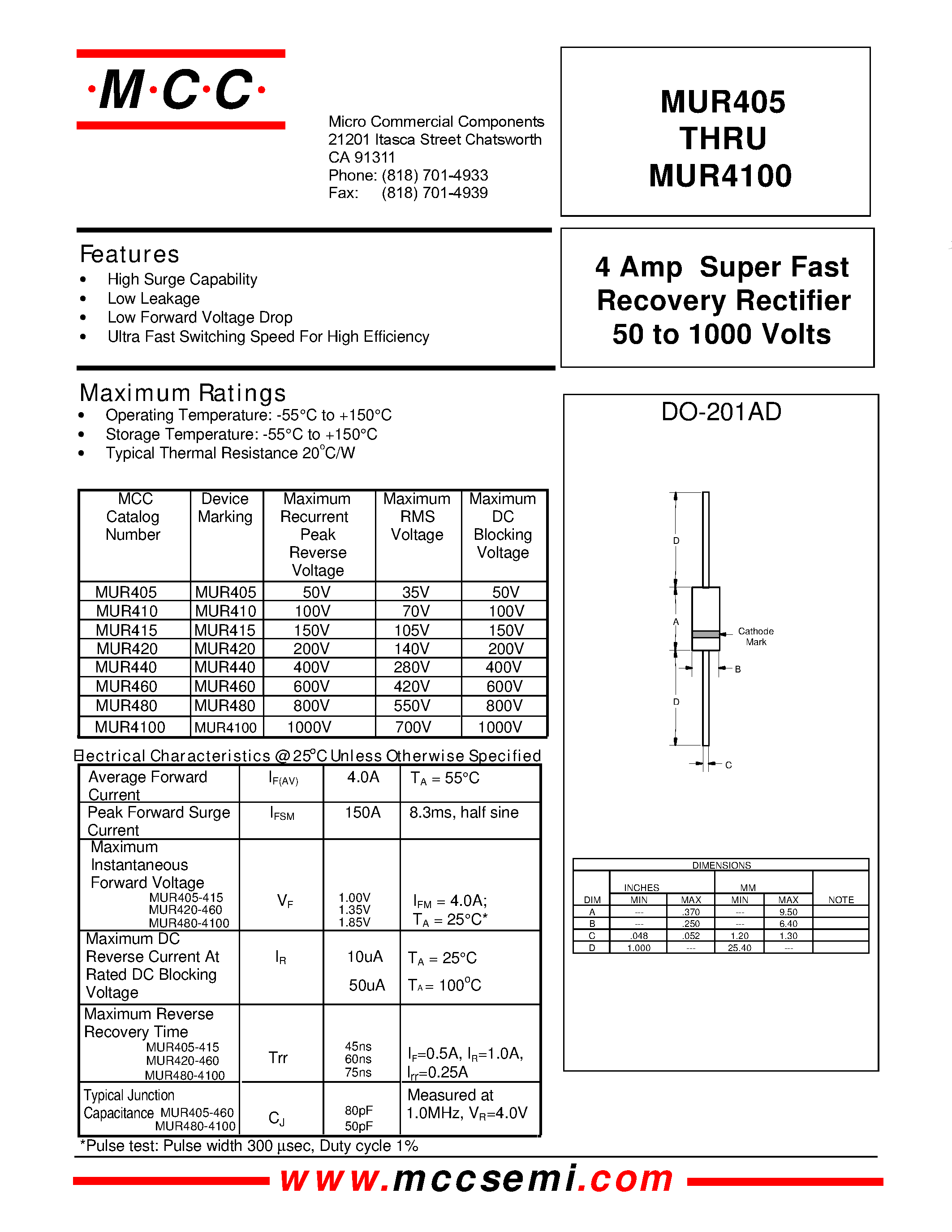

Description:(MUR405 - MUR4100) 4 Amp Super Fast Recovery Rectifier 50 to 1000 Volts

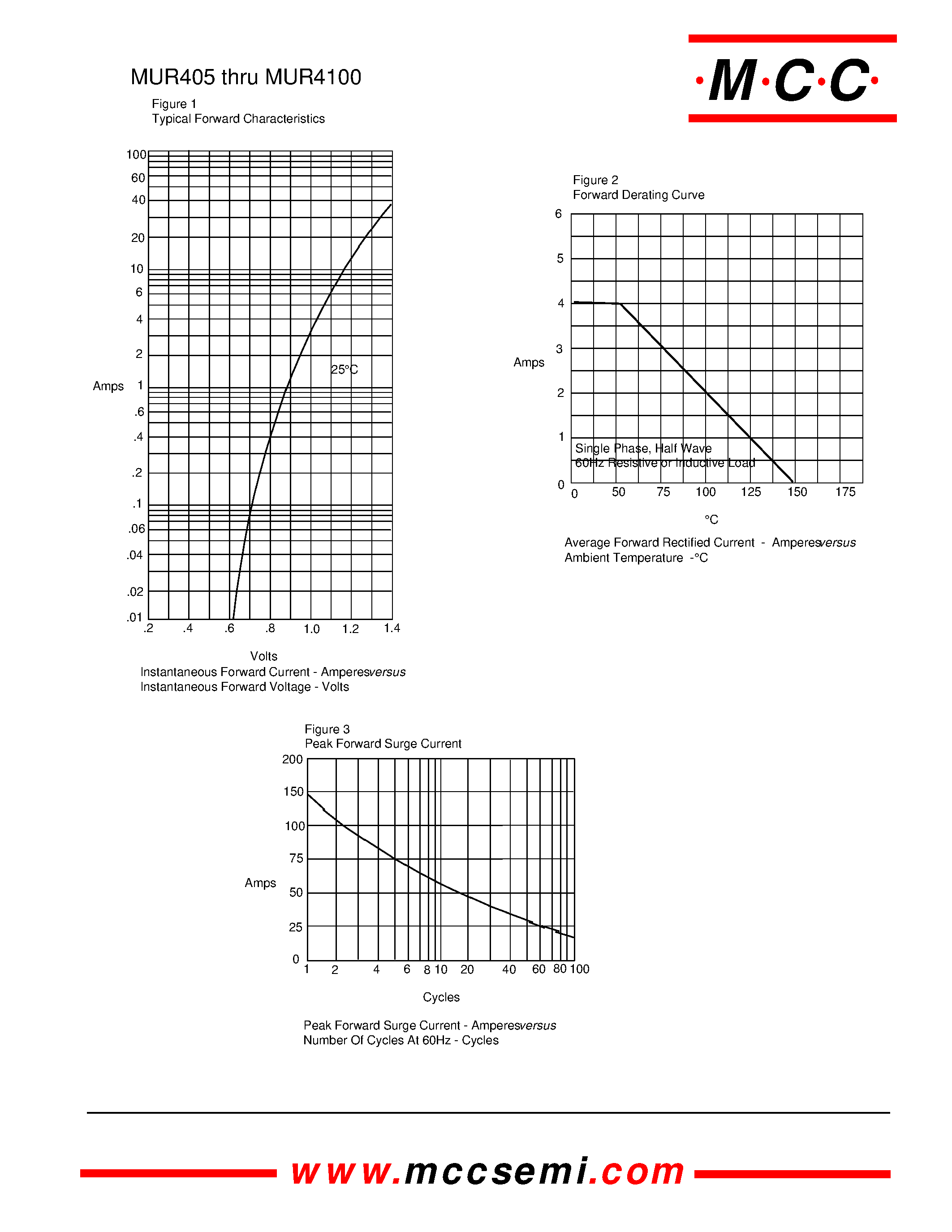

Datasheet MUR405 - (MUR405 - MUR4100) 4 Amp Super Fast Recovery Rectifier 50 to 1000 Volts page 1
Datasheet MUR405 - (MUR405 - MUR4100) 4 Amp Super Fast Recovery Rectifier 50 to 1000 Volts page 2
