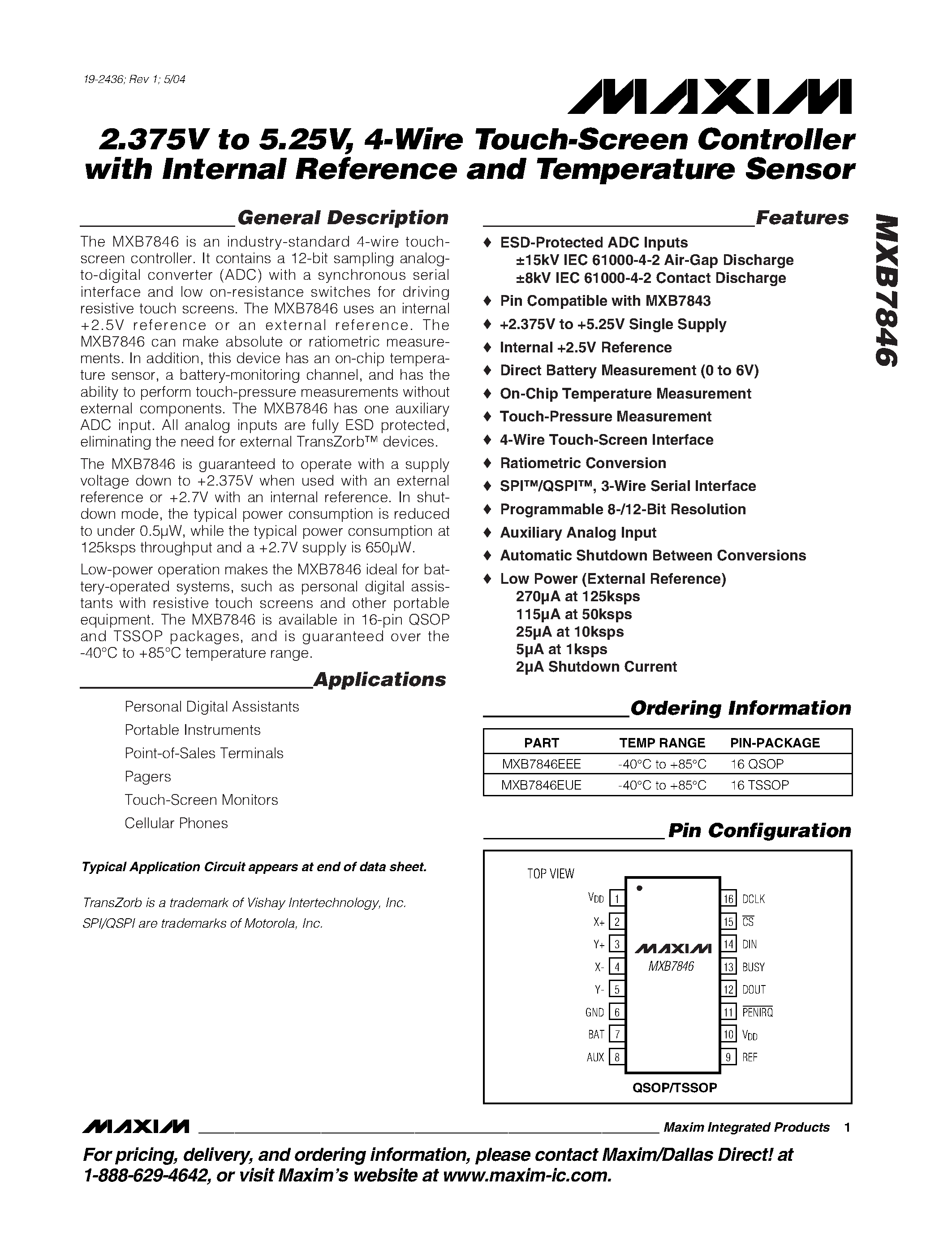

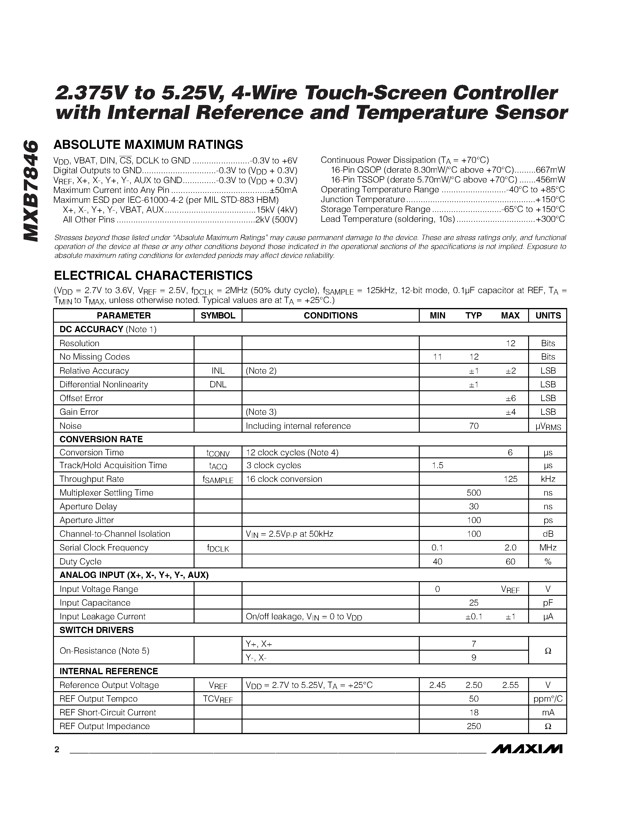

MXB7846-2.375V to 5.25V / 4-Wire Touch-Screen Controller with Internal Reference and Temperature Sensor
Producer:Maxim
Description:2.375V to 5.25V / 4-Wire Touch-Screen Controller with Internal Reference and Temperature Sensor
