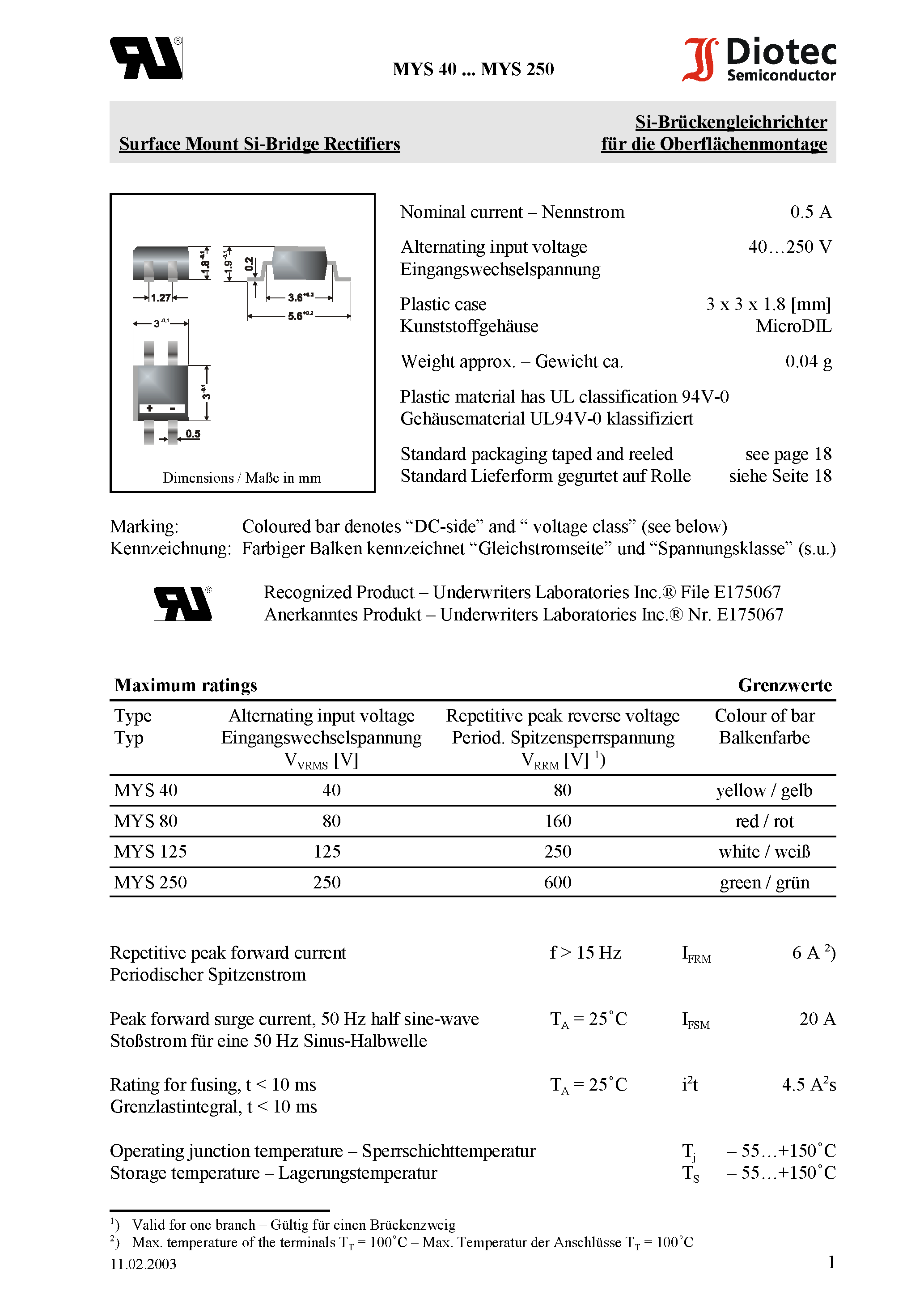

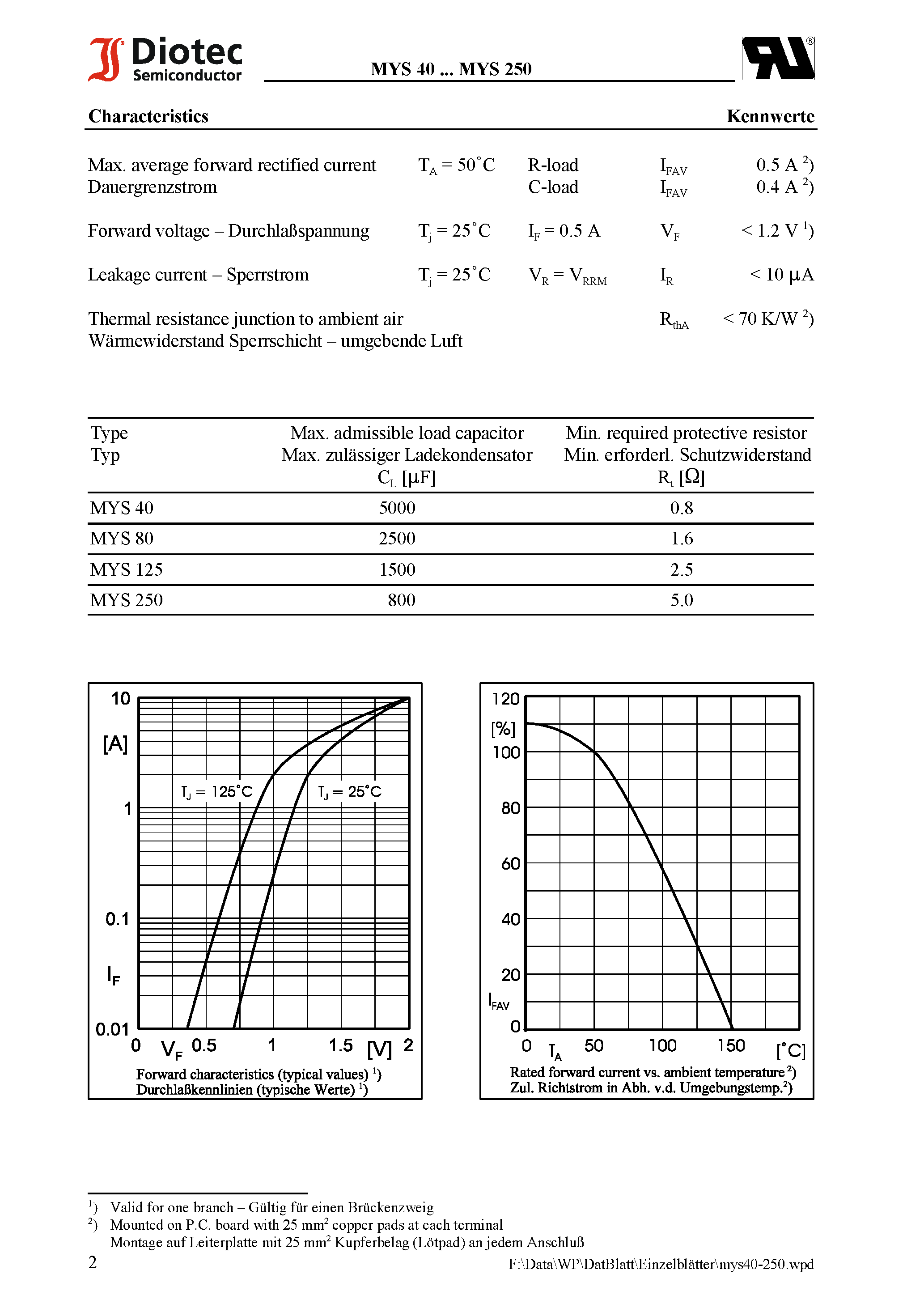

MYS125-Surface Mount Si-Bridge Rectifiers
Producer:Diotec
Description:Surface Mount Si-Bridge Rectifiers
Others with the same file: MYS125
Datasheet MYS125 - Surface Mount Si-Bridge Rectifiers page 1
Datasheet MYS125 - Surface Mount Si-Bridge Rectifiers page 2
