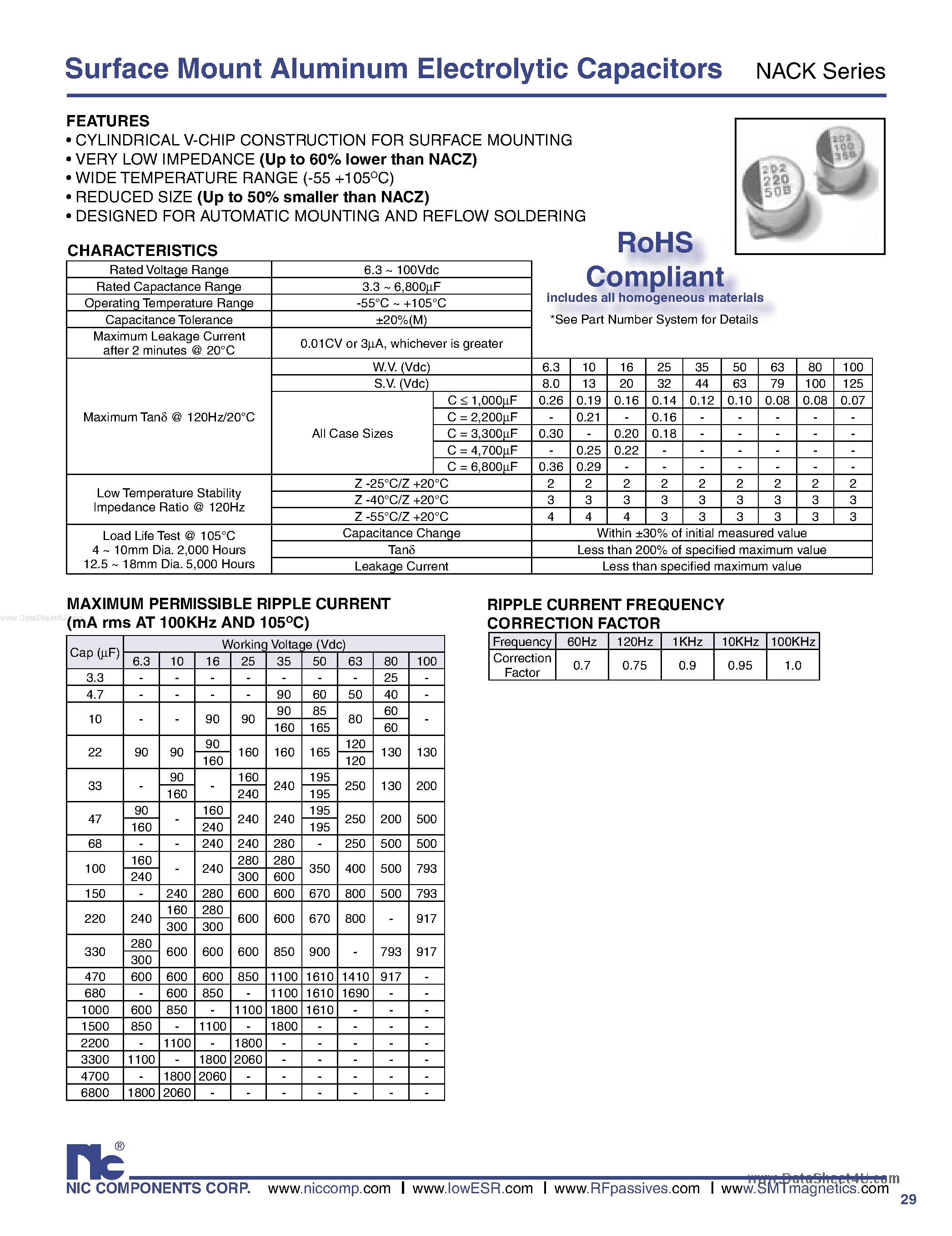

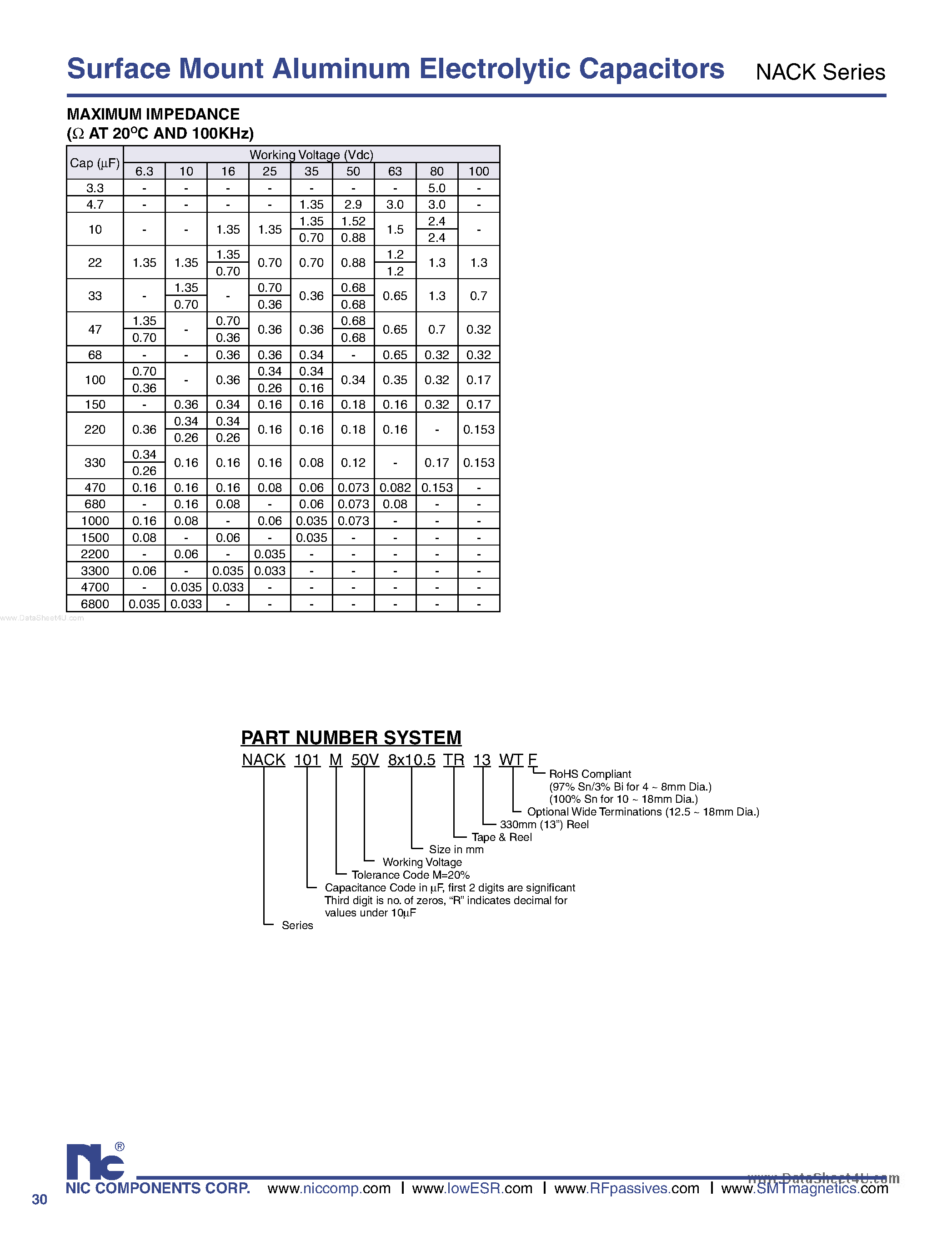

NACK-(NACK Series) Surface Mount Aluminum Electrolytic Capacitors
Producer:NIC Components
Description:(NACK Series) Surface Mount Aluminum Electrolytic Capacitors
Others with the same file: NACK | NACK1000M
NACK100M | NACK10M
NACK1500M | NACK150M
NACK2200M | NACK220M
NACK22M | NACK3.3M
NACK3300M | NACK330M
NACK33M | NACK4.7M
NACK4700M | NACK470M
NACK47M | NACK6800M
NACK680M | NACK68M
Datasheet NACK - (NACK Series) Surface Mount Aluminum Electrolytic Capacitors page 1
Datasheet NACK - (NACK Series) Surface Mount Aluminum Electrolytic Capacitors page 2
