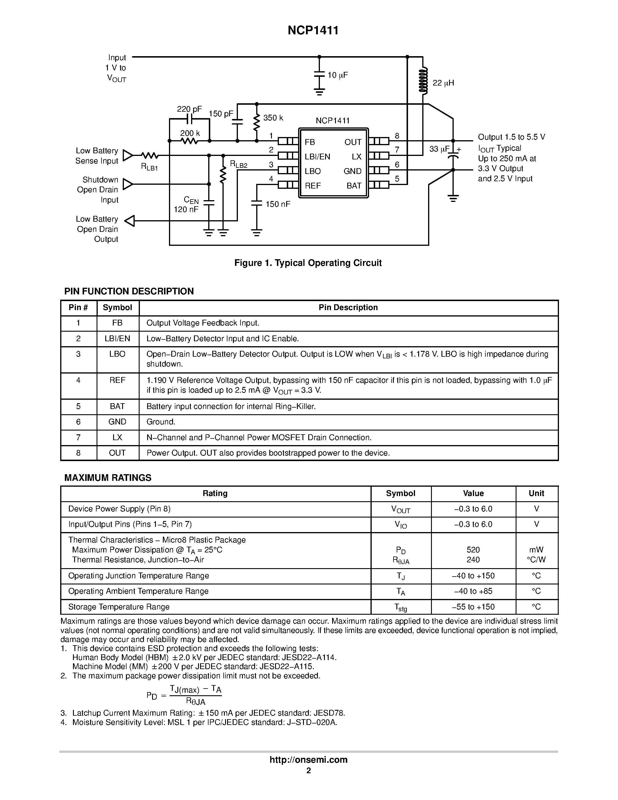

NCP1411-Sync-Rect PFM Step-Up DC-DC Converter with Low-Battery Detector and Ring-Killer
Producer:ON
Description:Sync-Rect PFM Step-Up DC-DC Converter with Low-Battery Detector and Ring-Killer
