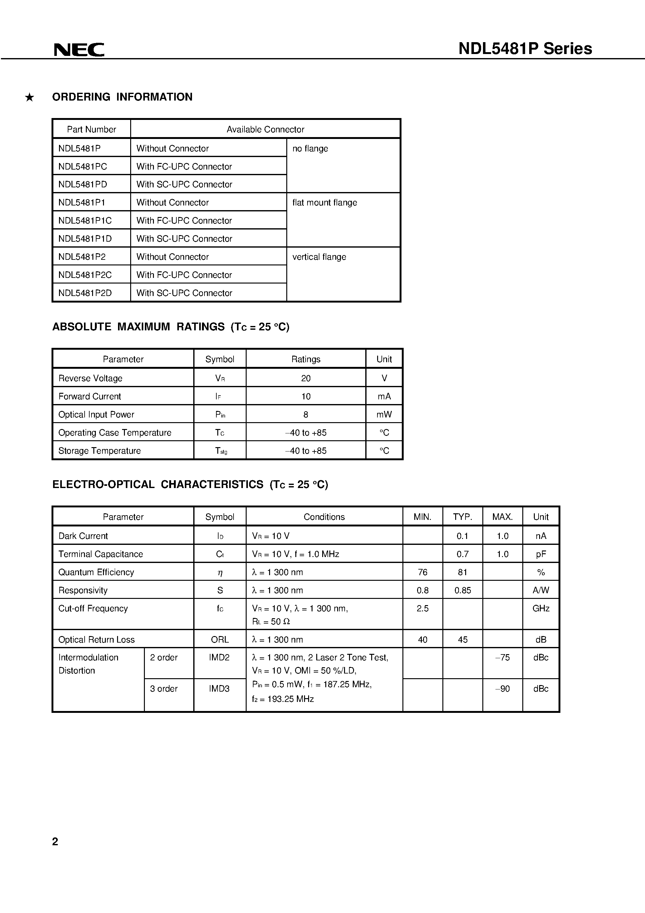

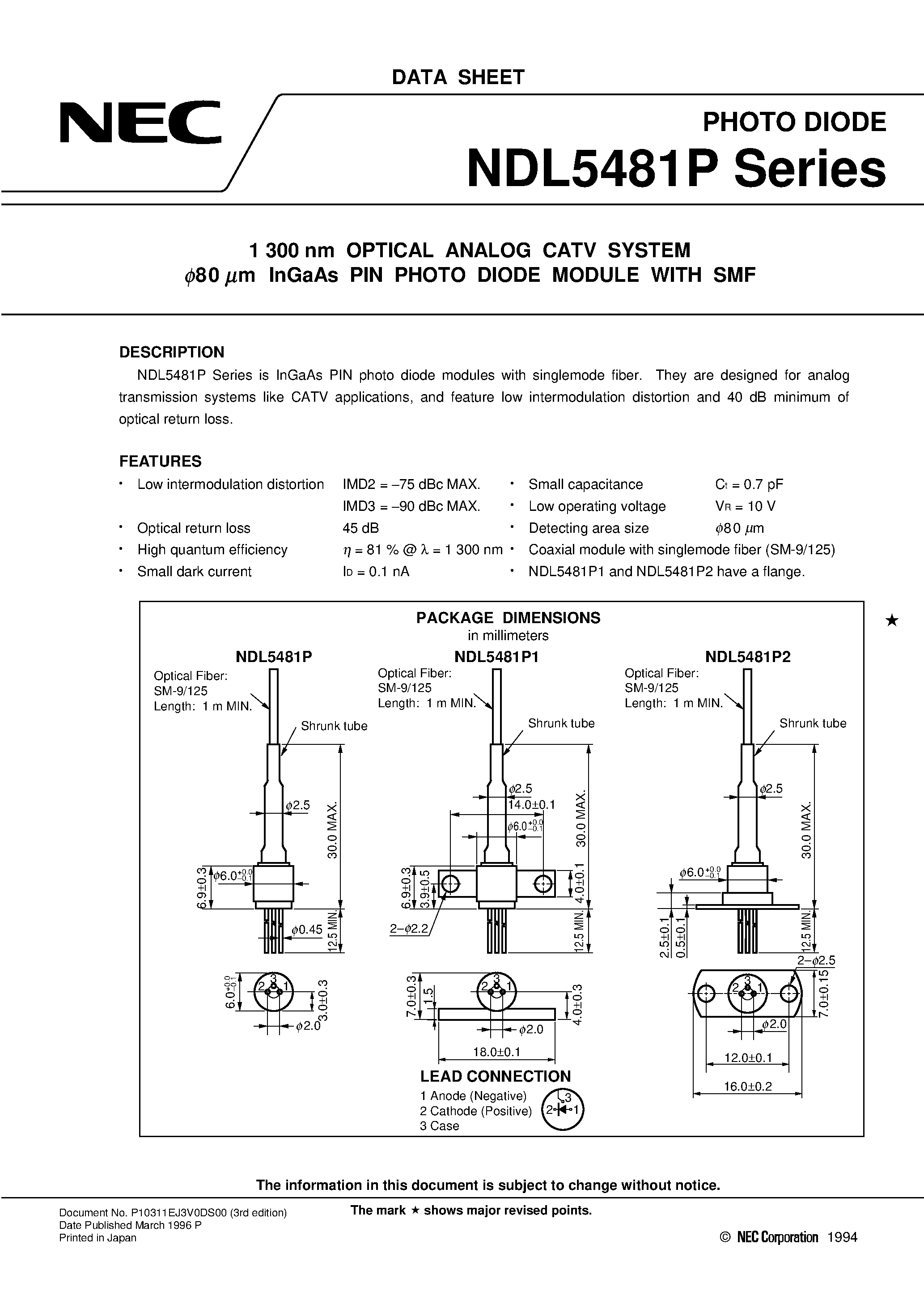

NDL5481P1D-1 300 nm OPTICAL ANALOG CATV SYSTEM 80 mm InGaAs PIN PHOTO DIODE MODULE WITH SMF
Producer:NEC
Description:1 300 nm OPTICAL ANALOG CATV SYSTEM 80 mm InGaAs PIN PHOTO DIODE MODULE WITH SMF
Others with the same file: NDL5481P1D
Datasheet NDL5481P1D - 1 300 nm OPTICAL ANALOG CATV SYSTEM 80 mm InGaAs PIN PHOTO DIODE MODULE WITH SMF page 1
Datasheet NDL5481P1D - 1 300 nm OPTICAL ANALOG CATV SYSTEM 80 mm InGaAs PIN PHOTO DIODE MODULE WITH SMF page 2
