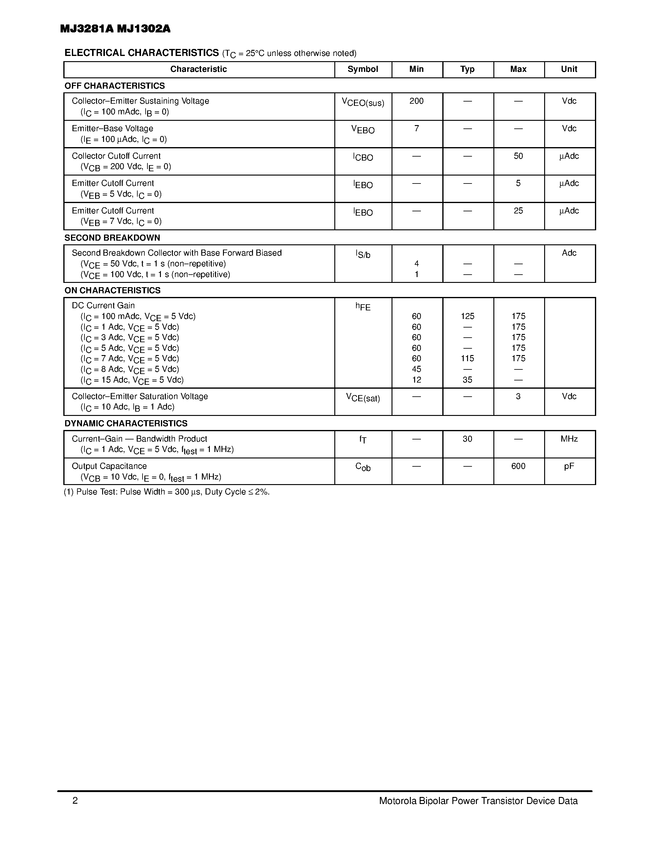

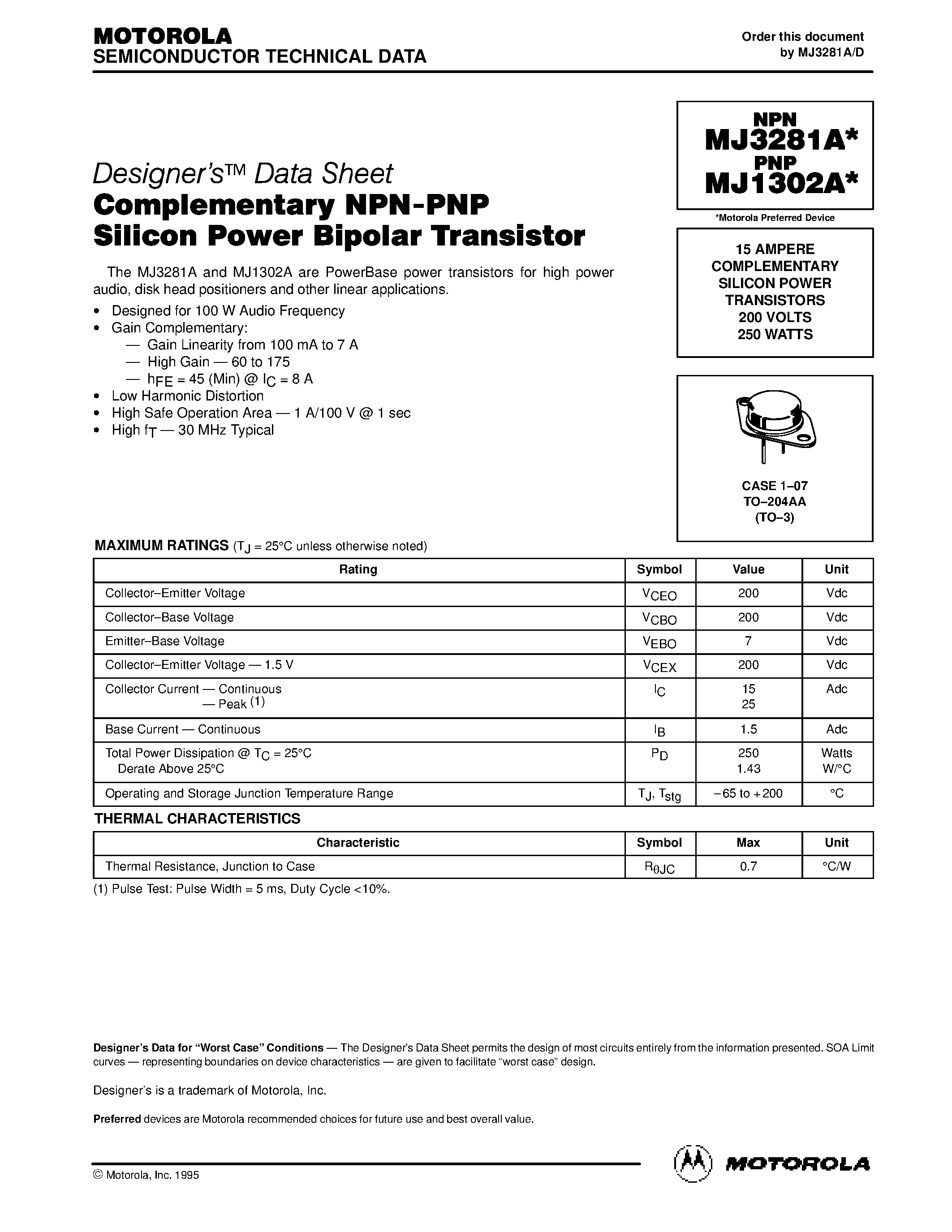

NH1302A-15 AMPERE COMPLEMENTARY SILICON POWER TRANSISTORS 200 VOLTS 250 WATTS
Producer:Motorola Inc
Description:15 AMPERE COMPLEMENTARY SILICON POWER TRANSISTORS 200 VOLTS 250 WATTS
Others with the same file: NH1302A
Datasheet NH1302A - 15 AMPERE COMPLEMENTARY SILICON POWER TRANSISTORS 200 VOLTS 250 WATTS page 1
Datasheet NH1302A - 15 AMPERE COMPLEMENTARY SILICON POWER TRANSISTORS 200 VOLTS 250 WATTS page 2
