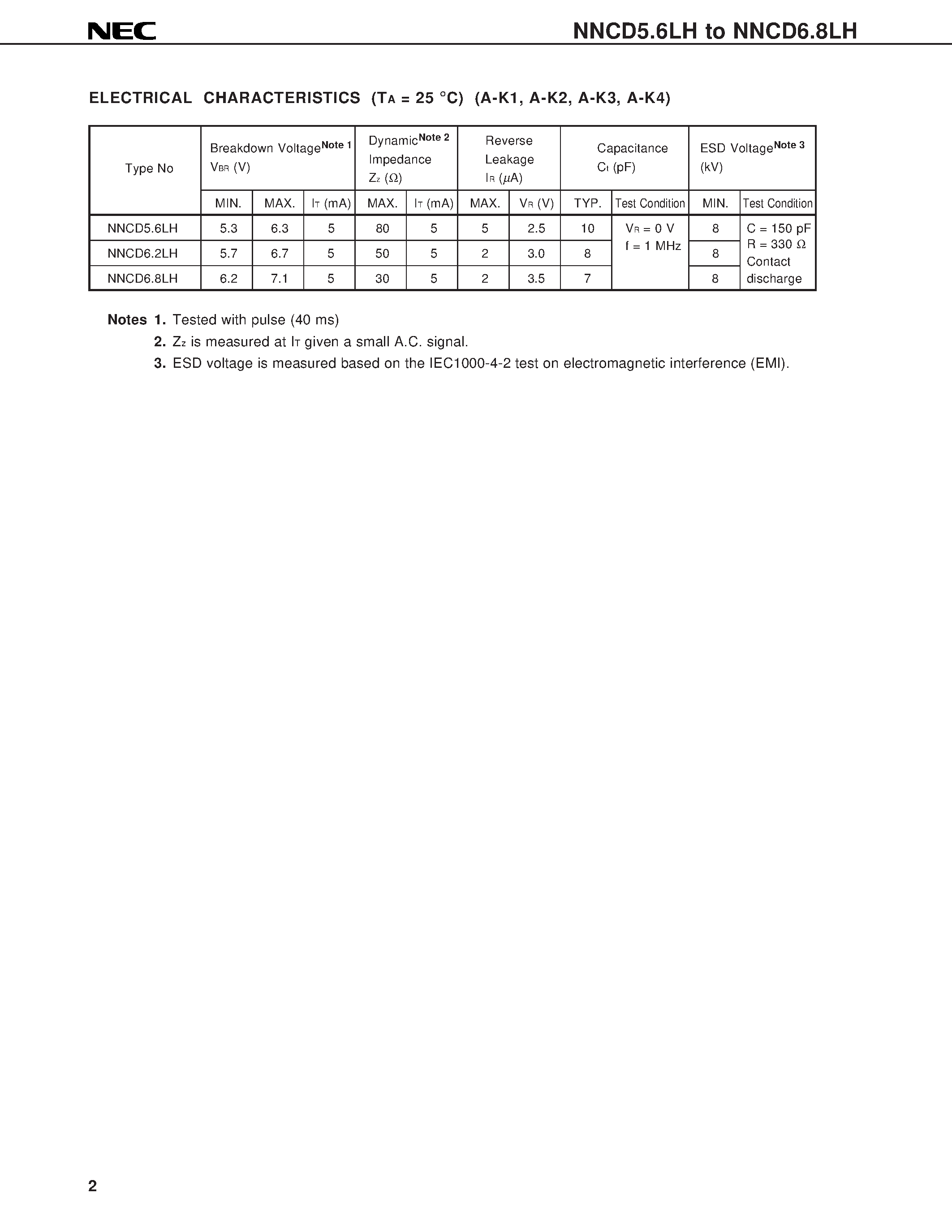

NNCD5.6LH-LOW CAPACITANCE TYPE ELECTROSTATIC DISCHARGE NOISE CLIPPING DIODES QUARTO TYPE: COMMON ANODE 5-PIN SUPER SMALL MINI MOLD
Producer:NEC
Description:LOW CAPACITANCE TYPE ELECTROSTATIC DISCHARGE NOISE CLIPPING DIODES QUARTO TYPE: COMMON ANODE 5-PIN SUPER SMALL MINI MOLD
Others with the same file: NNCD5.6LH
