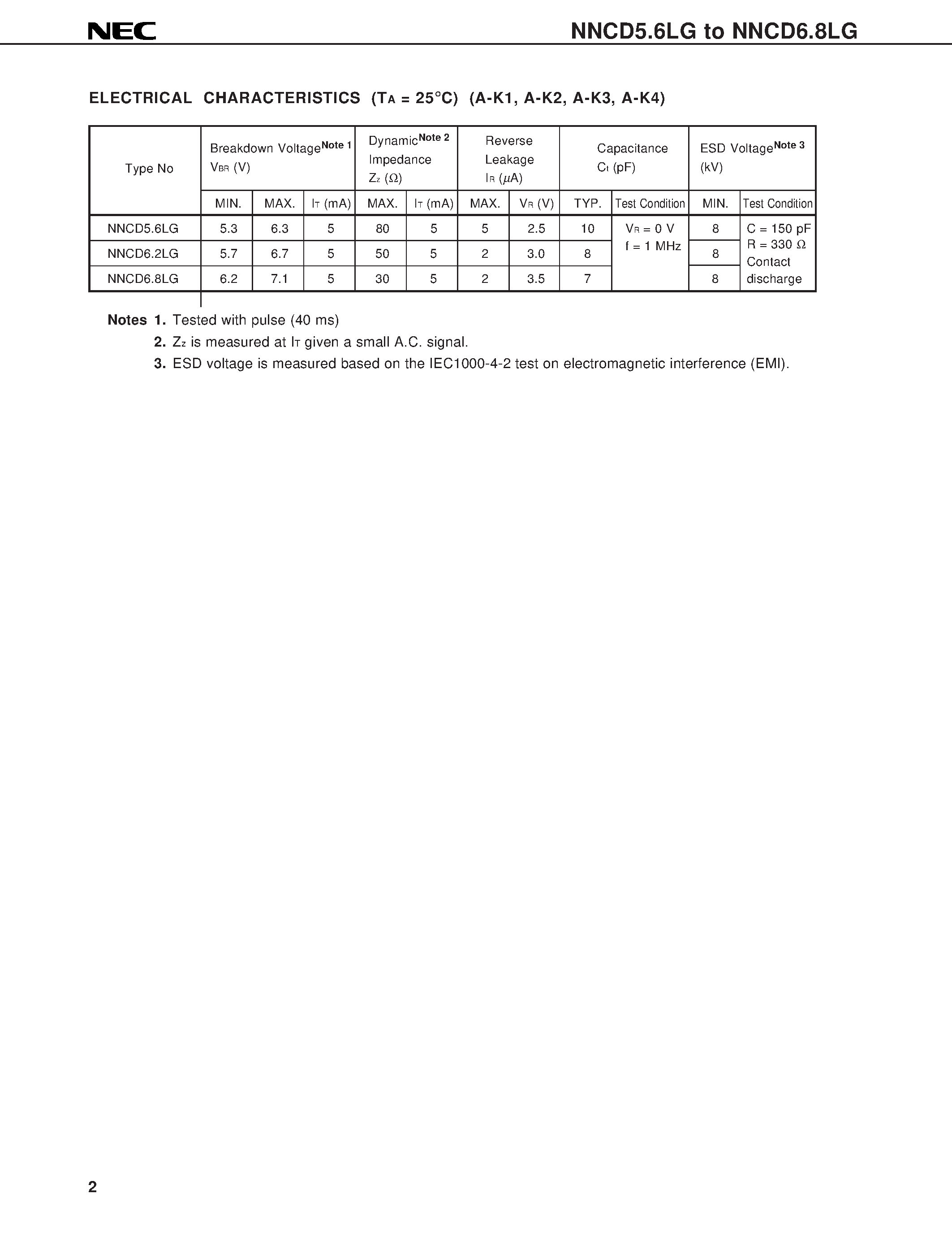

Datasheet NNCD6.2LG - LOW CAPACITANCE TYPE ELECTROSTATIC DISCHARGE NOISE CLIPPING DIODES QUARTO TYPE: COMMON ANODE 5-PIN MINI MOLD page 2
