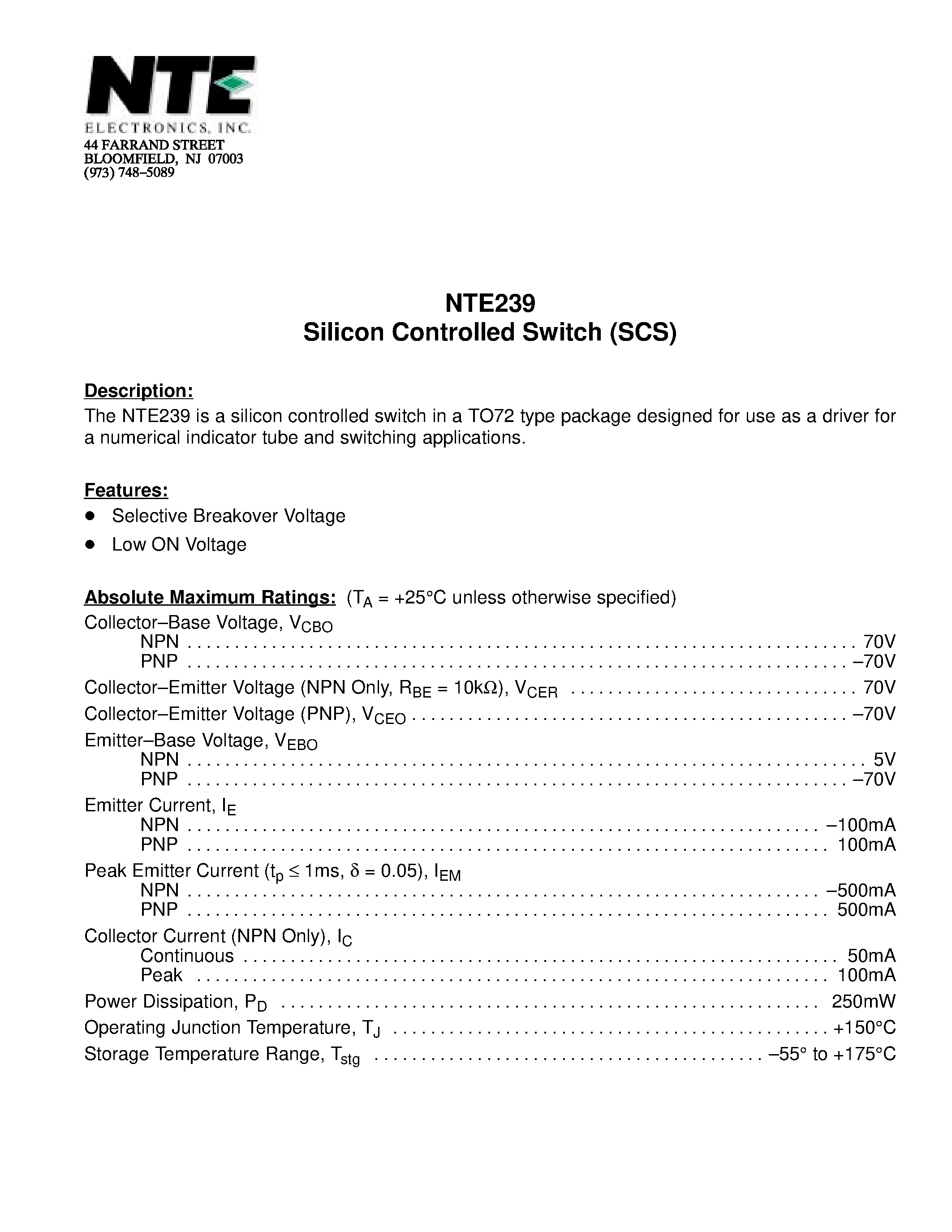

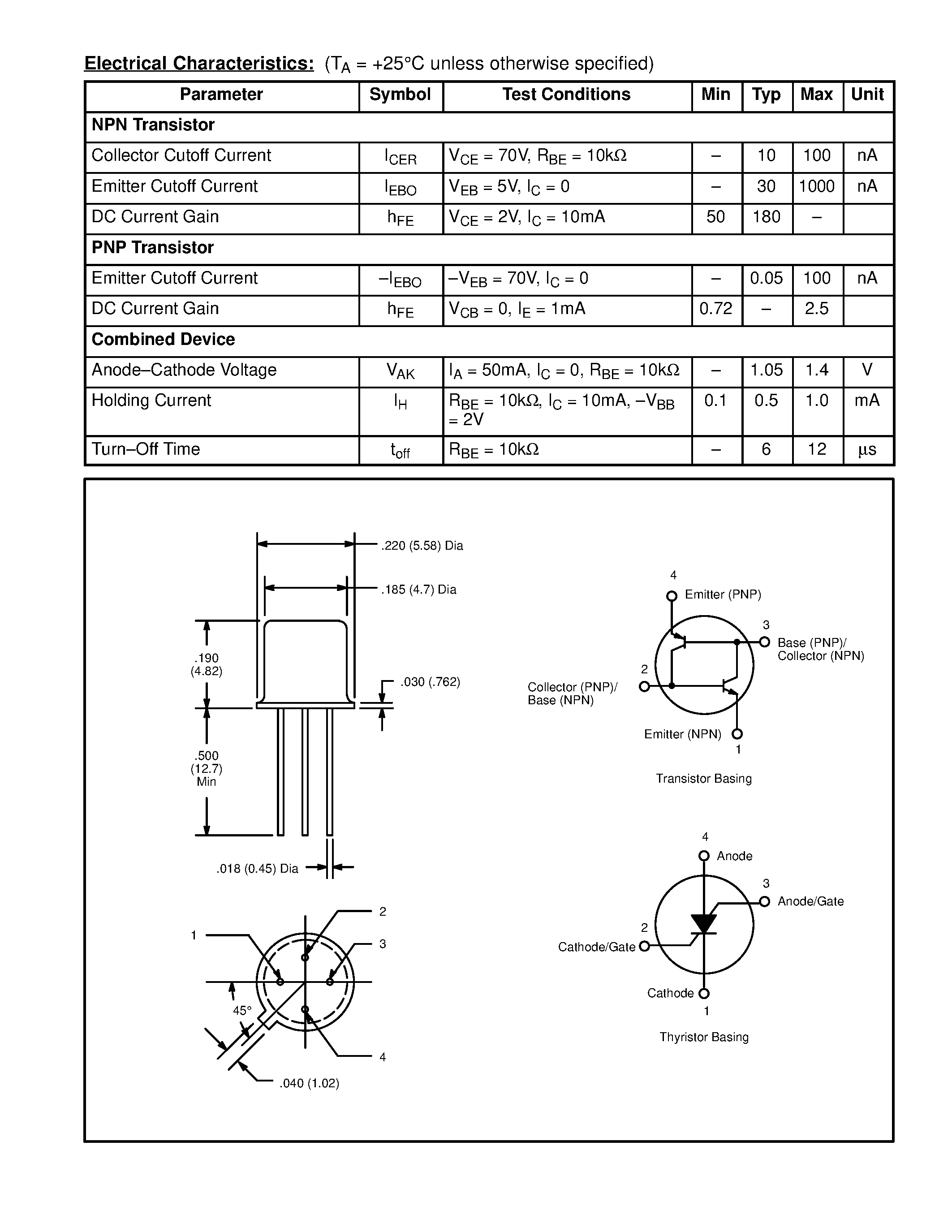

NTE239-Silicon Controlled Switch (SCS)
Producer:NTE
Description:Silicon Controlled Switch (SCS)
Others with the same file: NTE239
Datasheet NTE239 - Silicon Controlled Switch (SCS) page 1
Datasheet NTE239 - Silicon Controlled Switch (SCS) page 2
