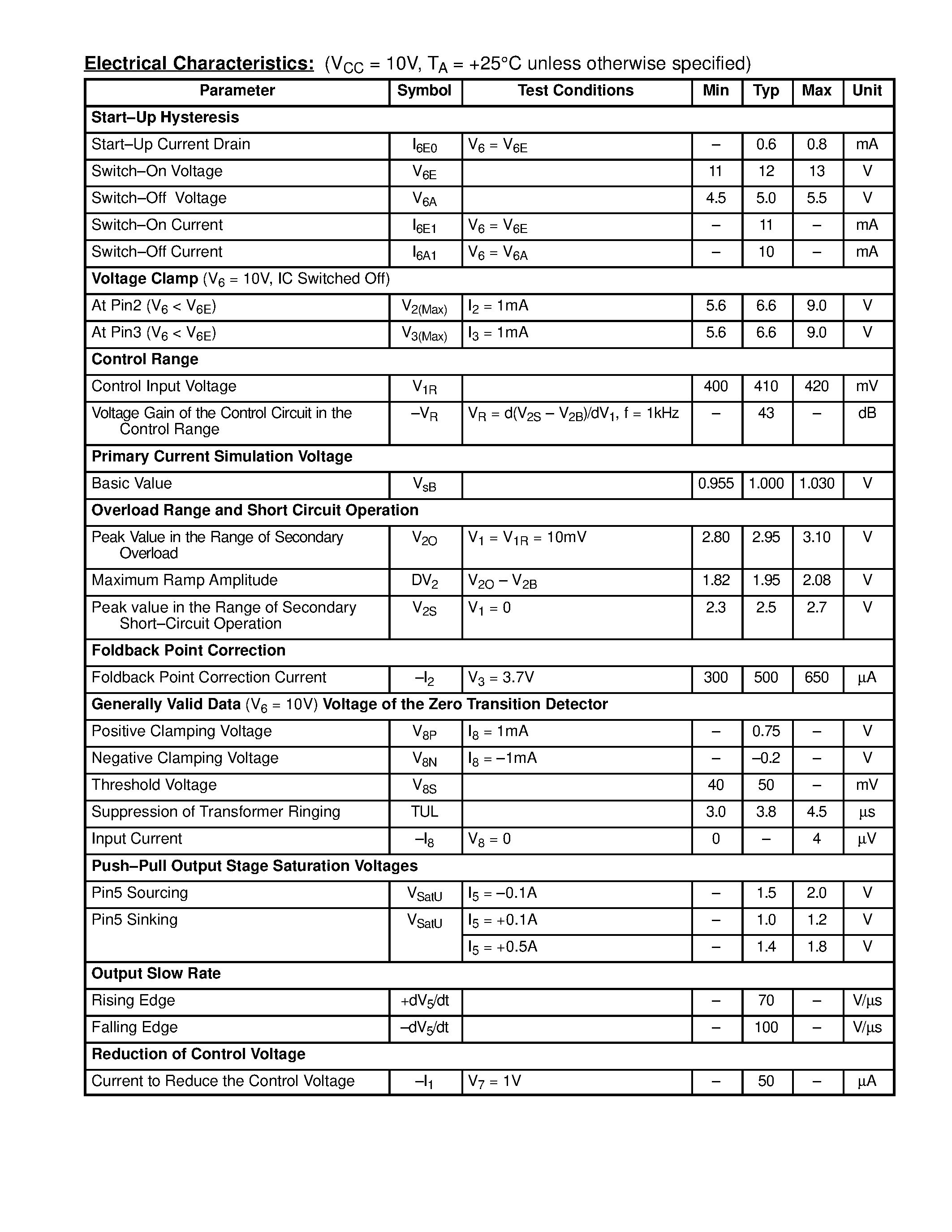

NTE7154-Integrated Circuit Control Circuit for Switch Mode Power Supplies using MOS Transistors
Producer:NTE Electronics
Description:Integrated Circuit Control Circuit for Switch Mode Power Supplies using MOS Transistors
