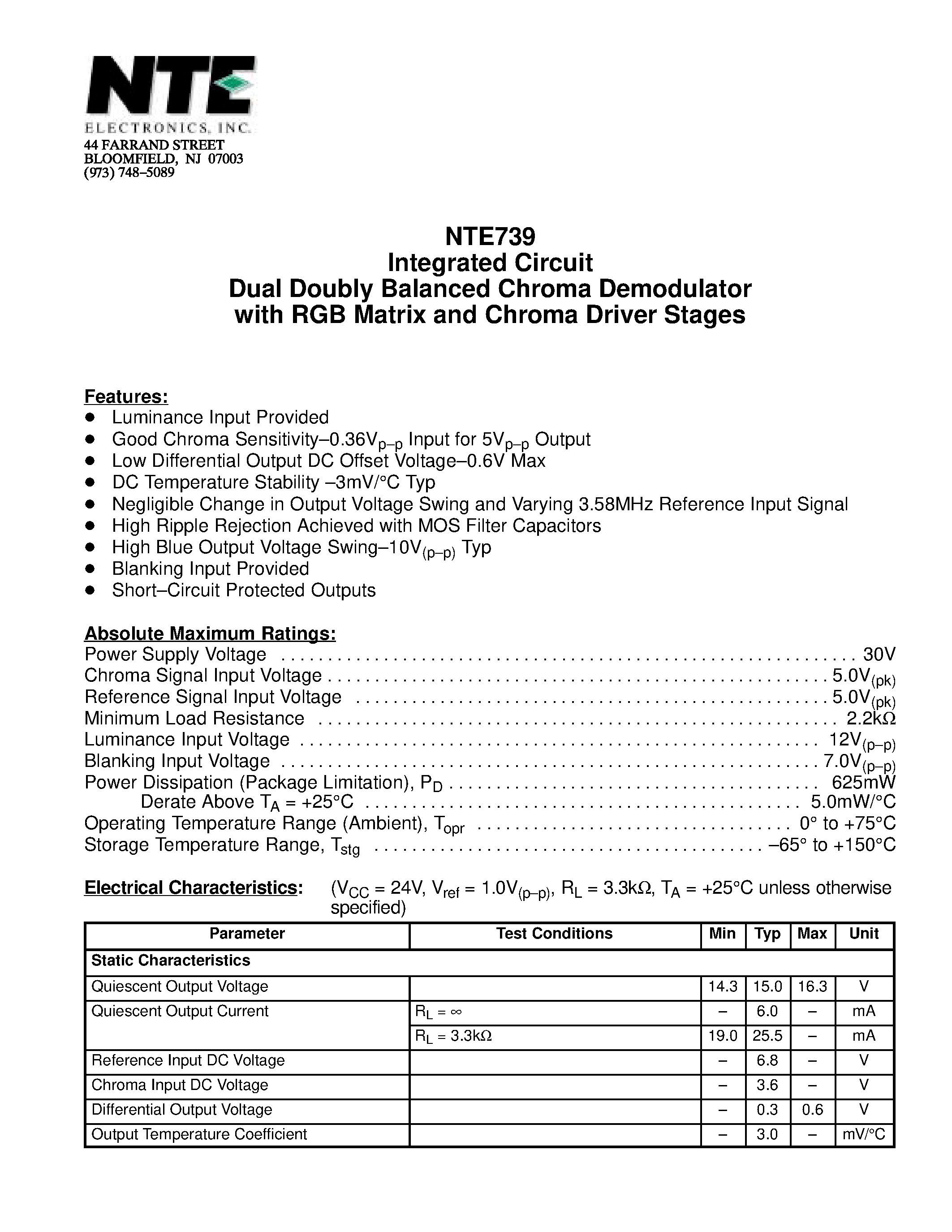

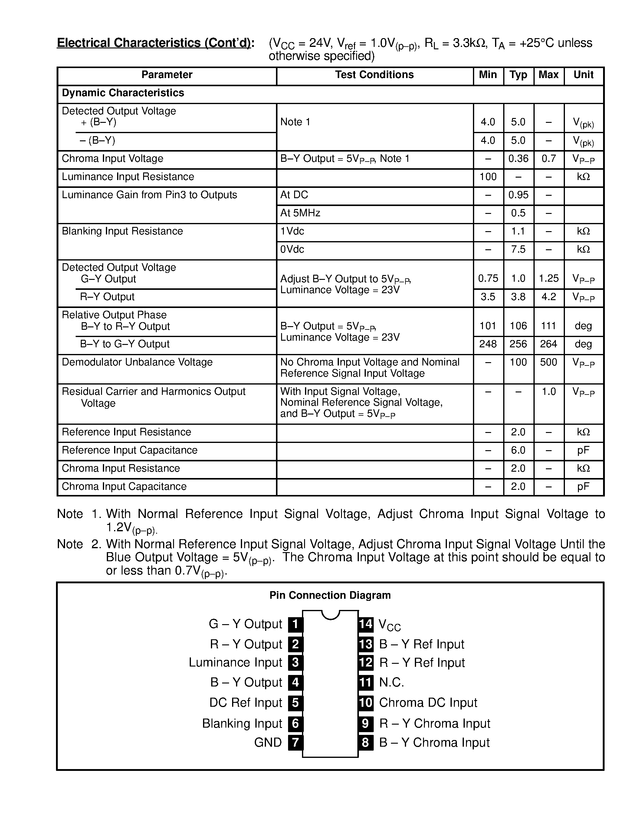

NTE739-Integrated Circuit Dual Doubly Balanced Chroma Demodulator with RGB Matrix and Chroma Driver Stages
Producer:NTE Electronics
Description:Integrated Circuit Dual Doubly Balanced Chroma Demodulator with RGB Matrix and Chroma Driver Stages
