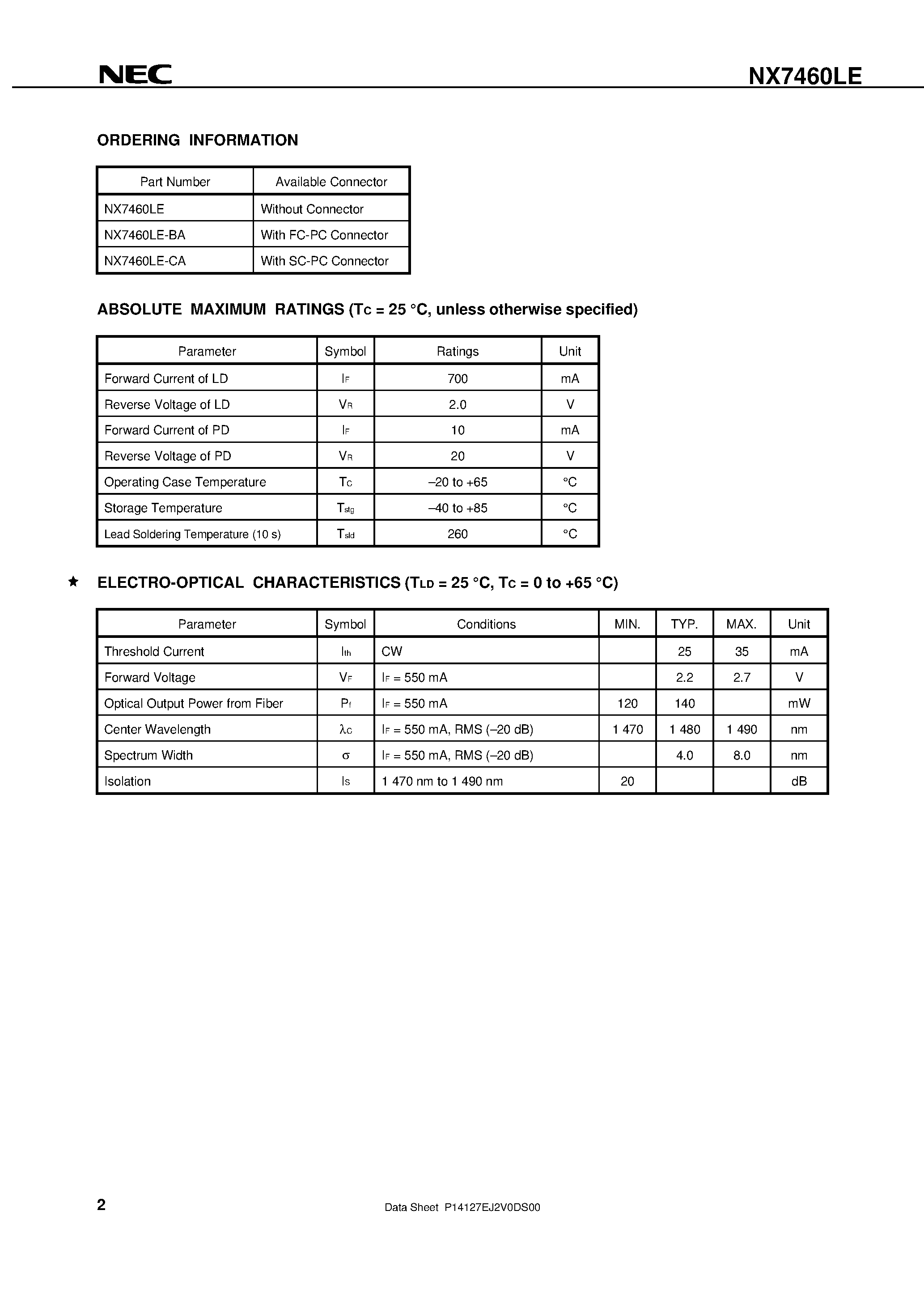

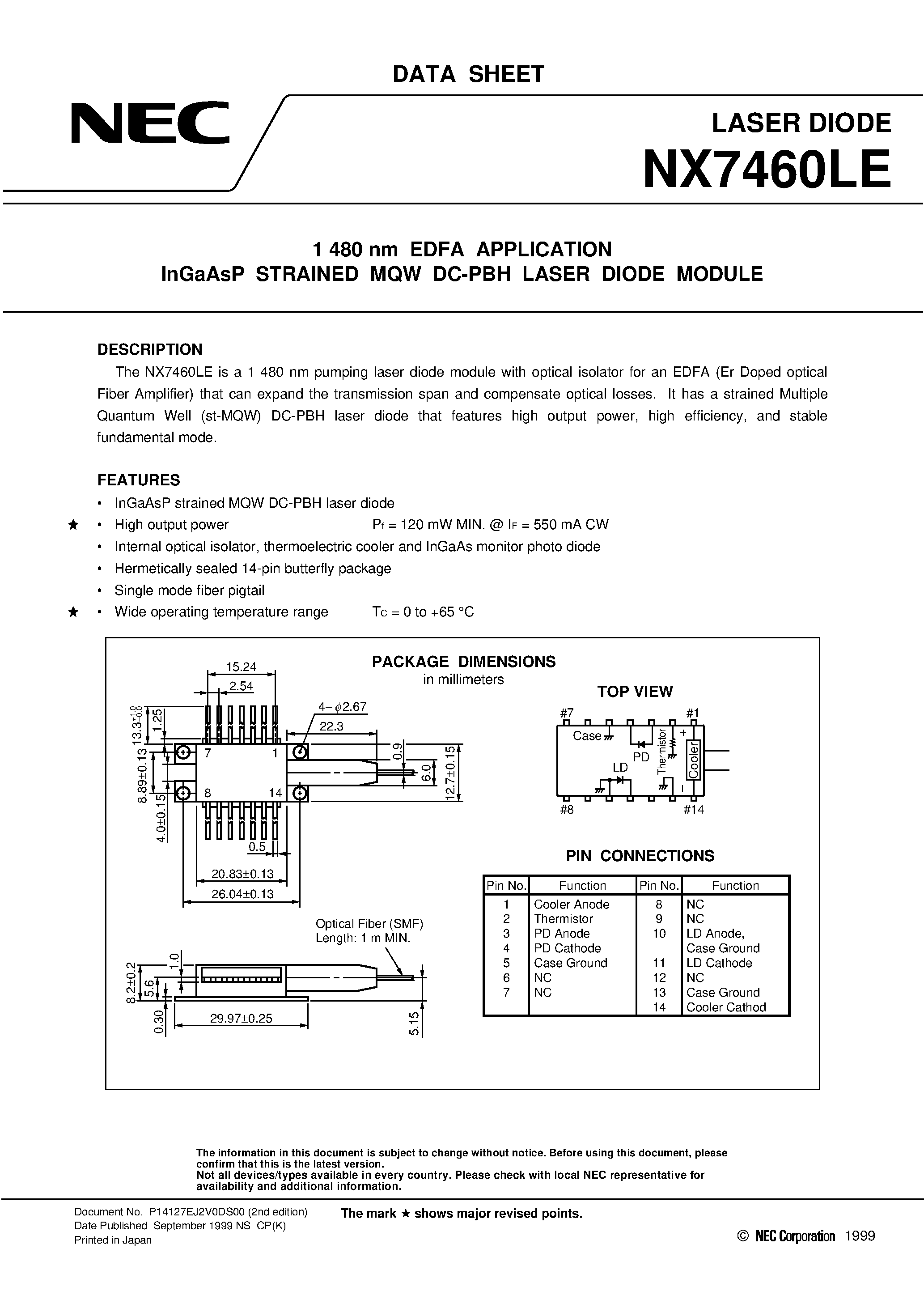

NX7460LE-1 510 nm OPTICAL FIBER COMMUNICATIONS InGaAsP STRAINED MQW DC-PBH LASER DIODE MODULE
Producer:NEC
Description:1 510 nm OPTICAL FIBER COMMUNICATIONS InGaAsP STRAINED MQW DC-PBH LASER DIODE MODULE
Others with the same file: NX7460LE
Datasheet NX7460LE - 1 510 nm OPTICAL FIBER COMMUNICATIONS InGaAsP STRAINED MQW DC-PBH LASER DIODE MODULE page 1
Datasheet NX7460LE - 1 510 nm OPTICAL FIBER COMMUNICATIONS InGaAsP STRAINED MQW DC-PBH LASER DIODE MODULE page 2
