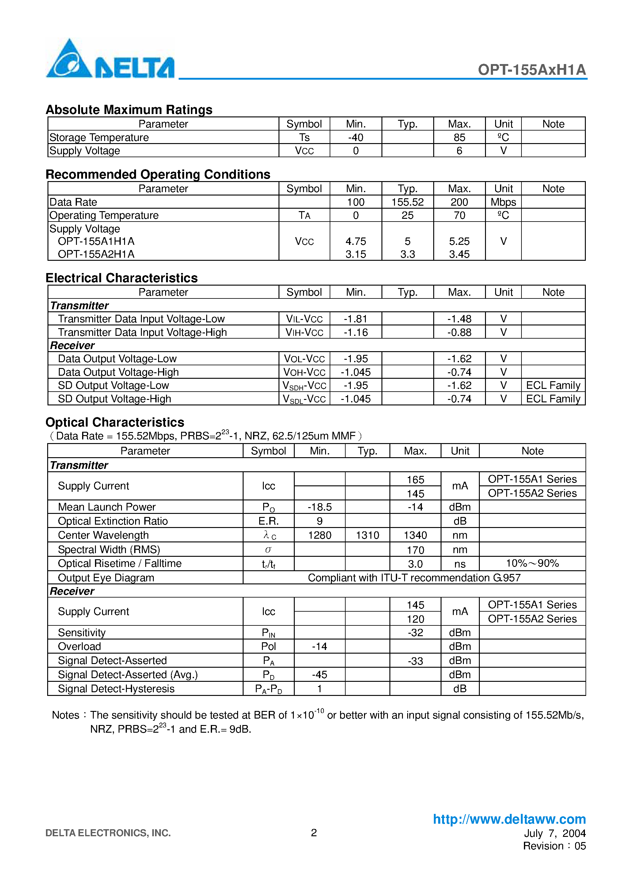

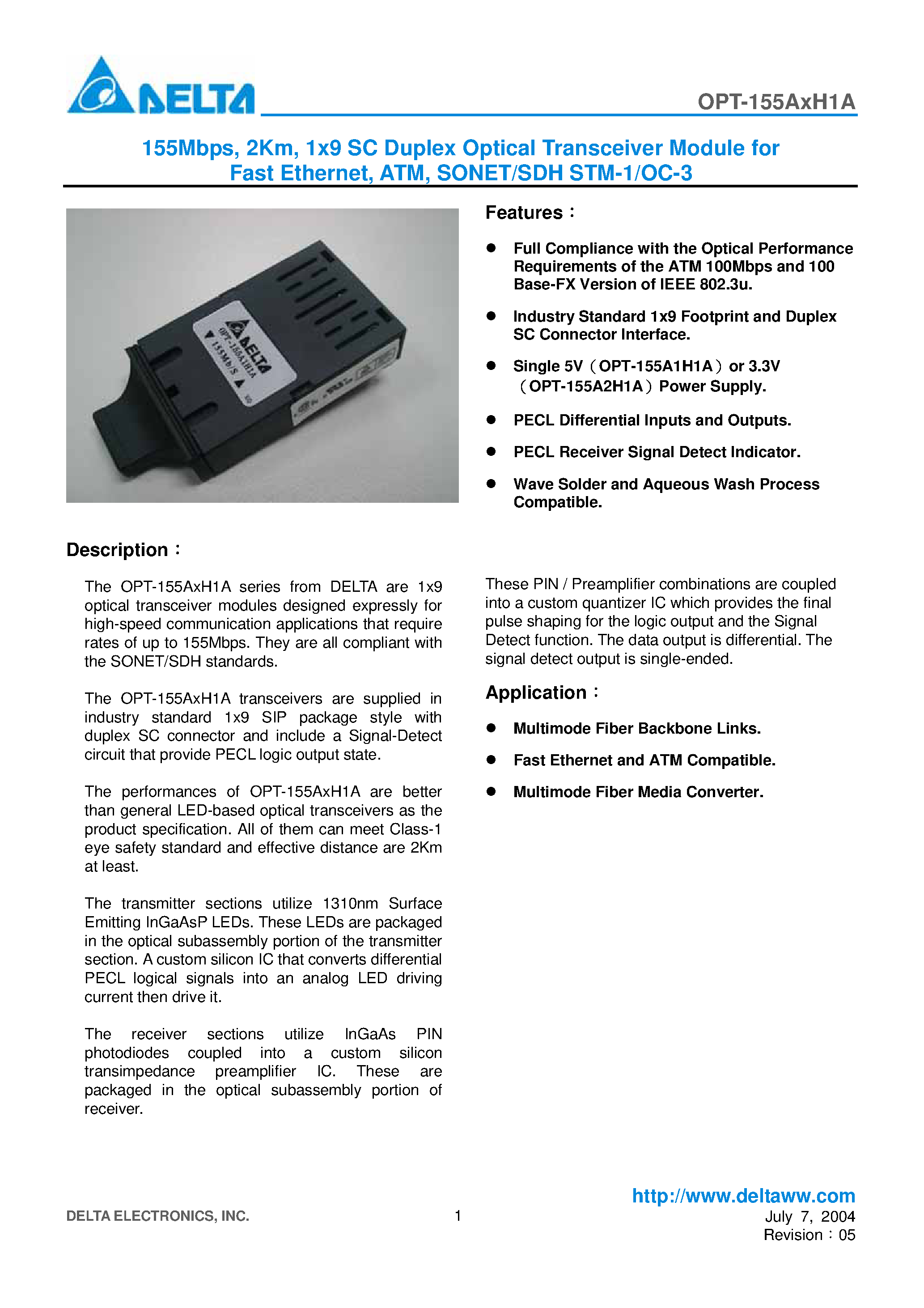

OPT-155A2H1-155Mbps / 2Km / 1x9 SC Duplex Optical Transceiver Module for Fast Ethernet / ATM / SONET/SDH STM-1/OC-3
Producer:ETC
Description:155Mbps / 2Km / 1x9 SC Duplex Optical Transceiver Module for Fast Ethernet / ATM / SONET/SDH STM-1/OC-3
