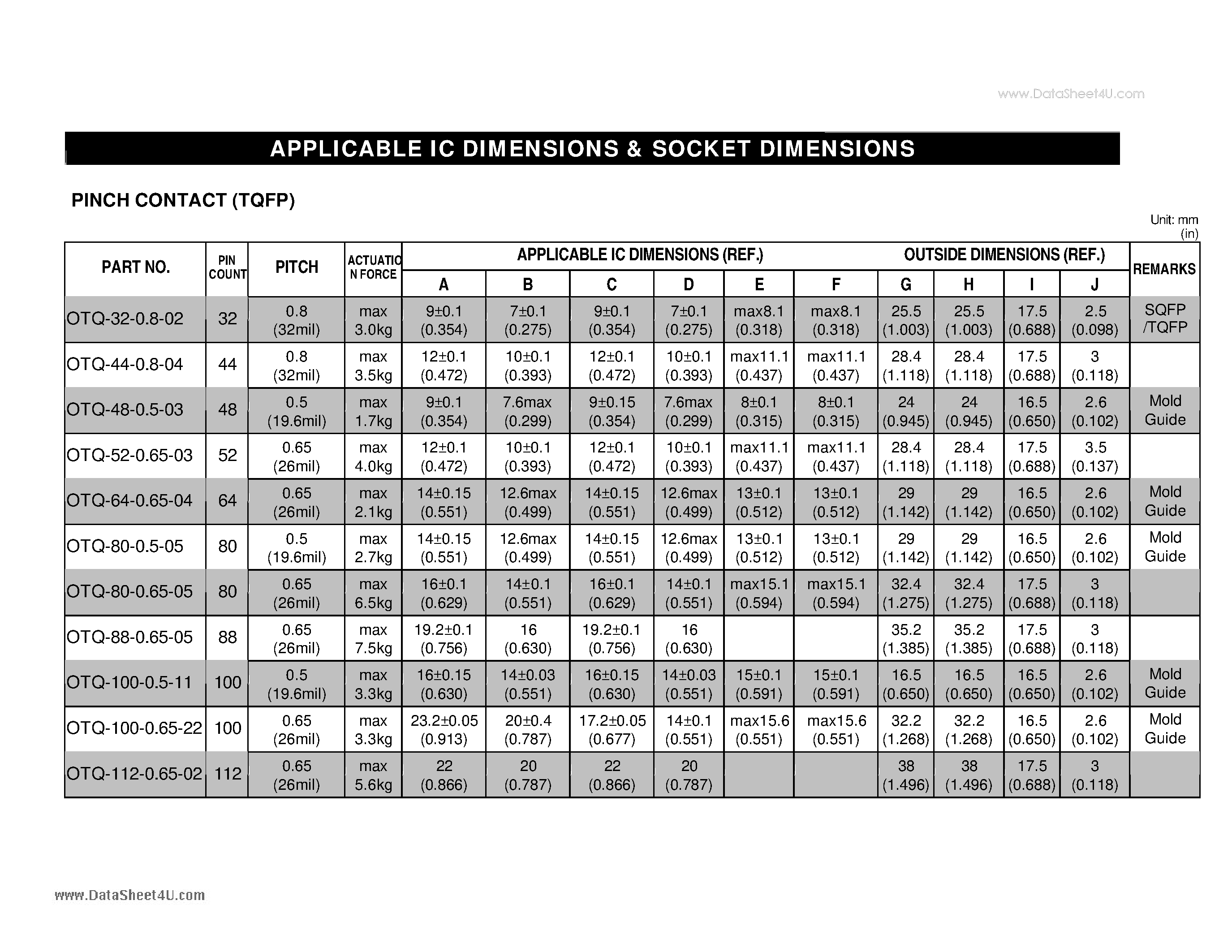

Datasheet OTQ - OPEN TOP TYPE SOCKETS page 1

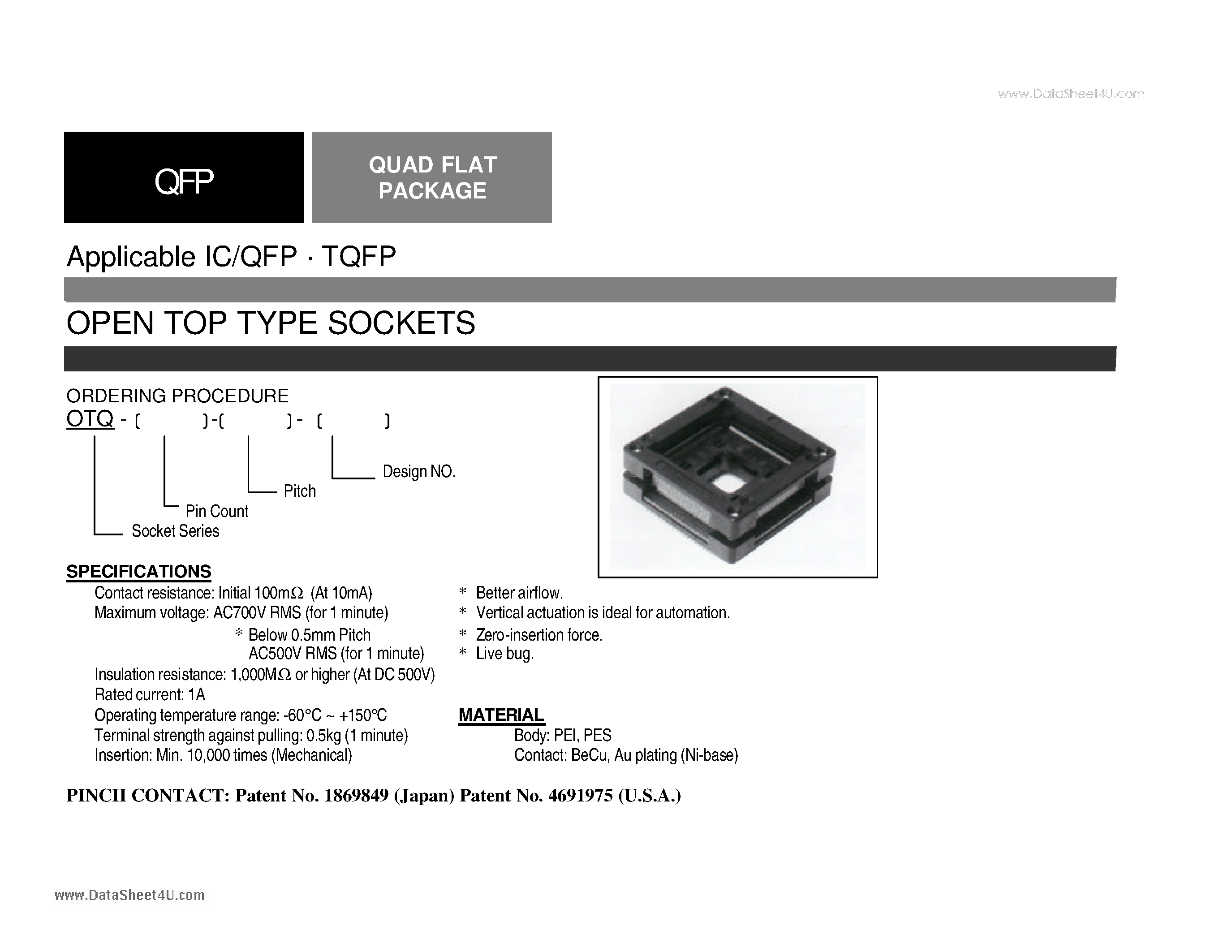

Datasheet OTQ - OPEN TOP TYPE SOCKETS page 2
