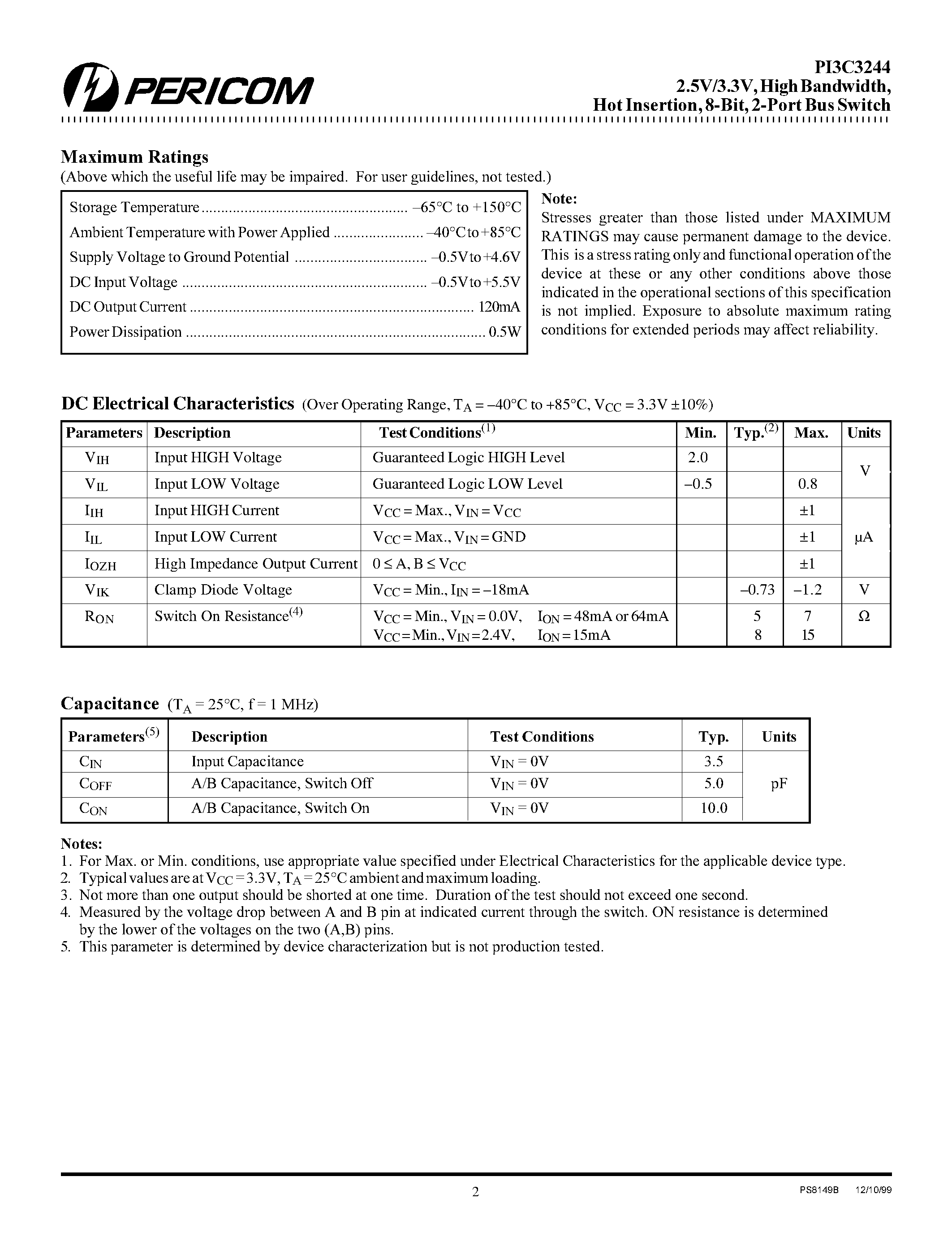

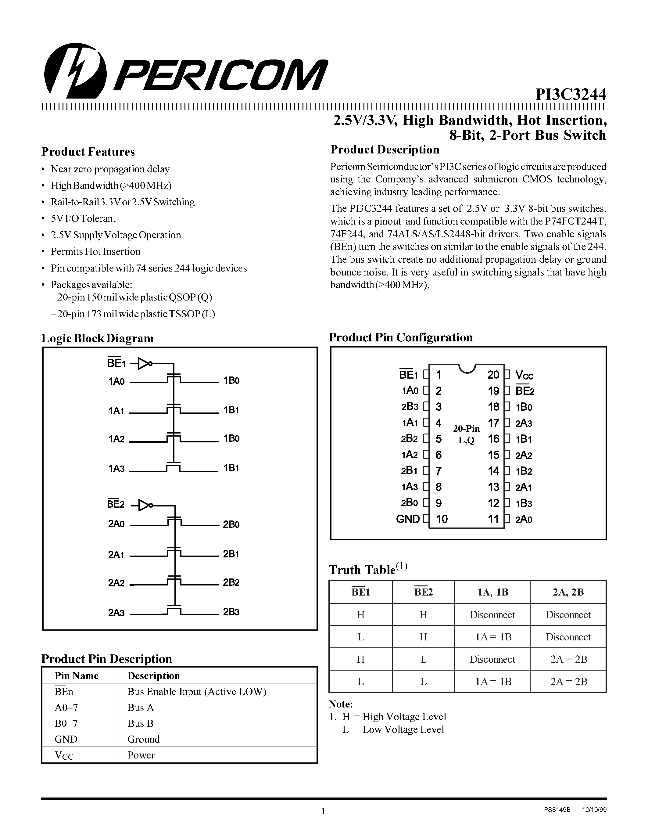

P13C3244L-2.5V/3.3V / High Bandwidth / Hot Insertion / 8-Bit / 2-Port Bus Switch
Producer:Pericom Semiconductor Corporation
Description:2.5V/3.3V / High Bandwidth / Hot Insertion / 8-Bit / 2-Port Bus Switch
Others with the same file: P13C3244L
Datasheet P13C3244L - 2.5V/3.3V / High Bandwidth / Hot Insertion / 8-Bit / 2-Port Bus Switch page 1
Datasheet P13C3244L - 2.5V/3.3V / High Bandwidth / Hot Insertion / 8-Bit / 2-Port Bus Switch page 2
