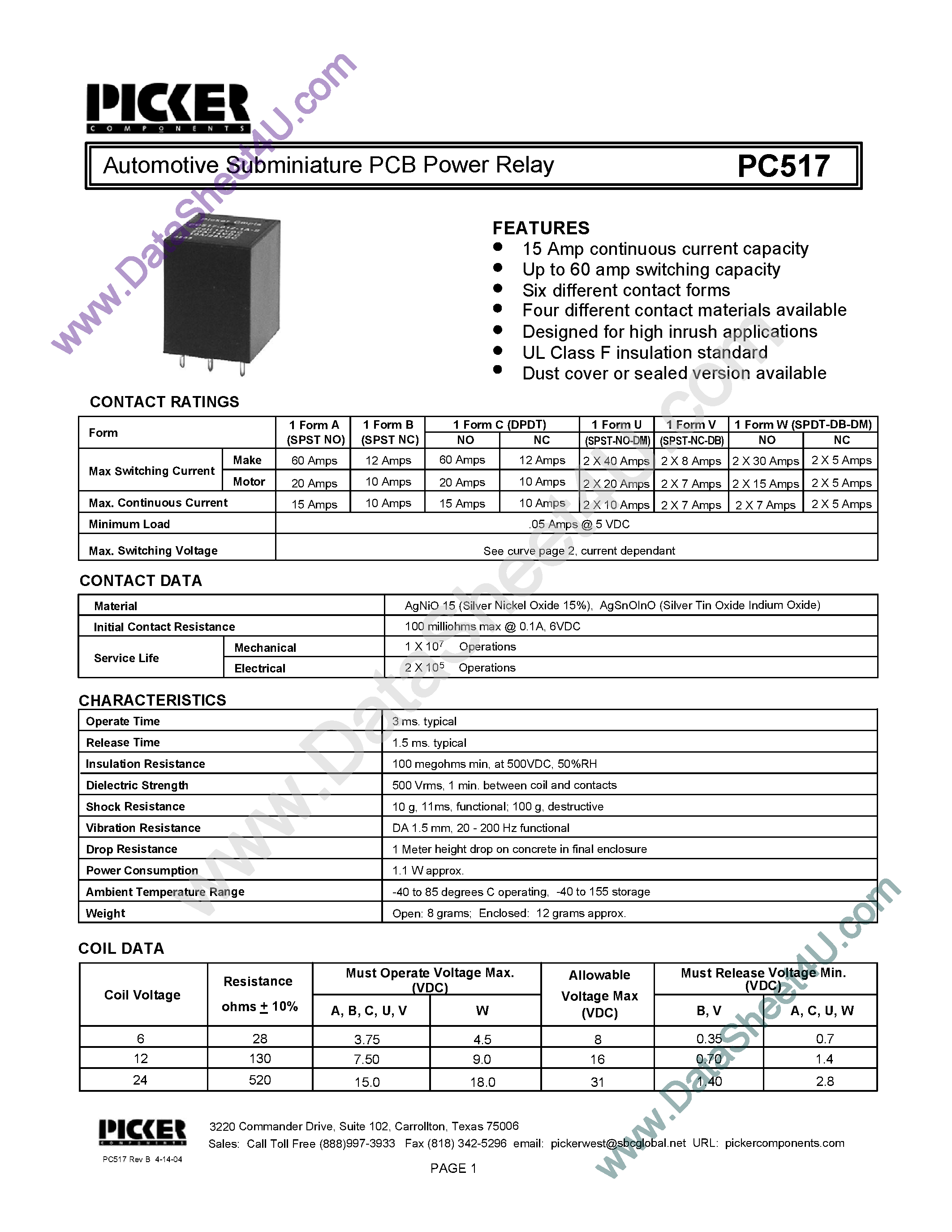

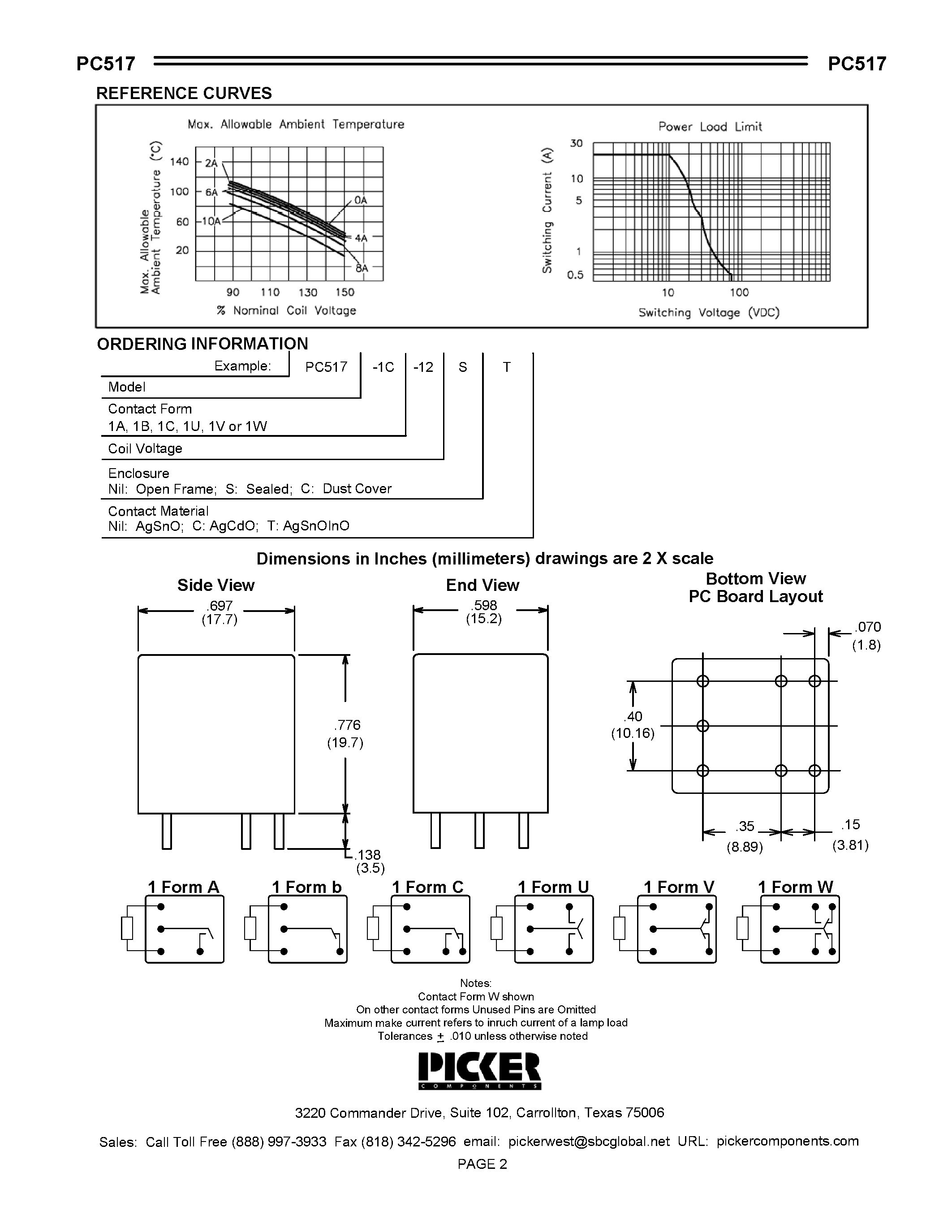

PC517-Automotive Subminiature PCB Power Relay
Producer:Picker
Description:Automotive Subminiature PCB Power Relay
Others with the same file: PC517
Datasheet PC517 - Automotive Subminiature PCB Power Relay page 1
Datasheet PC517 - Automotive Subminiature PCB Power Relay page 2
