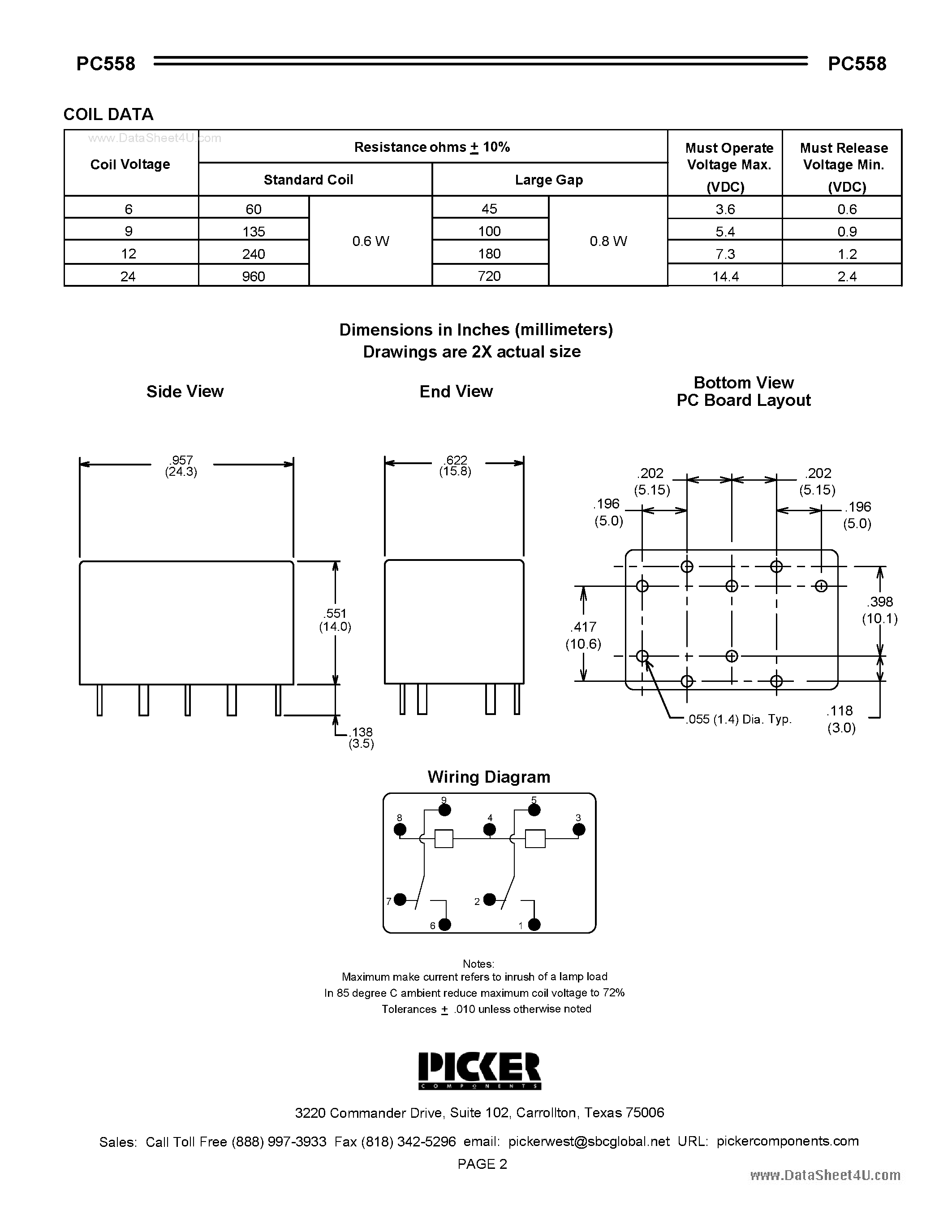

PC558-Subminiature Automotive PCB Twin Power Relay
Producer:Picker Components
Description:Subminiature Automotive PCB Twin Power Relay
Others with the same file: PC558
Datasheet PC558 - Subminiature Automotive PCB Twin Power Relay page 1
Datasheet PC558 - Subminiature Automotive PCB Twin Power Relay page 2
