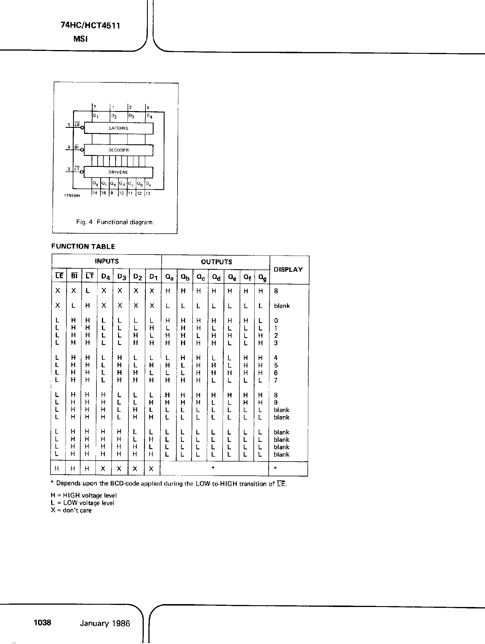

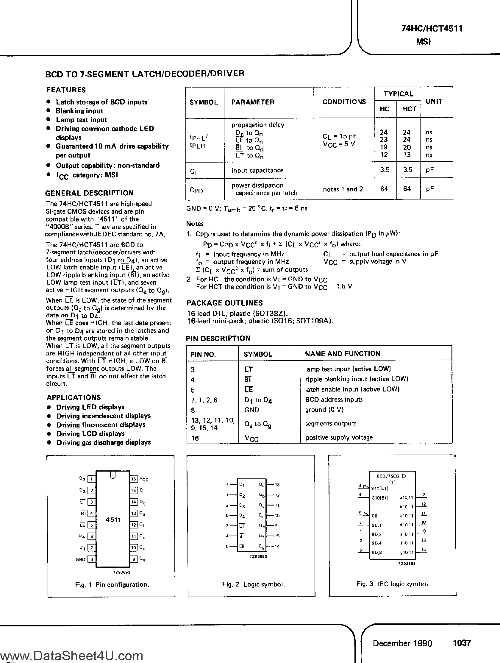

PC74HC4511-(It is accurate) BCD to 7-Segment Latch / Decoder / Driver
Description:(It is accurate) BCD to 7-Segment Latch / Decoder / Driver
