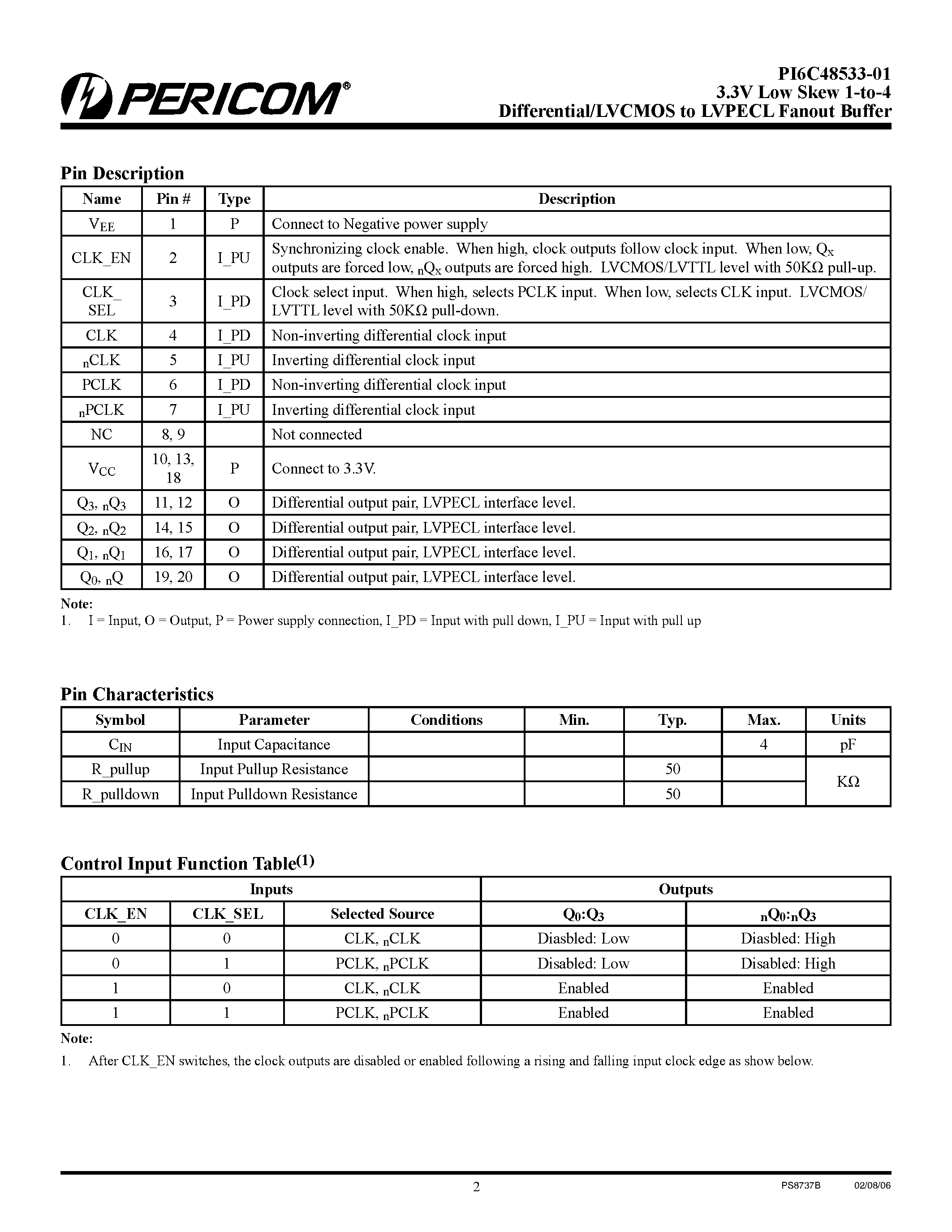

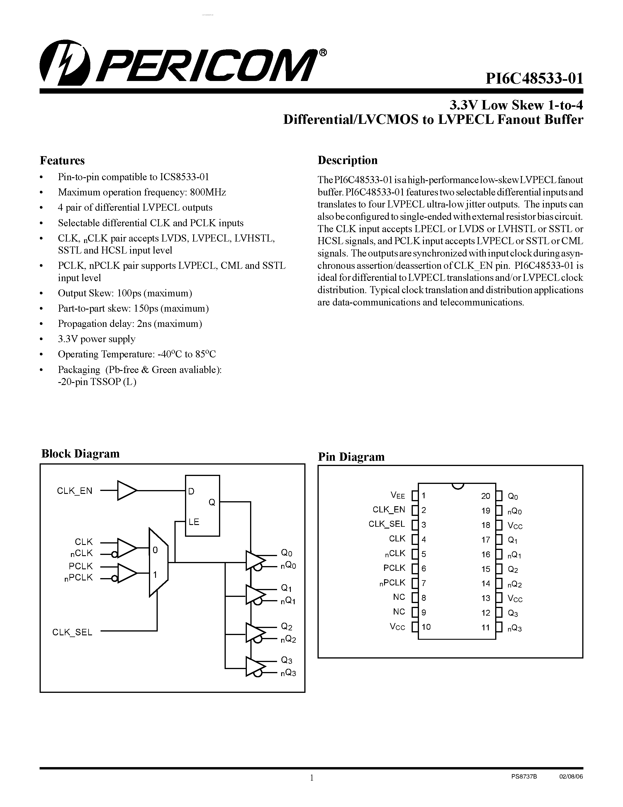

PI6C48533-01-Differential/LVCMOS to LVPECL Fanout Buffer
Producer:Pericom Semiconductor
Description:Differential/LVCMOS to LVPECL Fanout Buffer
Others with the same file: PI6C48533-01
Datasheet PI6C48533-01 - Differential/LVCMOS to LVPECL Fanout Buffer page 1
Datasheet PI6C48533-01 - Differential/LVCMOS to LVPECL Fanout Buffer page 2
