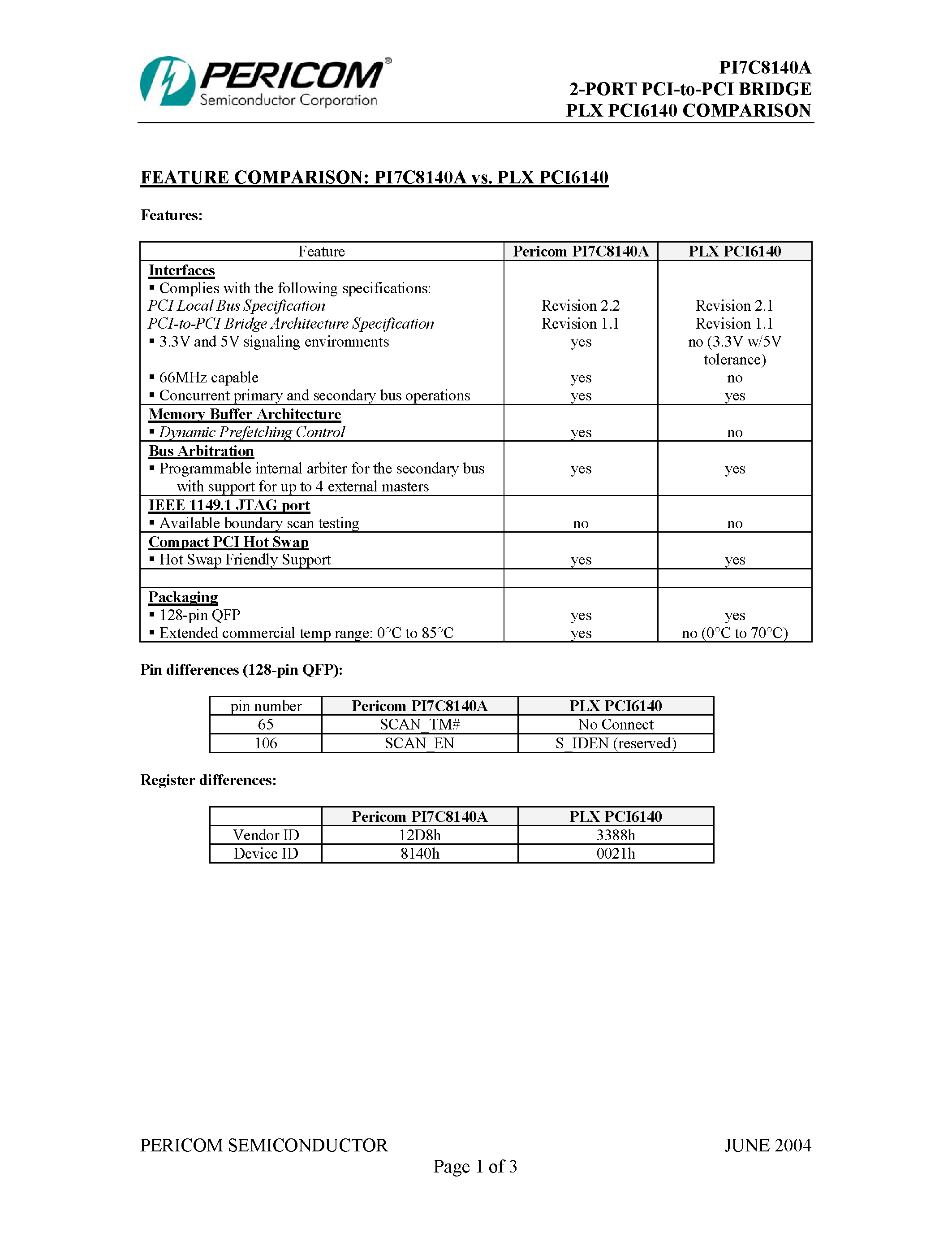

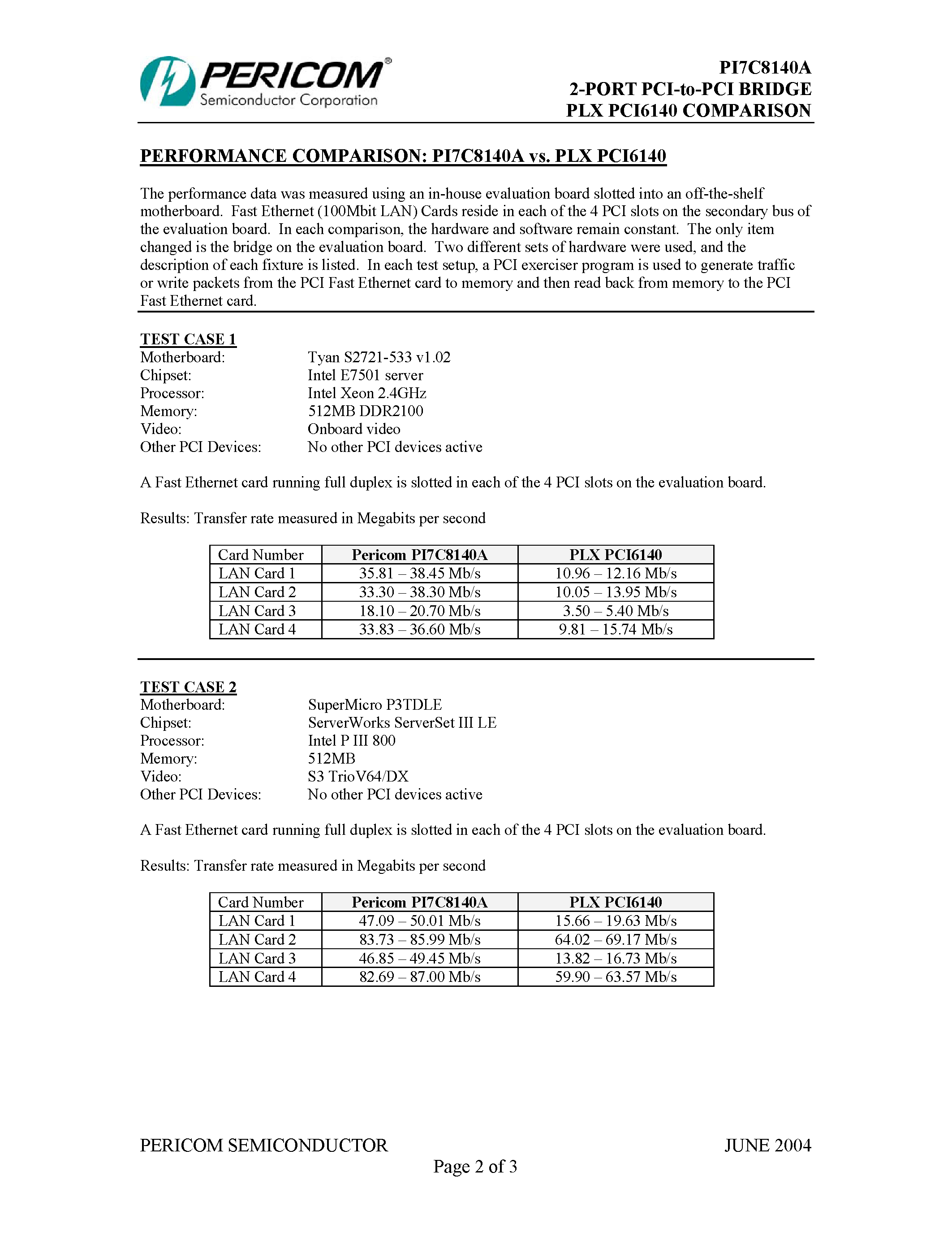

PLXPCI6140-2 PORT PCI TO PCI BRIDGE PLX PCI 6140 COMPARISON
Producer:Pericom Semiconductor Corporation
Description:2 PORT PCI TO PCI BRIDGE PLX PCI 6140 COMPARISON
Others with the same file: PLXPCI6140
Datasheet PLXPCI6140 - 2 PORT PCI TO PCI BRIDGE PLX PCI 6140 COMPARISON page 1
Datasheet PLXPCI6140 - 2 PORT PCI TO PCI BRIDGE PLX PCI 6140 COMPARISON page 2
