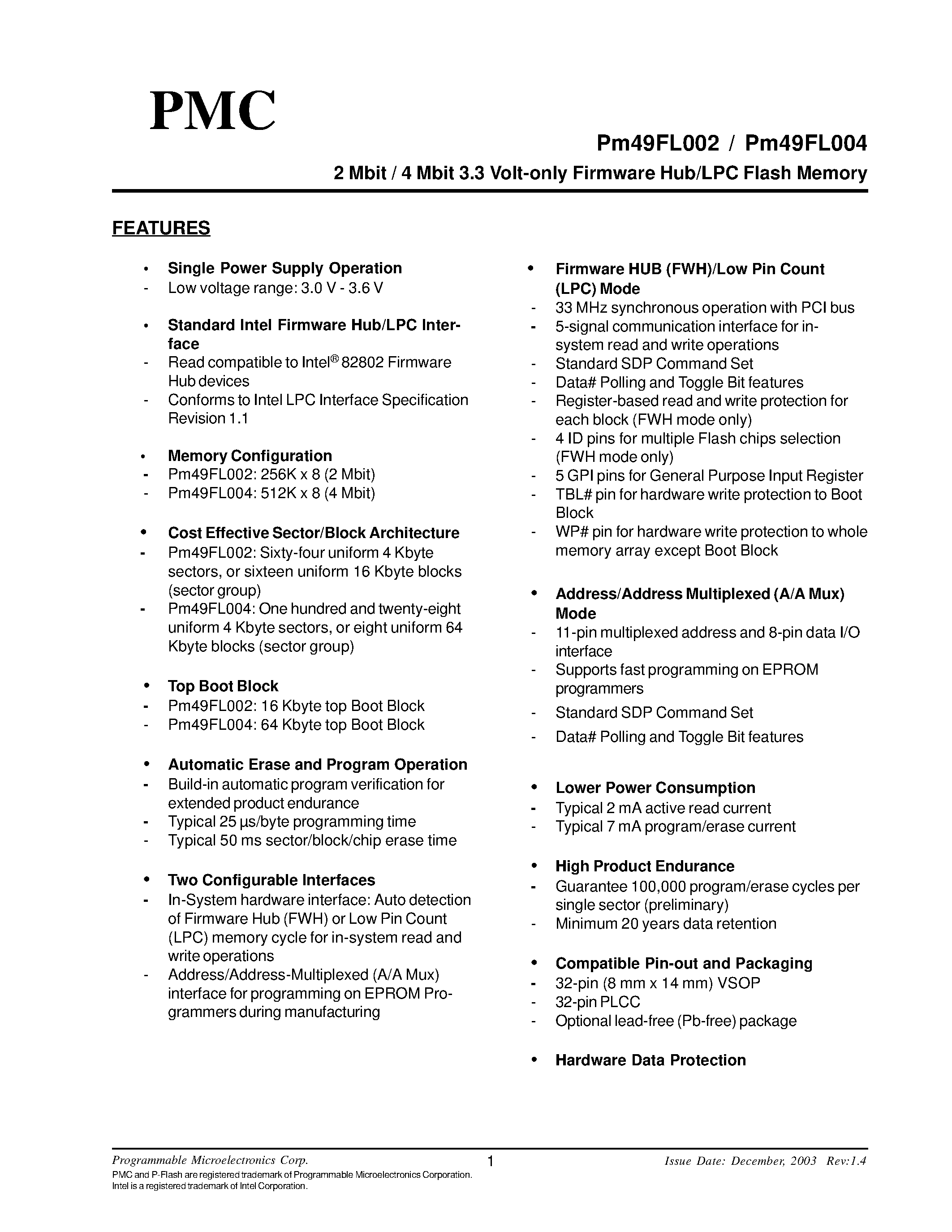

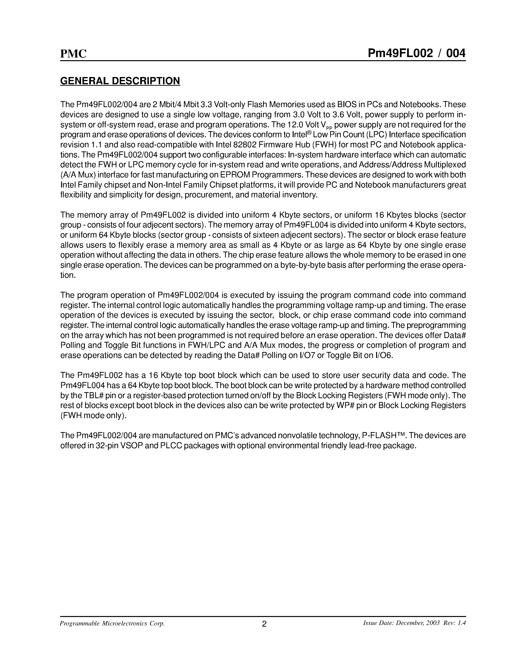

PM49FL002-2 Mbit / 4 Mbit 3.3 Volt-only Fimware Hub / LPC Flash Memory
Producer:Programmable Microelectronics
Description:2 Mbit / 4 Mbit 3.3 Volt-only Fimware Hub / LPC Flash Memory
