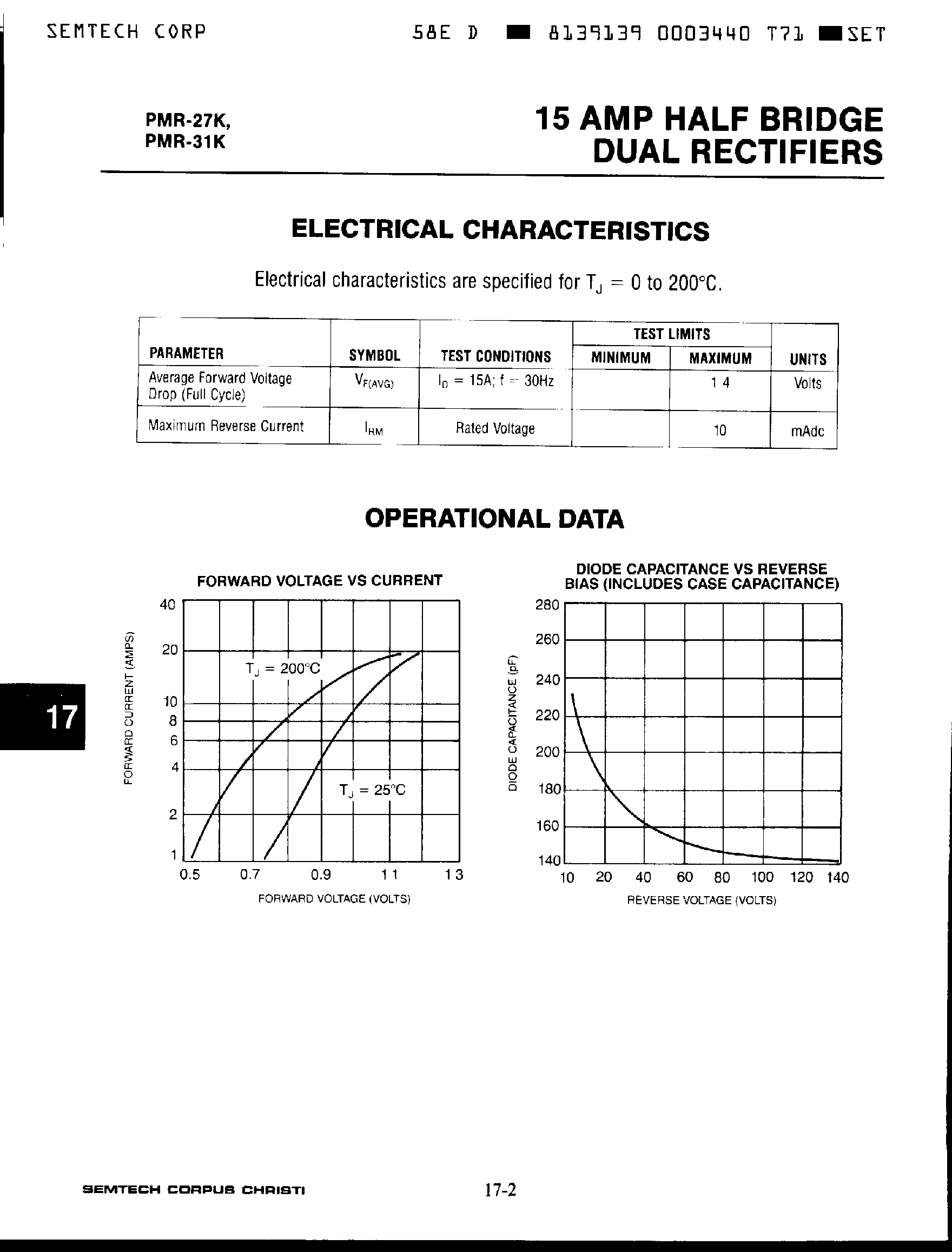

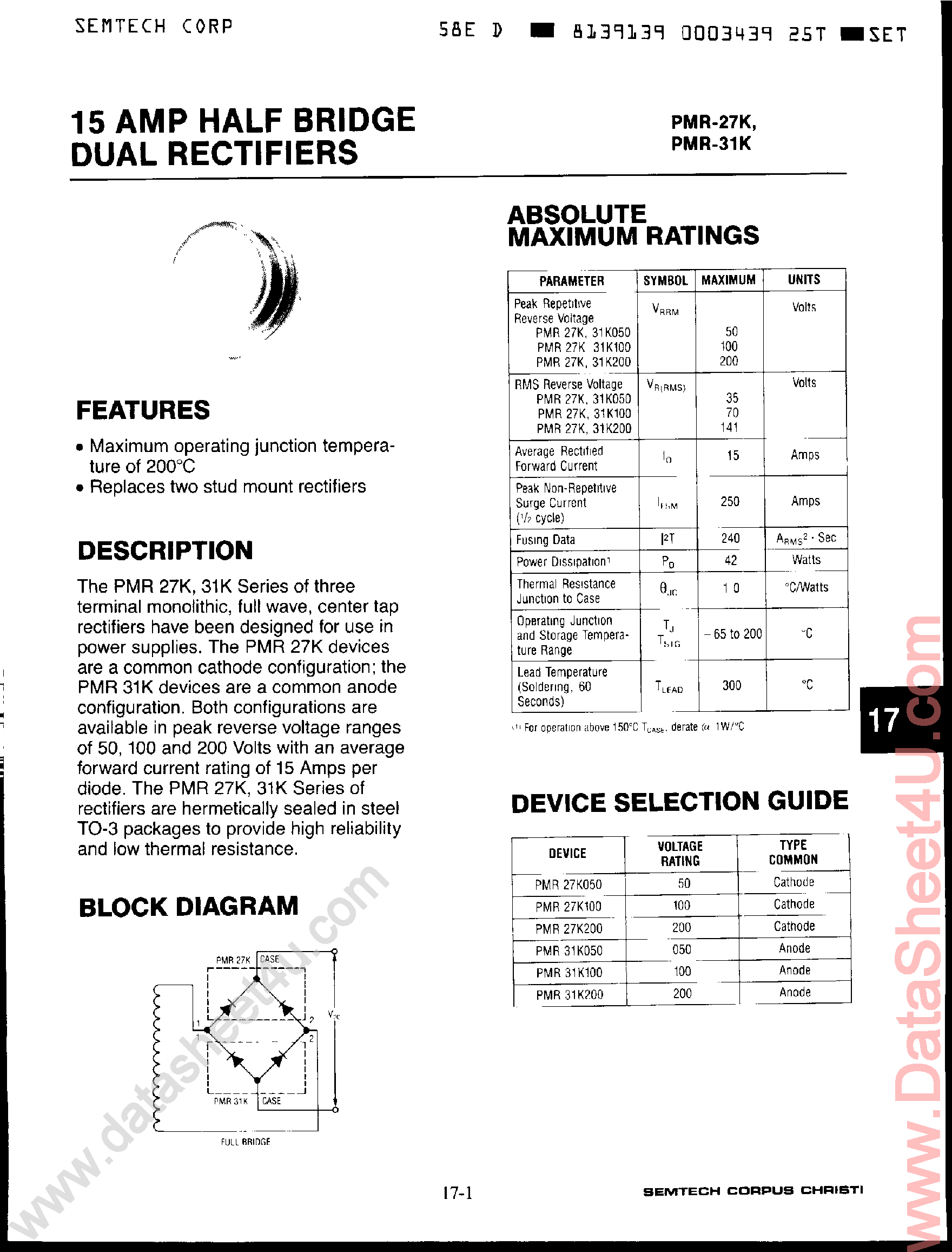

PMR-27K-(PMR31K-xxx / PMR27K-xxx) 15 Amp Half Bridge Dual Rectifiers
Producer:Semtech
Description:(PMR31K-xxx / PMR27K-xxx) 15 Amp Half Bridge Dual Rectifiers
