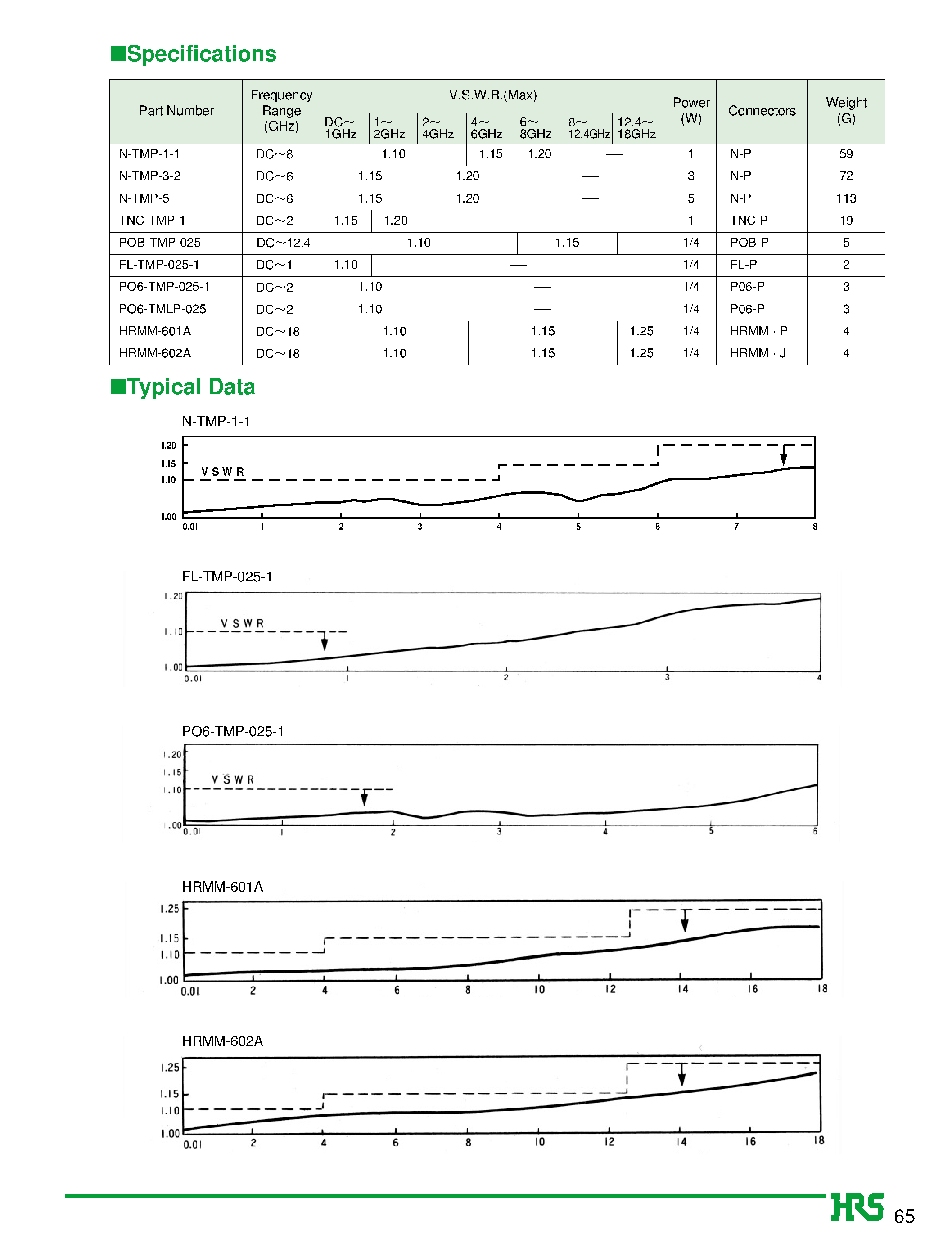

PO6-TMLP-025-Non-reflective Terminations (N / TNC / SSMA / POB / FL / and PO6)
Producer:Hirose Electric
Description:Non-reflective Terminations (N / TNC / SSMA / POB / FL / and PO6)
Others with the same file: PO6-TMLP-025
Datasheet PO6-TMLP-025 - Non-reflective Terminations (N / TNC / SSMA / POB / FL / and PO6) page 1
Datasheet PO6-TMLP-025 - Non-reflective Terminations (N / TNC / SSMA / POB / FL / and PO6) page 2
