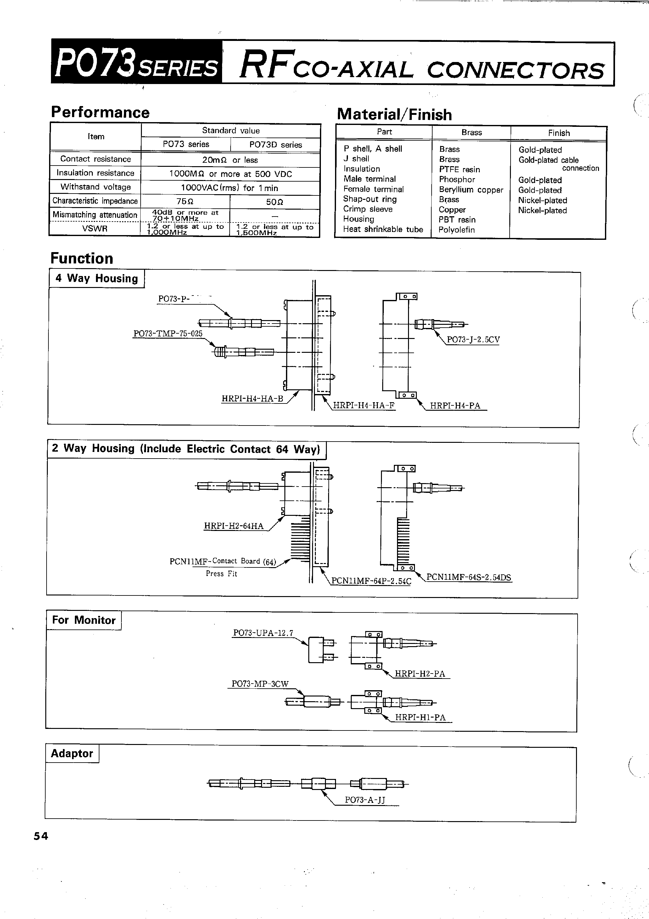

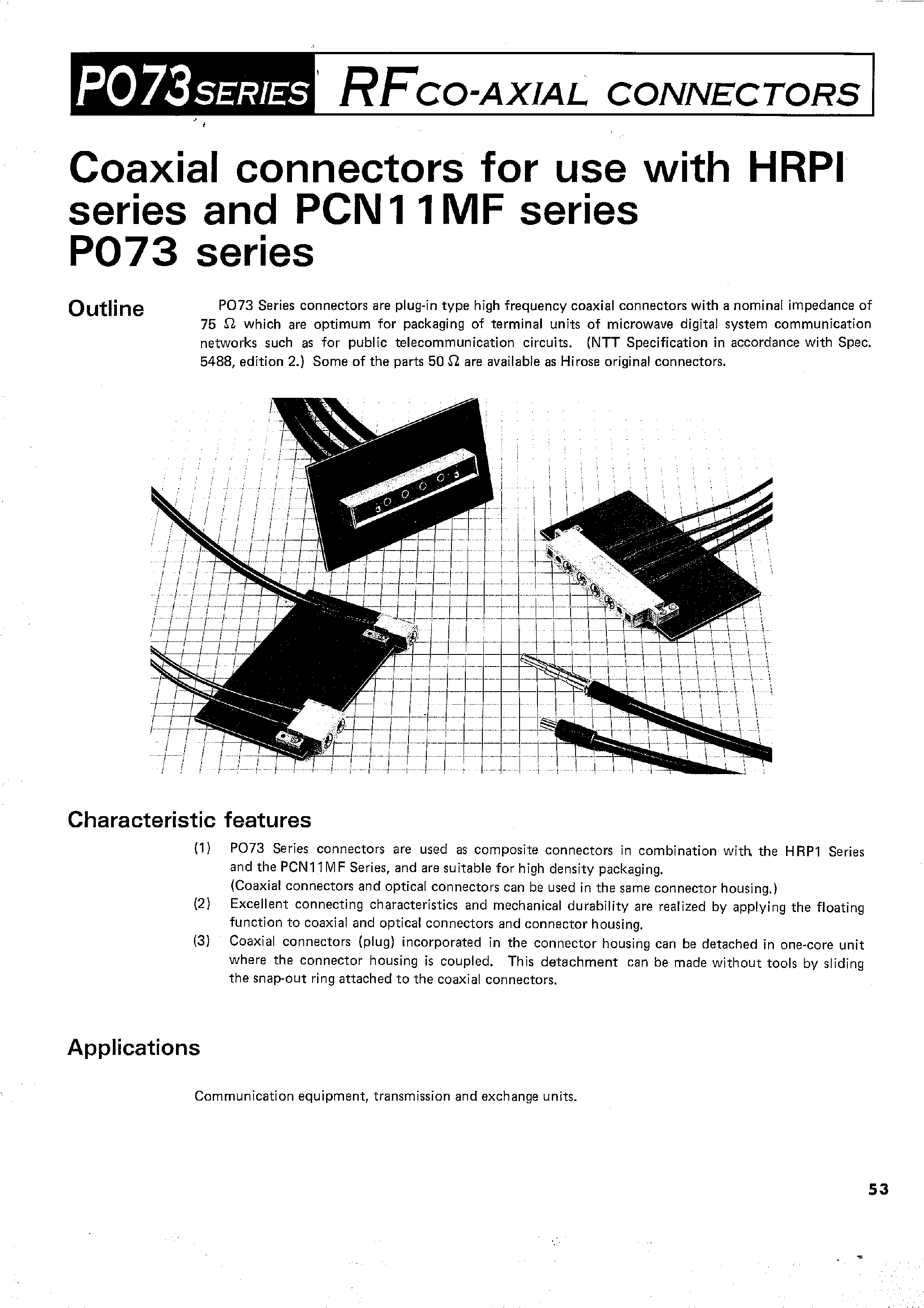

PO73-A-JJ-RFCO-AXIAL CONNECTORS(COAXIAL CONNECTORS for use with HRPI)
Producer:Hirose Electric
Description:RFCO-AXIAL CONNECTORS(COAXIAL CONNECTORS for use with HRPI)
Others with the same file: PO73-A-JJ
Datasheet PO73-A-JJ - RFCO-AXIAL CONNECTORS(COAXIAL CONNECTORS for use with HRPI) page 1
Datasheet PO73-A-JJ - RFCO-AXIAL CONNECTORS(COAXIAL CONNECTORS for use with HRPI) page 2
