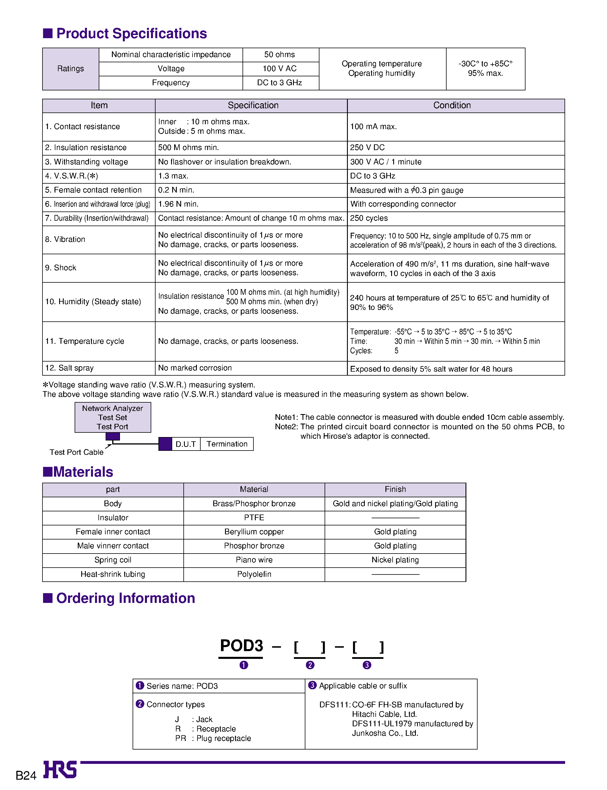

POD3-J-DFS111-Push-Pull Complete Locking Coaxial Connectors (PC Card Type 2 Mountable)
Producer:Hirose Electric
Description:Push-Pull Complete Locking Coaxial Connectors (PC Card Type 2 Mountable)
