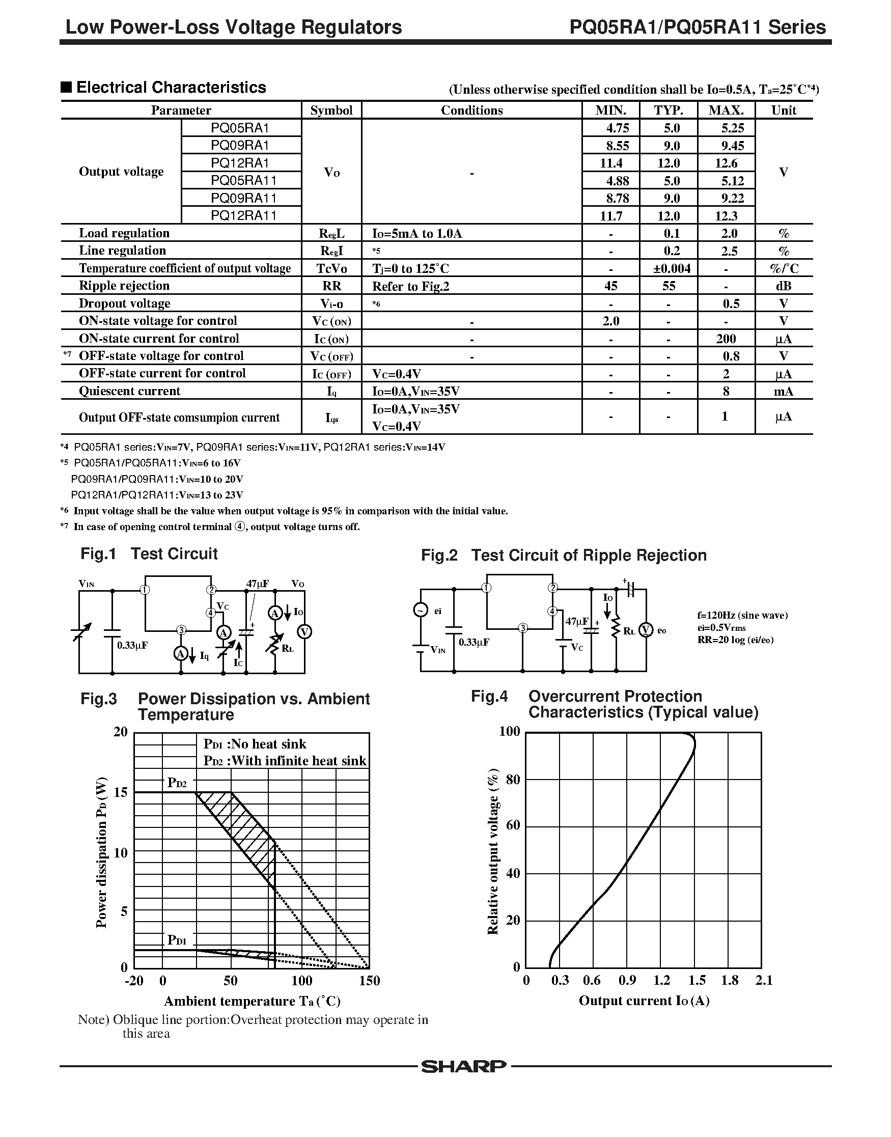

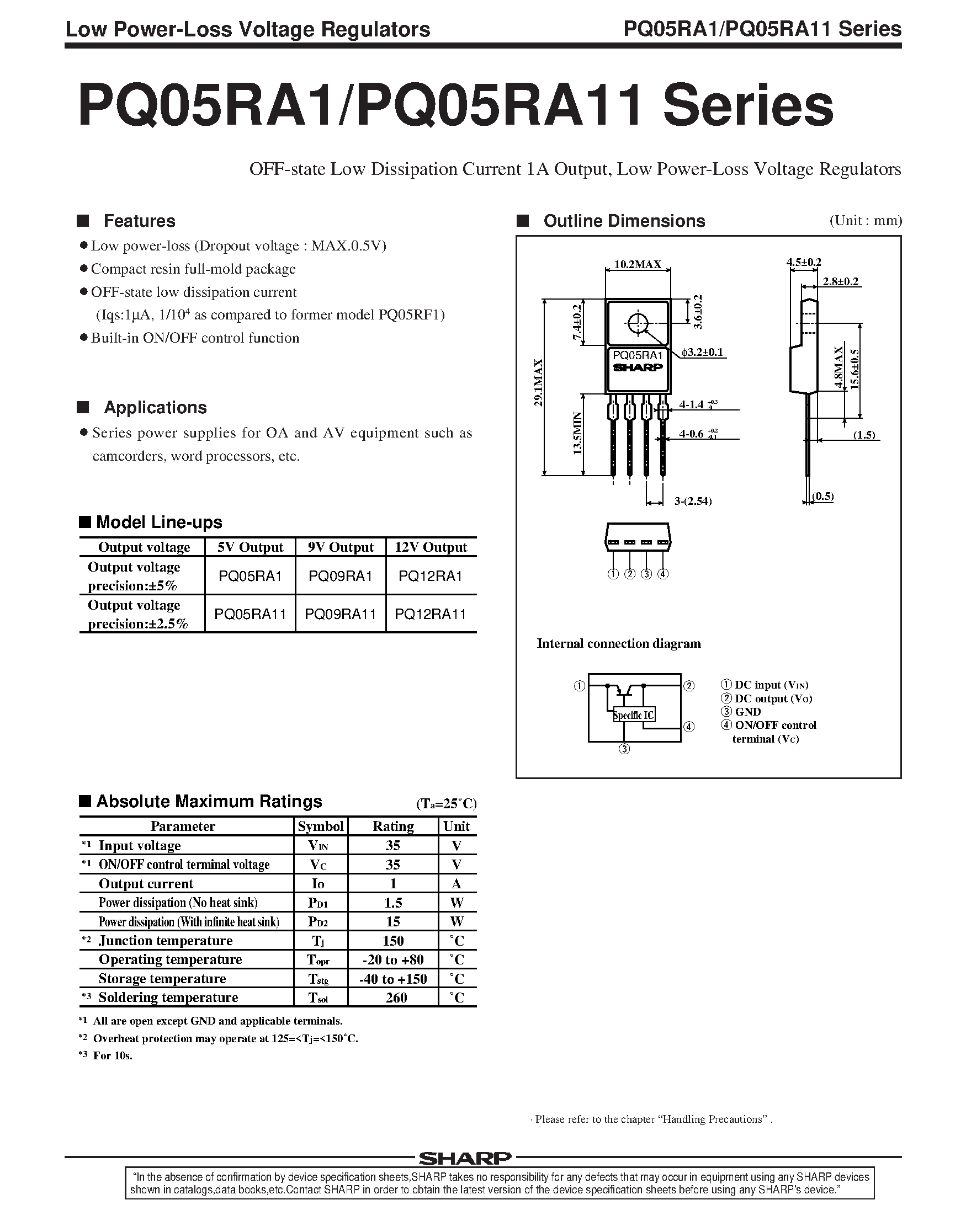

PQ05RA11-OFF-state Low Dissipation Current 1A Output / Low Power-Loss Voltage Regulators
Producer:Sharp
Description:OFF-state Low Dissipation Current 1A Output / Low Power-Loss Voltage Regulators
Others with the same file: PQ05RA11
Datasheet PQ05RA11 - OFF-state Low Dissipation Current 1A Output / Low Power-Loss Voltage Regulators page 1
Datasheet PQ05RA11 - OFF-state Low Dissipation Current 1A Output / Low Power-Loss Voltage Regulators page 2
