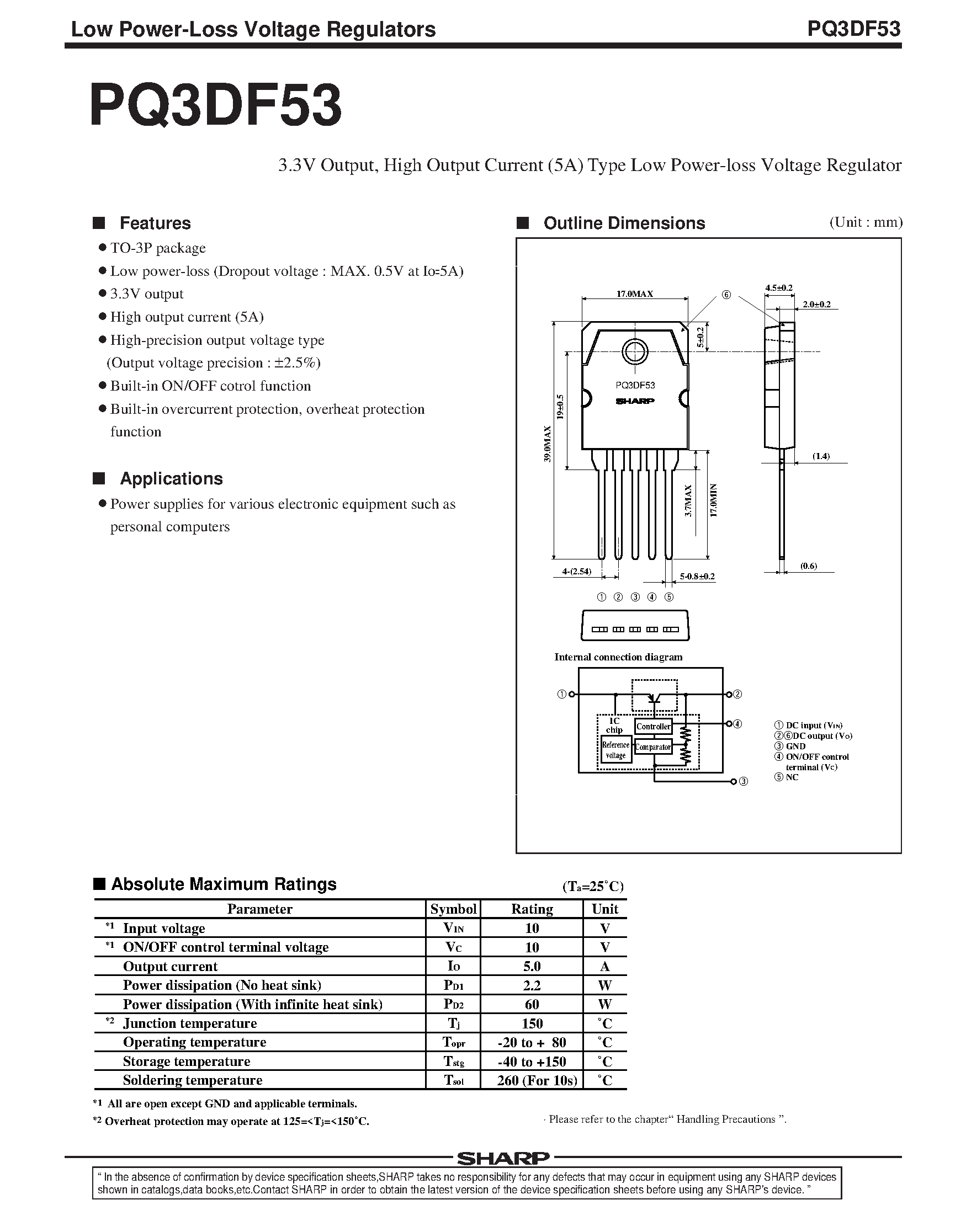

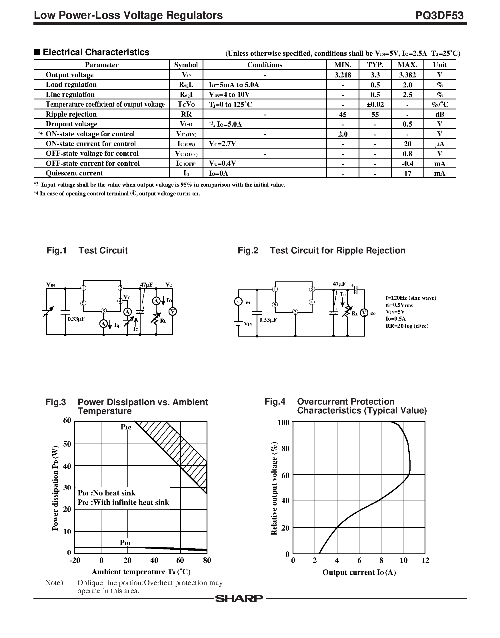

PQ3DF53-3.3V Output / High Output Current (5A) Type Low Power-loss Voltage Regulator
Producer:Sharp
Description:3.3V Output / High Output Current (5A) Type Low Power-loss Voltage Regulator
Others with the same file: PQ3DF53
Datasheet PQ3DF53 - 3.3V Output / High Output Current (5A) Type Low Power-loss Voltage Regulator page 1
Datasheet PQ3DF53 - 3.3V Output / High Output Current (5A) Type Low Power-loss Voltage Regulator page 2
