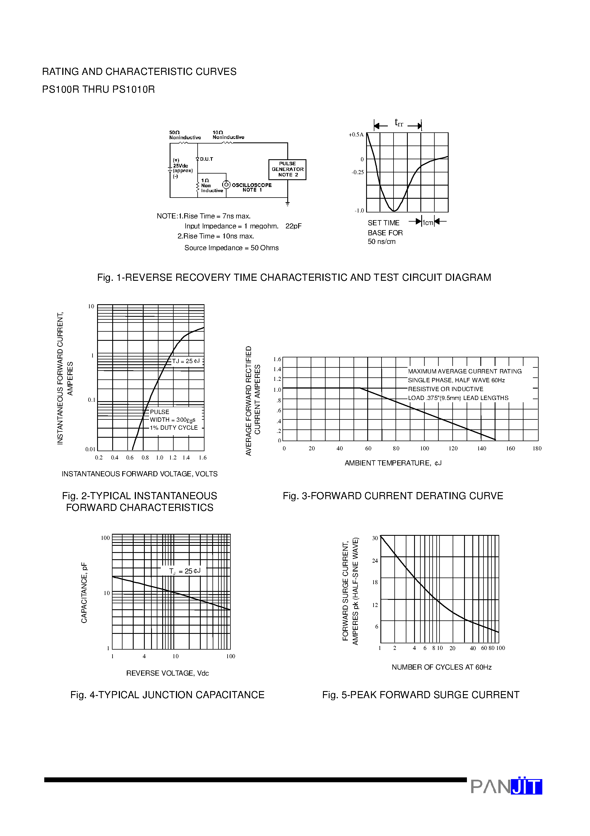

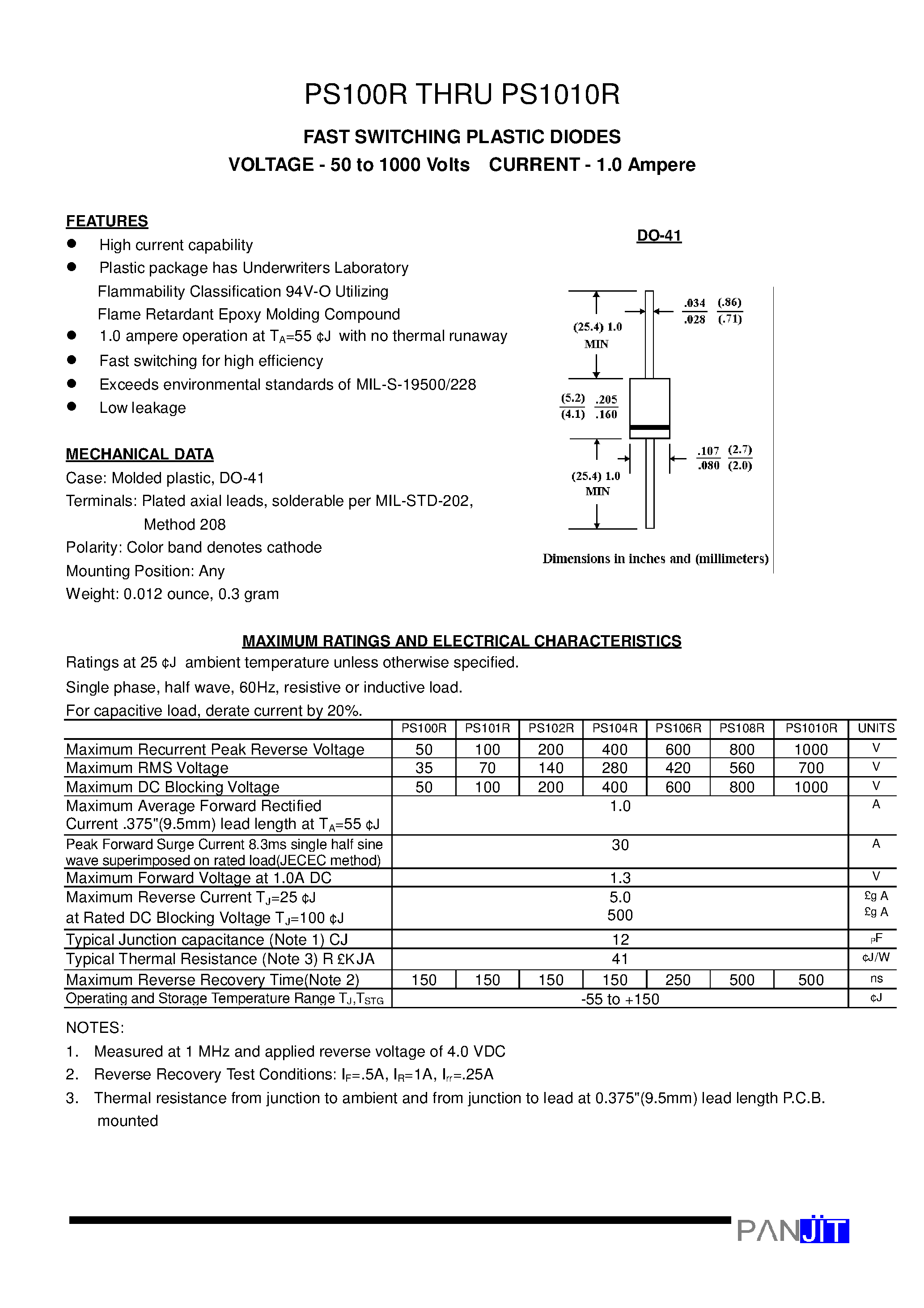

PS1010R-FAST SWITCHING PLASTIC DIODES(VOLTAGE - 50 to 1000 Volts CURRENT - 1.0 Ampere)
Producer:Pan Jit International
Description:FAST SWITCHING PLASTIC DIODES(VOLTAGE - 50 to 1000 Volts CURRENT - 1.0 Ampere)
Others with the same file: PS1010R
Datasheet PS1010R - FAST SWITCHING PLASTIC DIODES(VOLTAGE - 50 to 1000 Volts CURRENT - 1.0 Ampere) page 1
Datasheet PS1010R - FAST SWITCHING PLASTIC DIODES(VOLTAGE - 50 to 1000 Volts CURRENT - 1.0 Ampere) page 2
