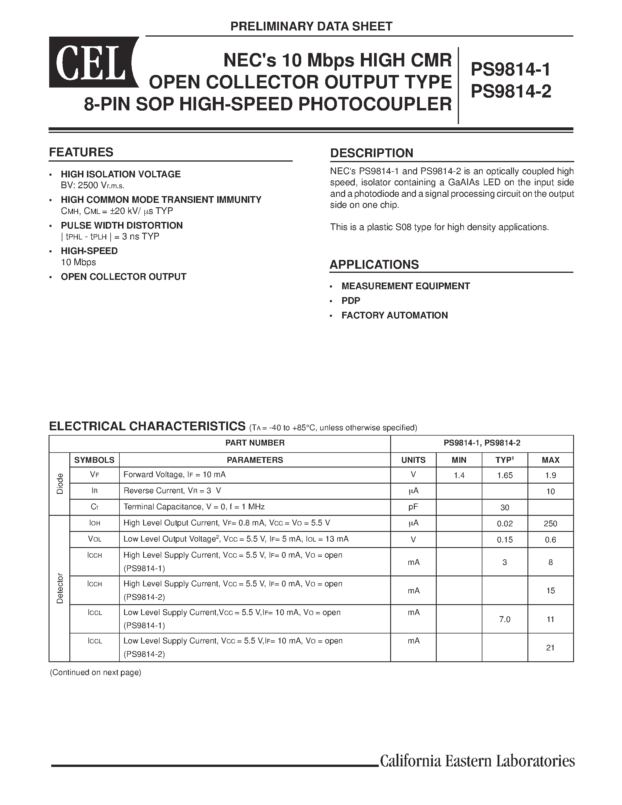

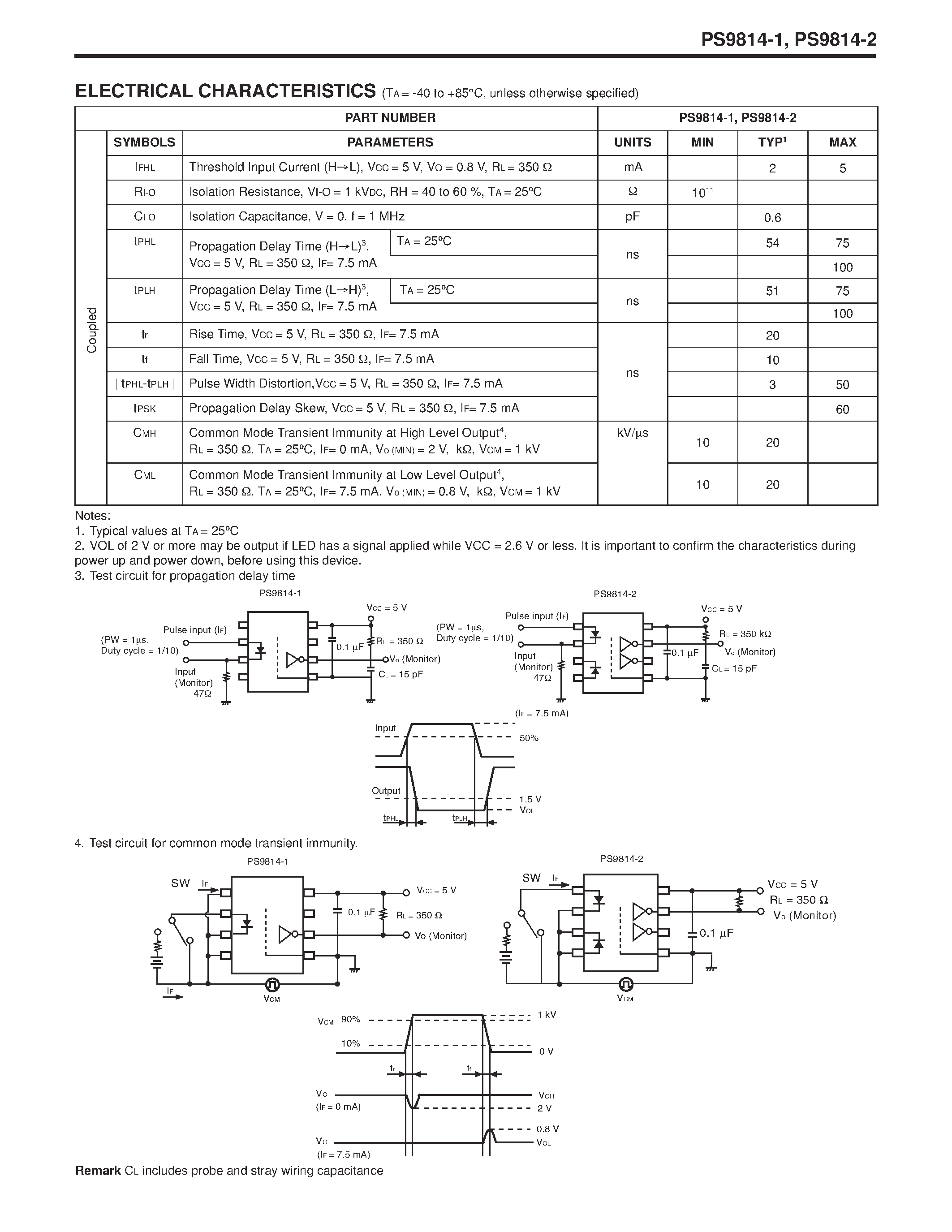

PS9814-2-NECs 10 Mbps HIGH CMR OPEN COLLECTOR OUTPUT TYPE 8-PIN SOP HIGH-SPEED PHOTOCOUPLER
Producer:ETC
Description:NECs 10 Mbps HIGH CMR OPEN COLLECTOR OUTPUT TYPE 8-PIN SOP HIGH-SPEED PHOTOCOUPLER
