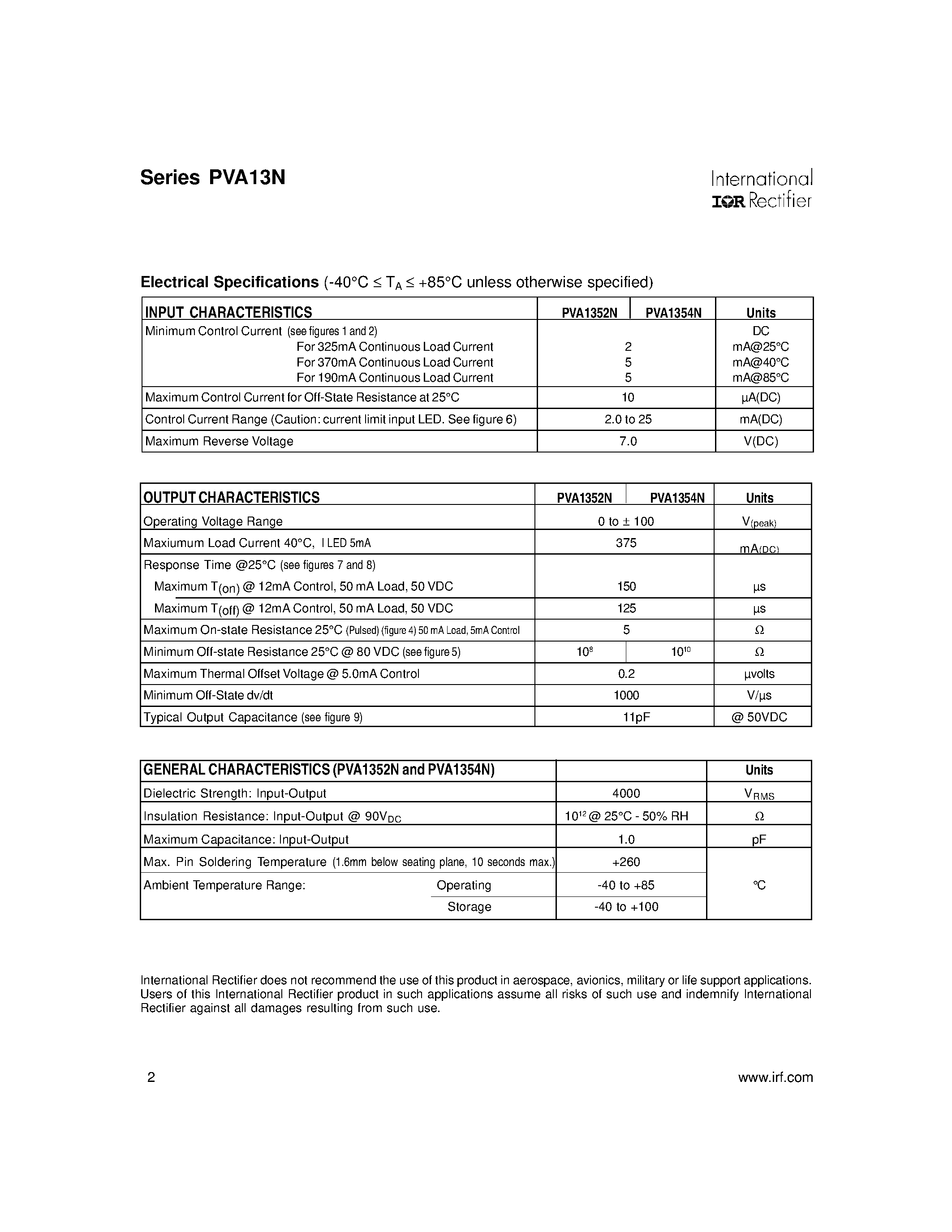

PVA1352NS-POWER MOSFET PHOTOVOLTAIC RELAY SINGLE POLE NORMALLY-OPEN 0-100V AC/DC 375MA
Description:POWER MOSFET PHOTOVOLTAIC RELAY SINGLE POLE NORMALLY-OPEN 0-100V AC/DC 375MA
