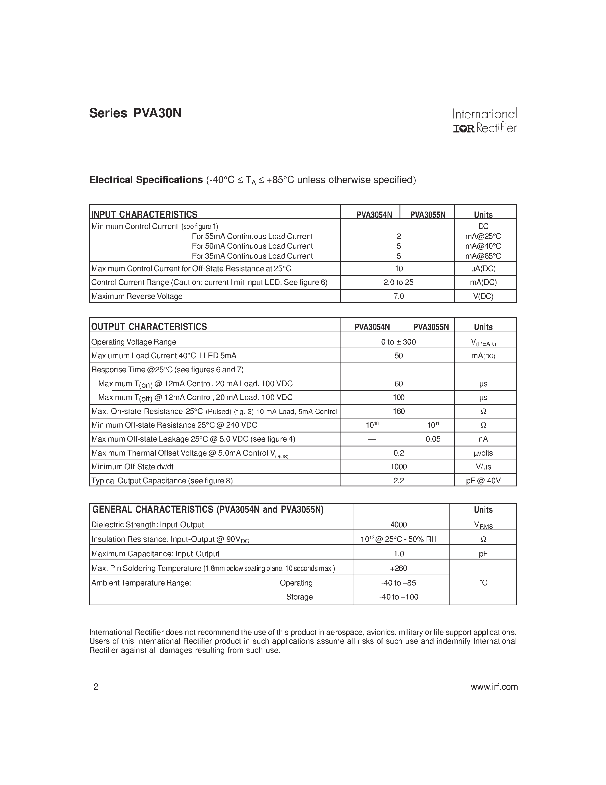

PVA3054-(PVA3054) Microelectronic Power IC HEXFET Power MOSFET Photovoltaic Relay Single-Pole
Description:(PVA3054) Microelectronic Power IC HEXFET Power MOSFET Photovoltaic Relay Single-Pole
