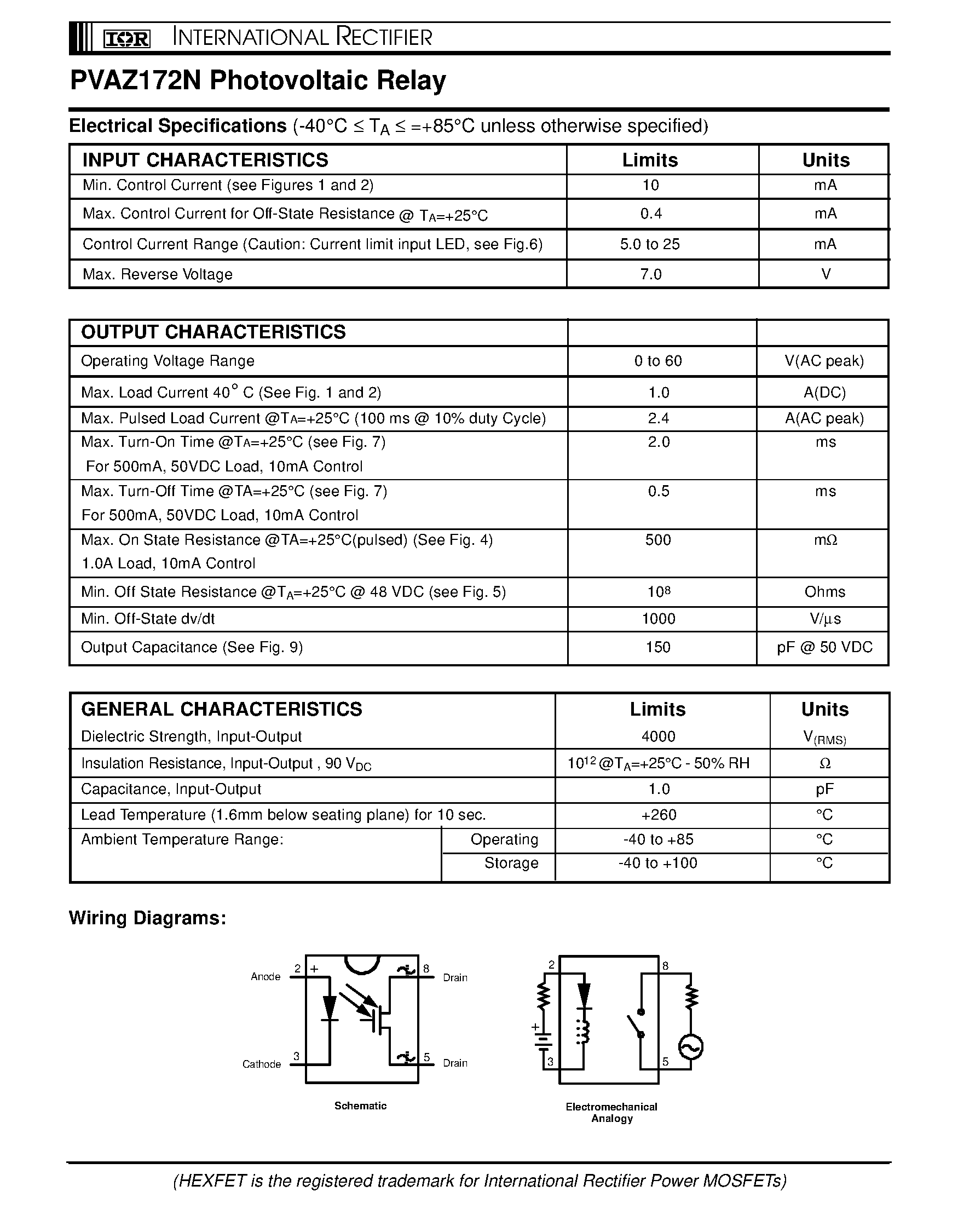

PVAZ172-POWER MOSFET PHOTOVOLTAIC RELAY Microelectronic Power IC Relay Single Pole/ Normally Open 0-60V AC/ 1.0A
Description:POWER MOSFET PHOTOVOLTAIC RELAY Microelectronic Power IC Relay Single Pole/ Normally Open 0-60V AC/ 1.0A
