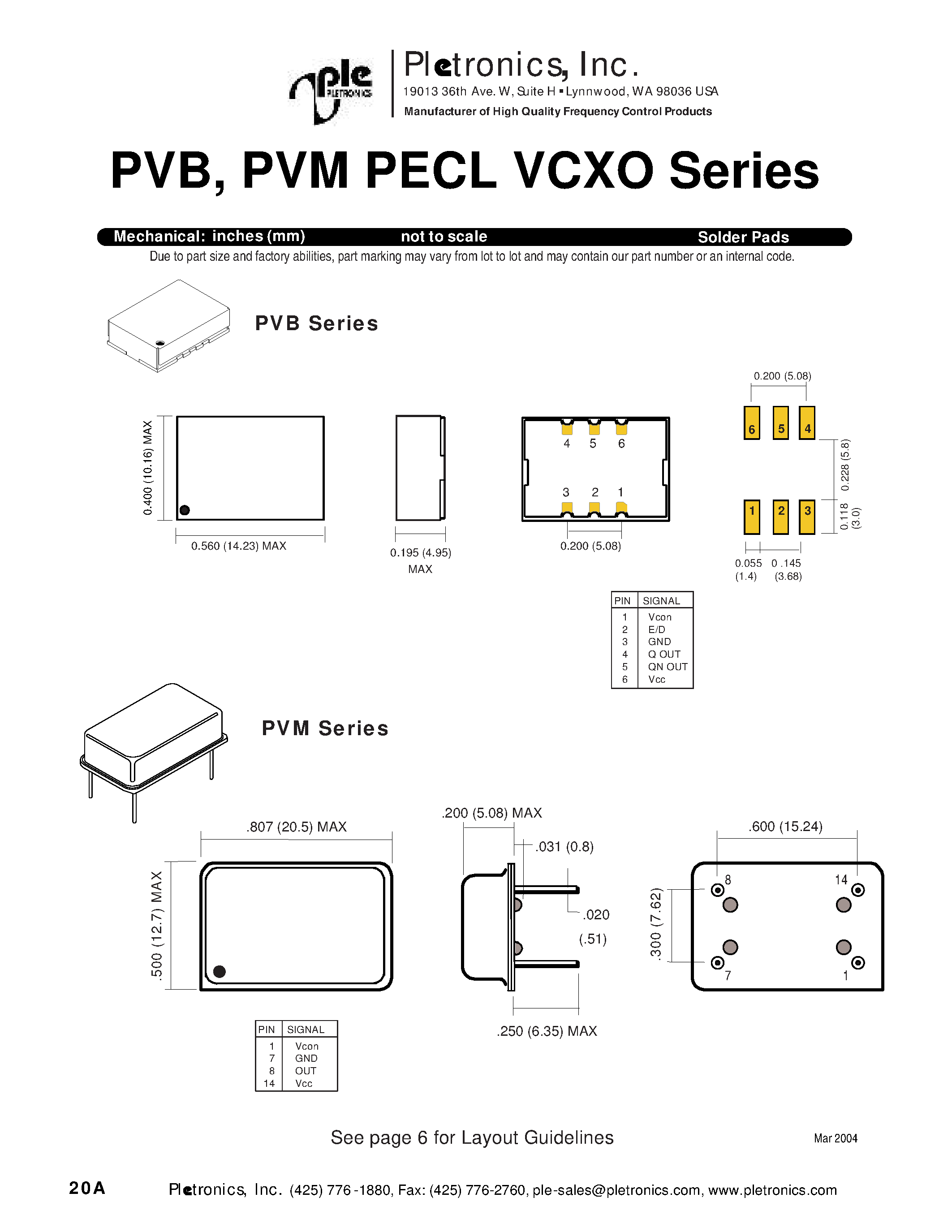

PVM2VBV-(PVM Series) 6 Pad Leadless Surface Mount or 4 Lead Thru-Hole PECL Voltage Controlled Xtal Oscillator
Producer:ETC
Description:(PVM Series) 6 Pad Leadless Surface Mount or 4 Lead Thru-Hole PECL Voltage Controlled Xtal Oscillator
Others with the same file: PVM2VBV | PVM2Vxx
PVM2Wxx | PVM2Yxx
PVM4Vxx | PVM4Wxx
PVM4Yxx | PVM5Vxx
PVM5Wxx | PVM5Yxx
Datasheet PVM2VBV - (PVM Series) 6 Pad Leadless Surface Mount or 4 Lead Thru-Hole PECL Voltage Controlled Xtal Oscillator page 1
Datasheet PVM2VBV - (PVM Series) 6 Pad Leadless Surface Mount or 4 Lead Thru-Hole PECL Voltage Controlled Xtal Oscillator page 2
