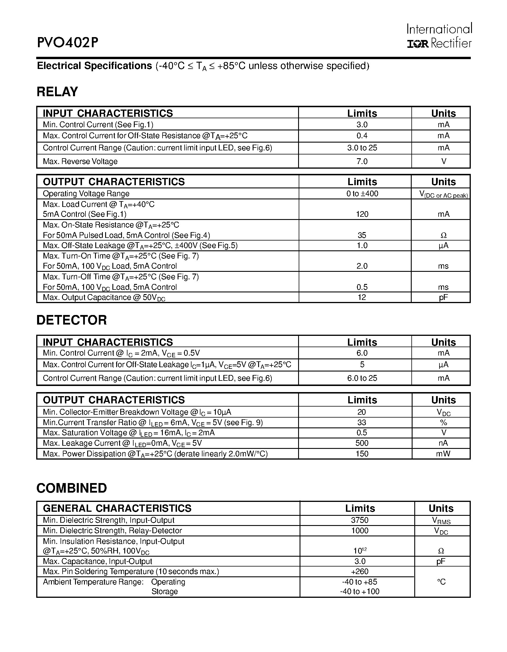

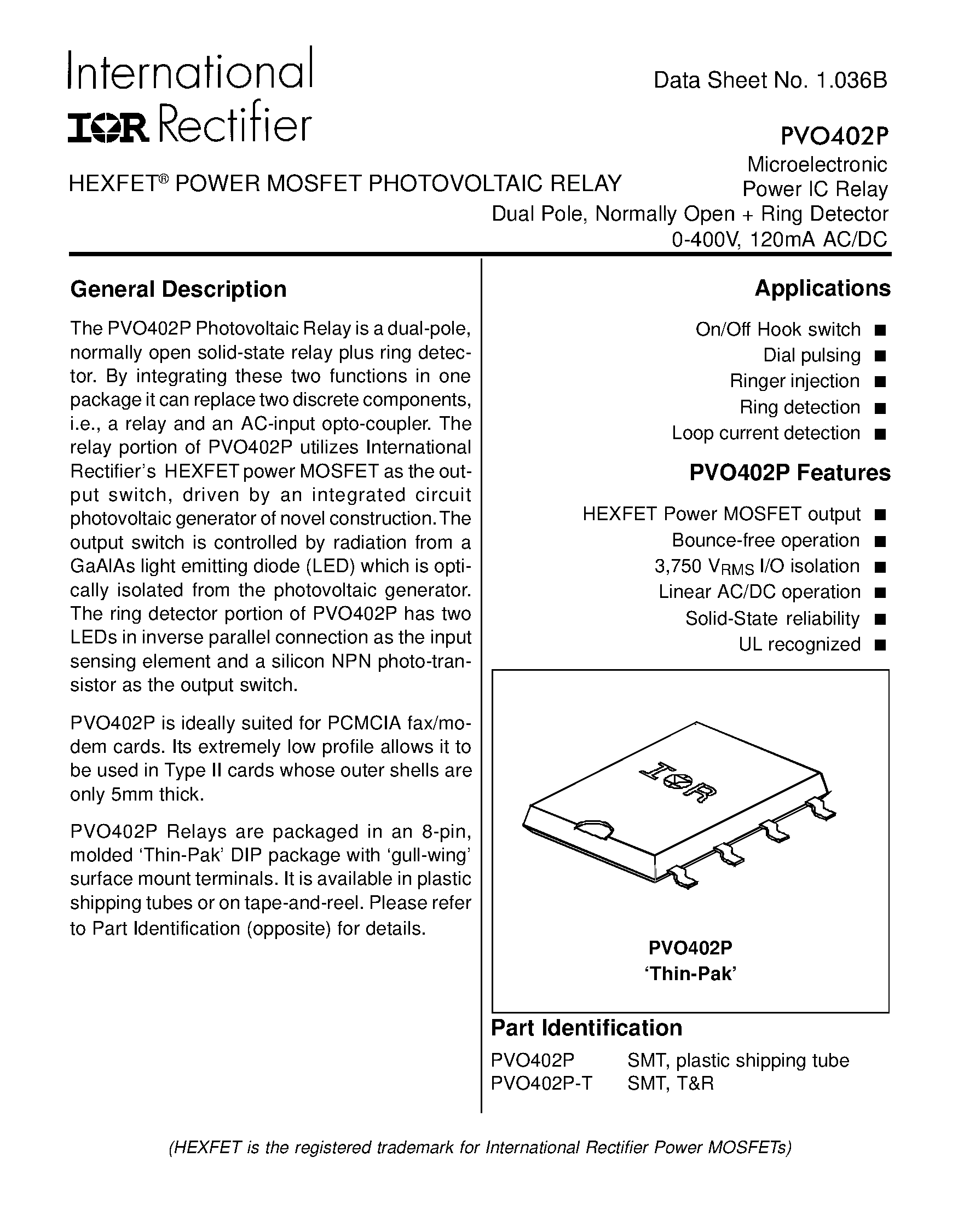

PVO402P-POWER MOSFET PHOTOVOLTAIC RELAY Microelectronic Power IC Relay Dual Pole/ Normally Open Ring Detector 0-400V/ 120mA AC/DC
Description:POWER MOSFET PHOTOVOLTAIC RELAY Microelectronic Power IC Relay Dual Pole/ Normally Open Ring Detector 0-400V/ 120mA AC/DC
