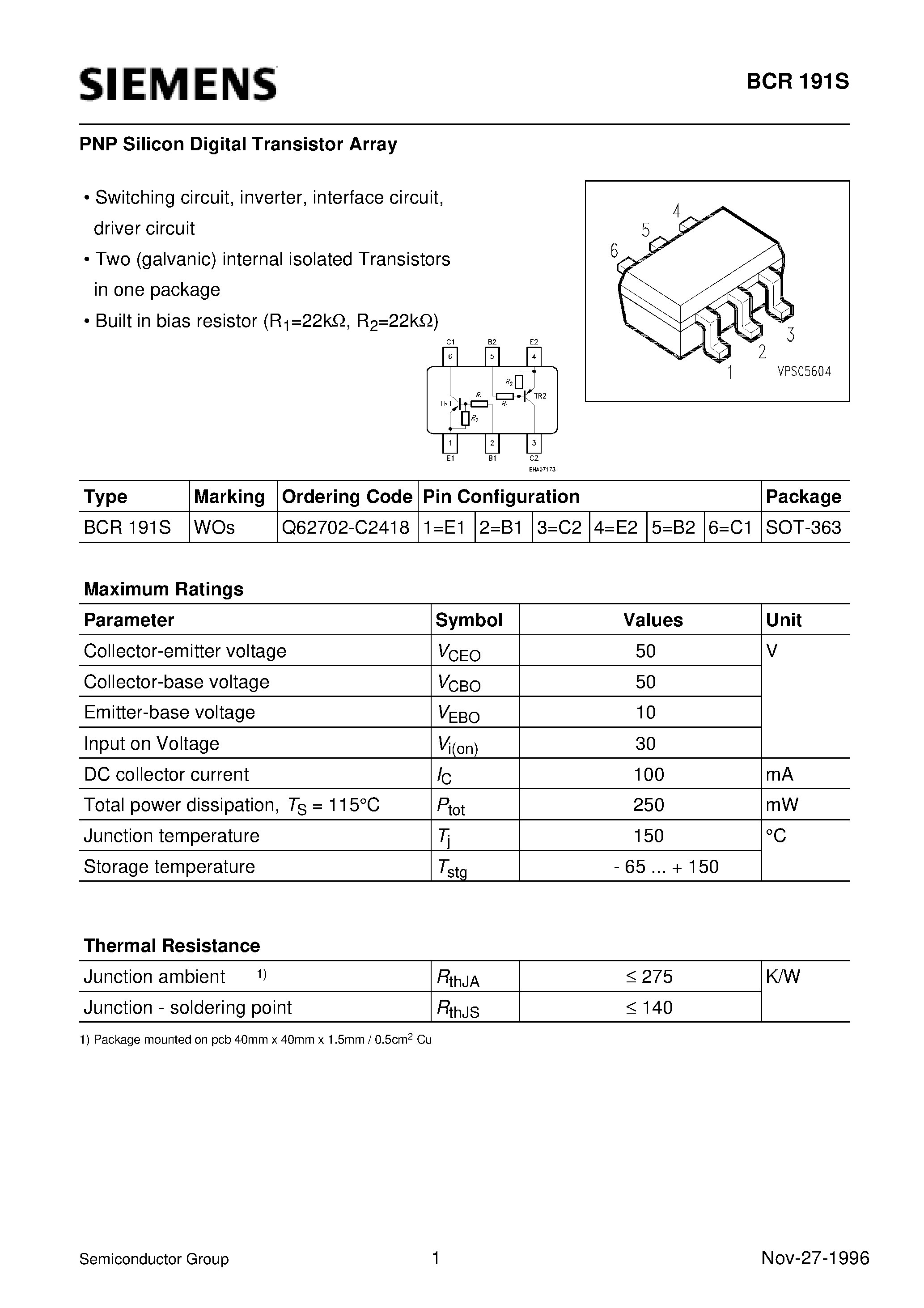

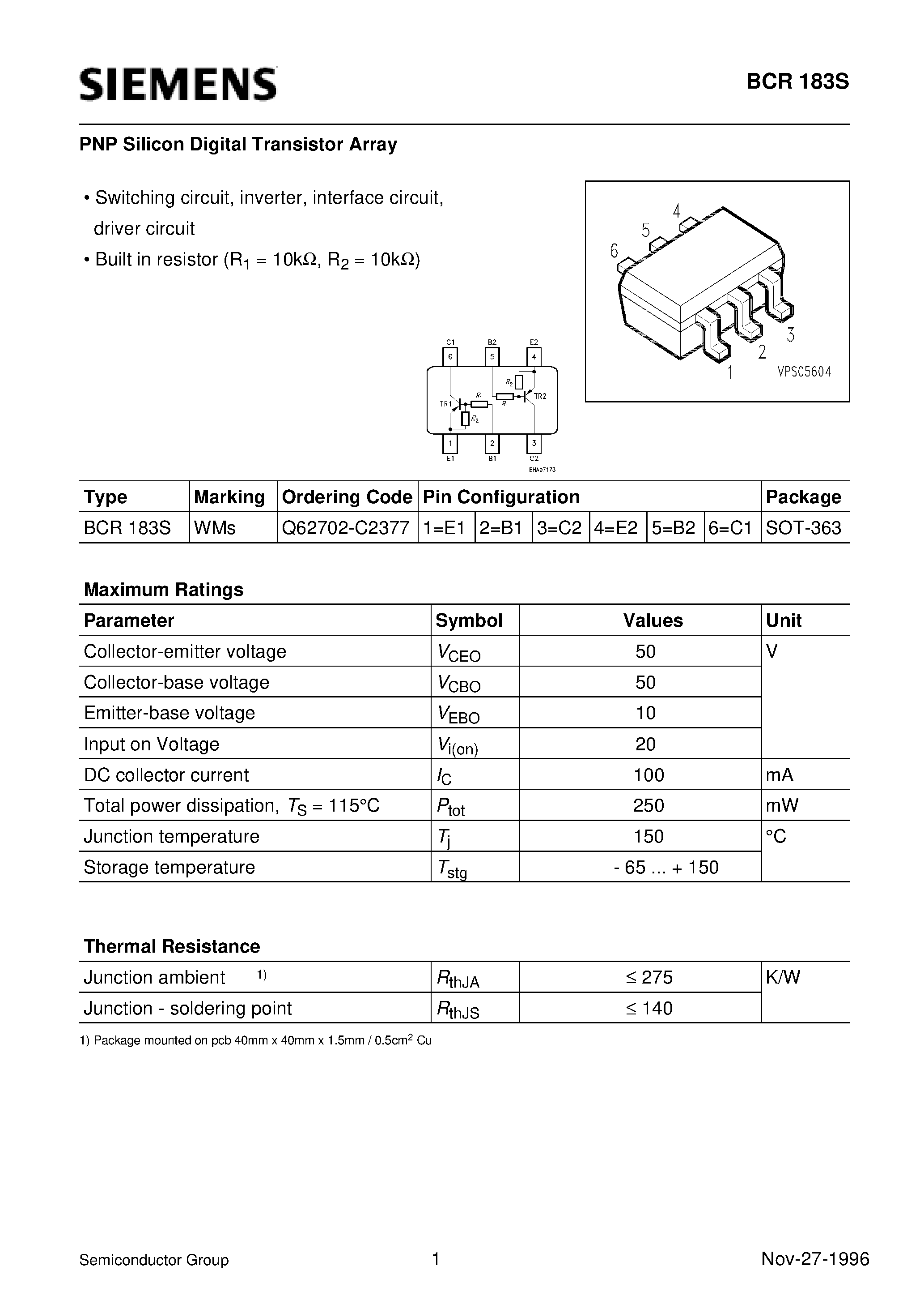

Description:PNP Silicon Digital Transistor Array (Switching circuit/ inverter/ interface circuit/ driver circuit)
Others with the same file: Q62702-C2377
Datasheet Q62702-C2377 - PNP Silicon Digital Transistor Array (Switching circuit/ inverter/ interface circuit/ driver circuit) page 1

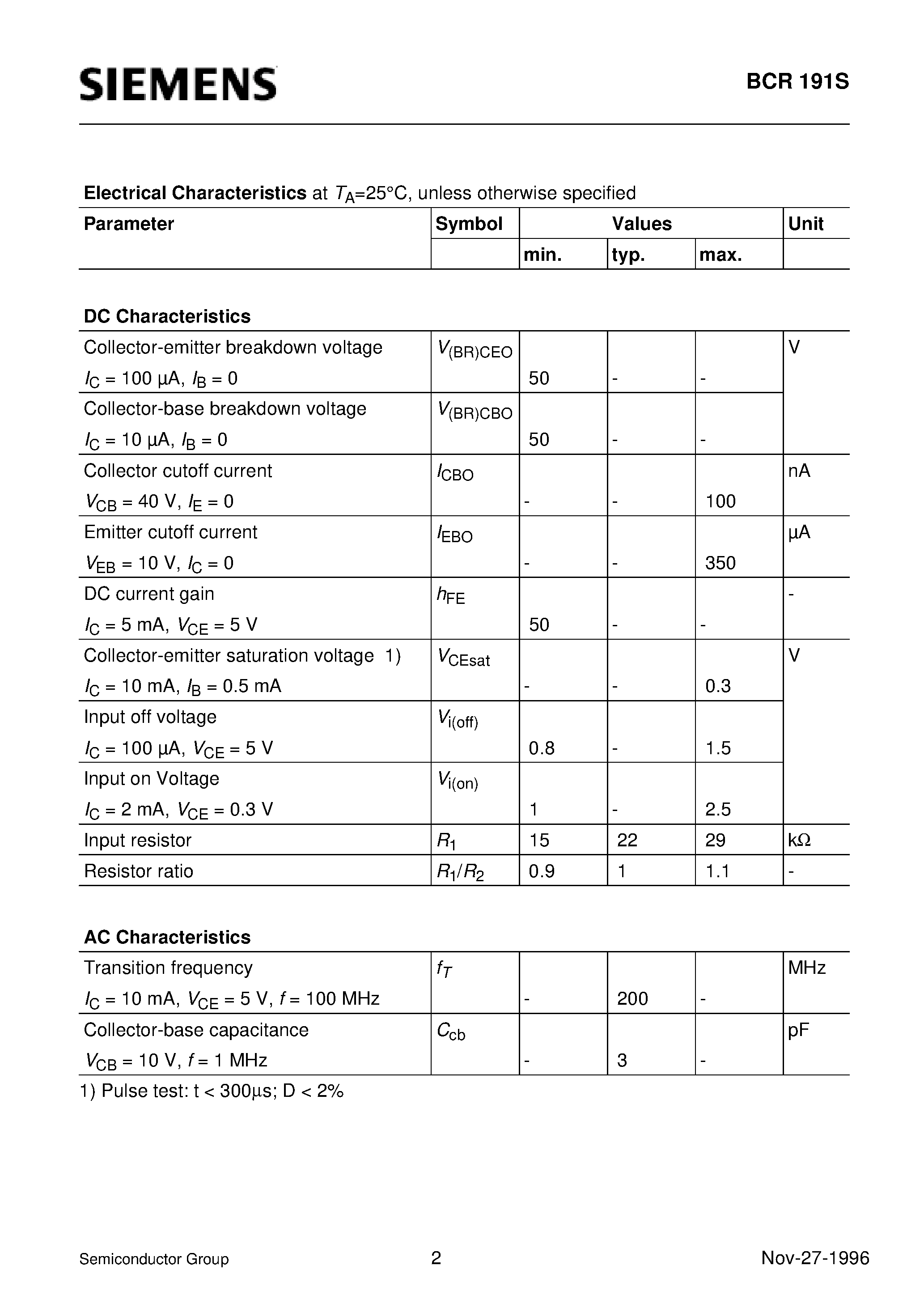

Datasheet Q62702-C2377 - PNP Silicon Digital Transistor Array (Switching circuit/ inverter/ interface circuit/ driver circuit) page 2
