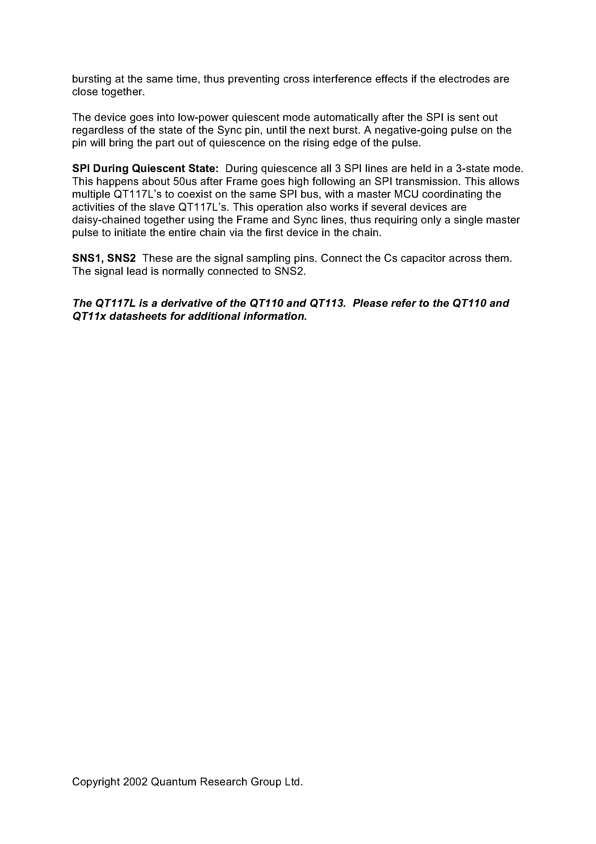

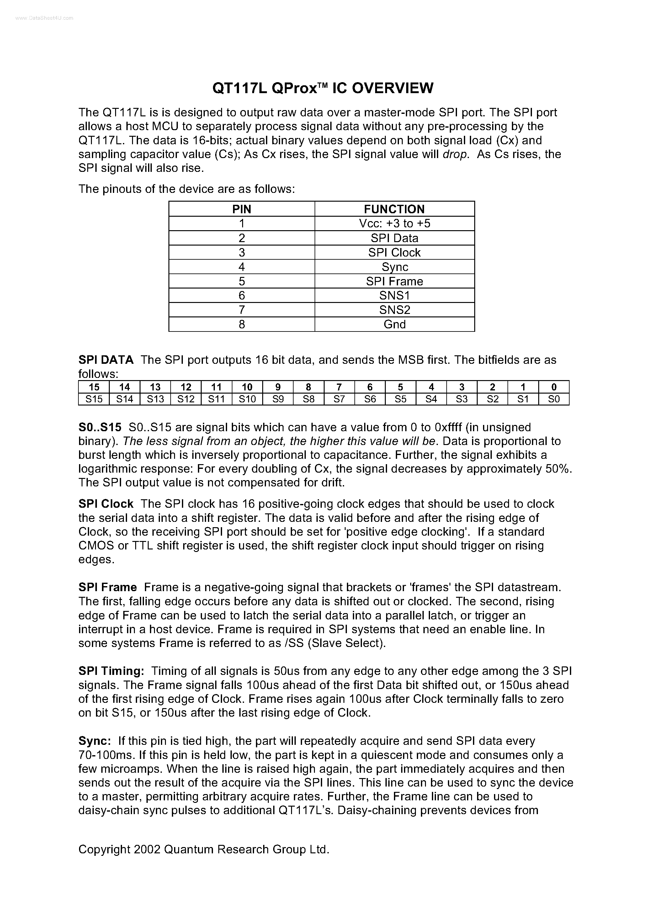

QT117L-Designed to Output raw Data over a Master-mode SPI Port
Producer:QUANTUM
Description:Designed to Output raw Data over a Master-mode SPI Port
