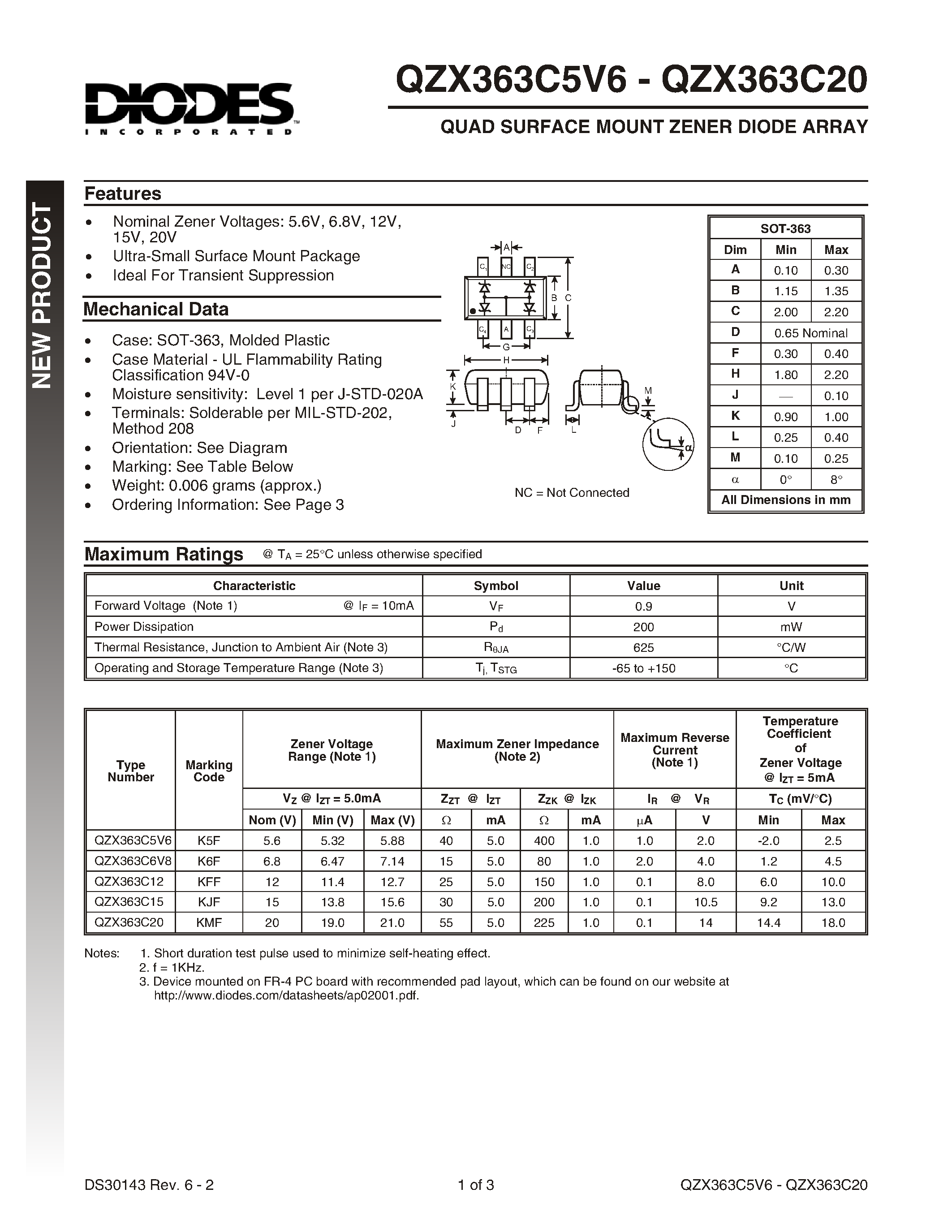

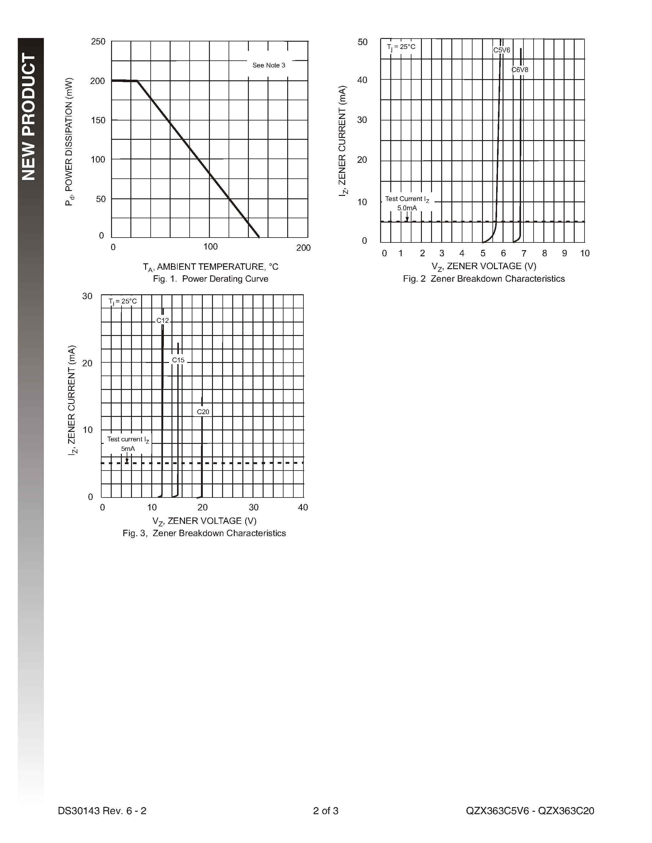

QZX363C12-QUAD SURFACE MOUNT DIODE ARRAY
Producer:Diodes Incorporated
Description:QUAD SURFACE MOUNT DIODE ARRAY
Others with the same file: QZX363C12
Datasheet QZX363C12 - QUAD SURFACE MOUNT DIODE ARRAY page 1
Datasheet QZX363C12 - QUAD SURFACE MOUNT DIODE ARRAY page 2
