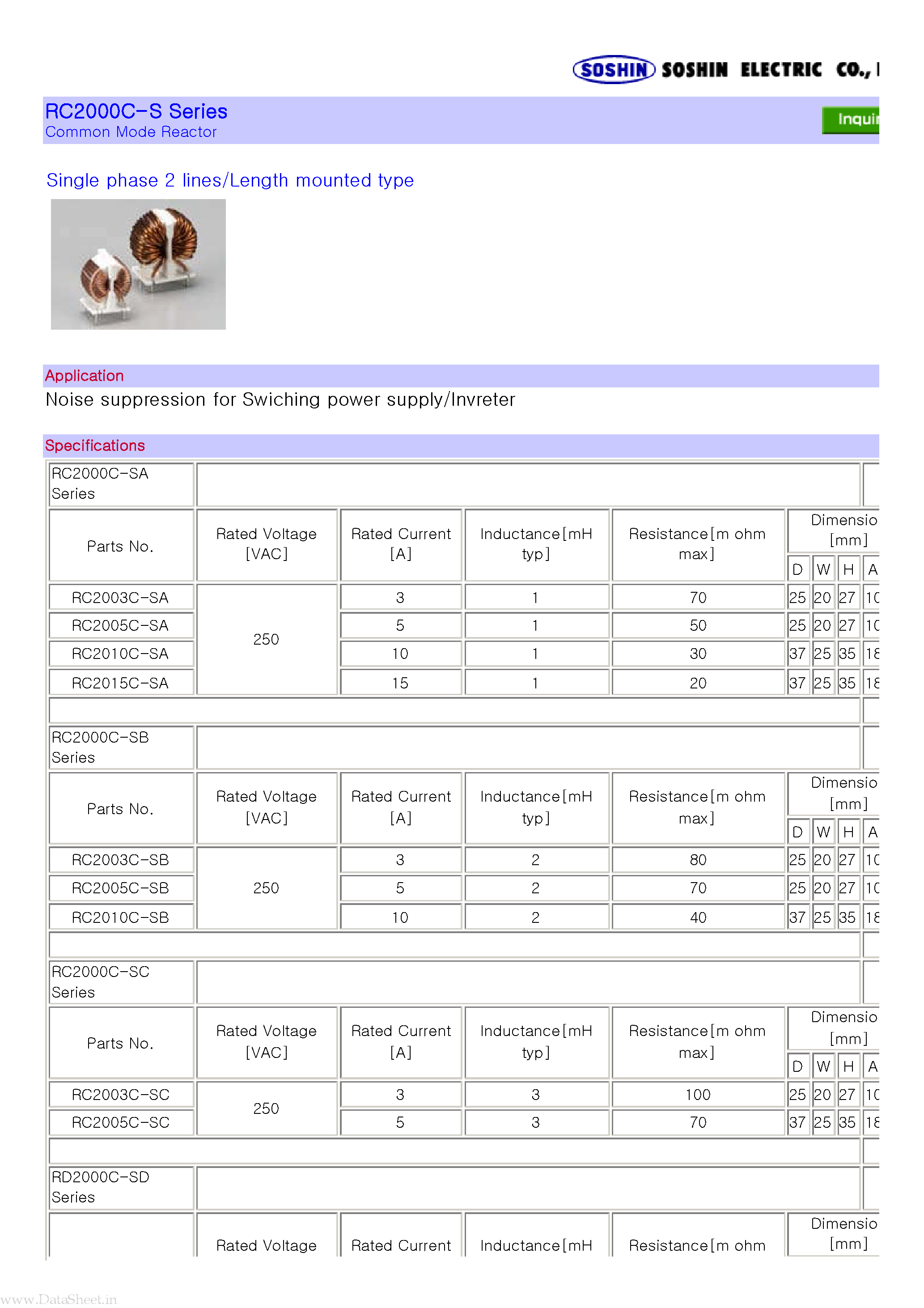

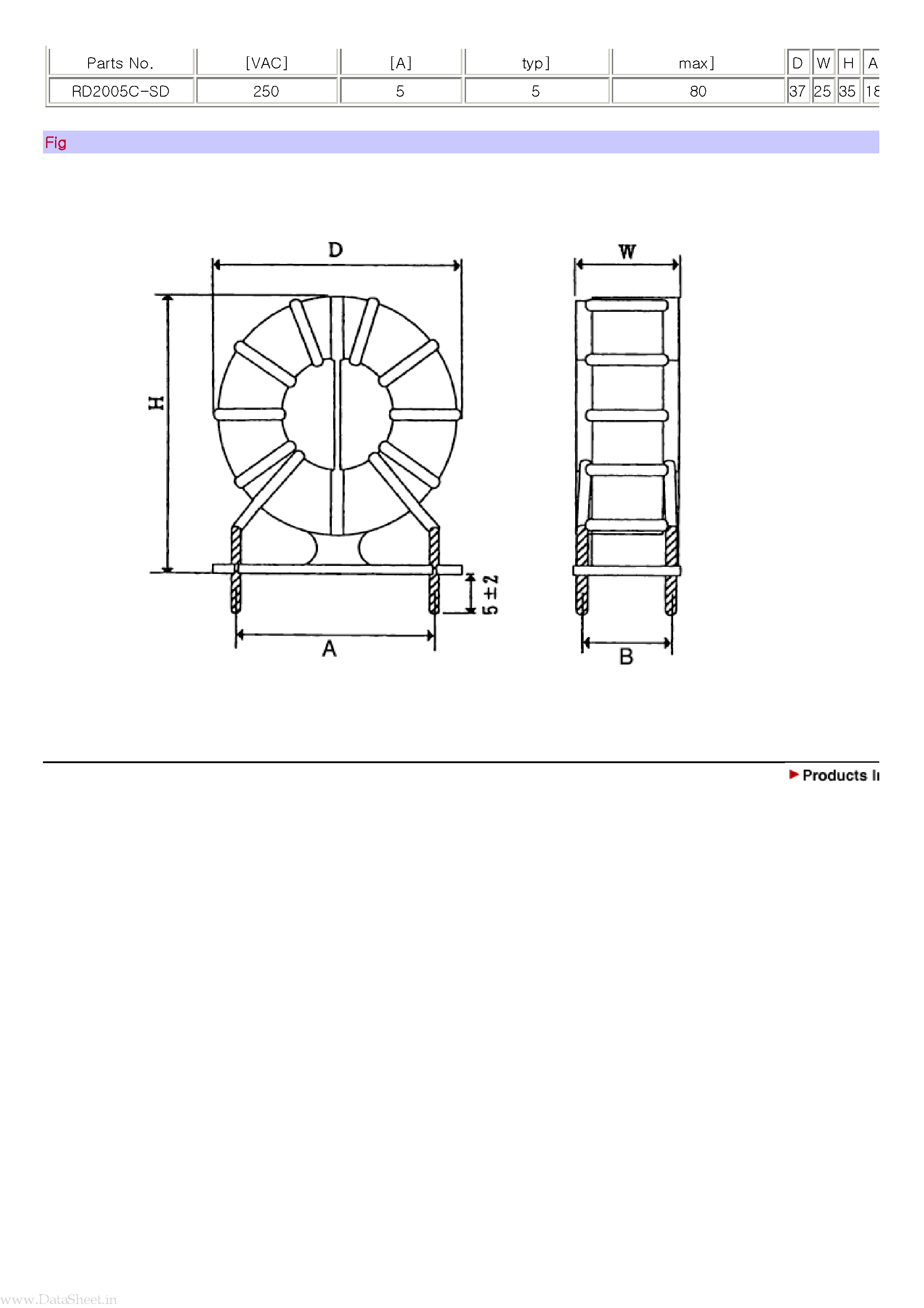

RC2000C-S-Single phase 2 lines/Length mounted type
Producer:Soshin
Description:Single phase 2 lines/Length mounted type
