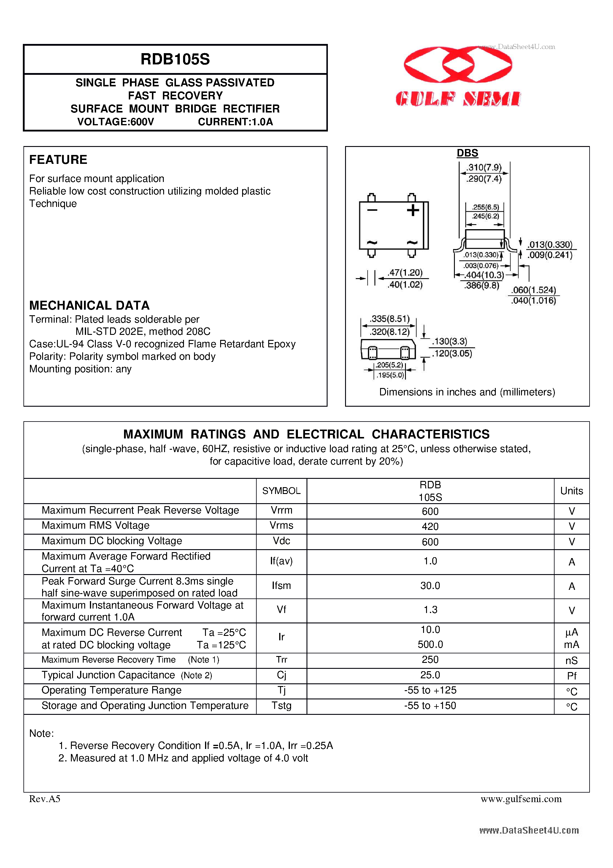

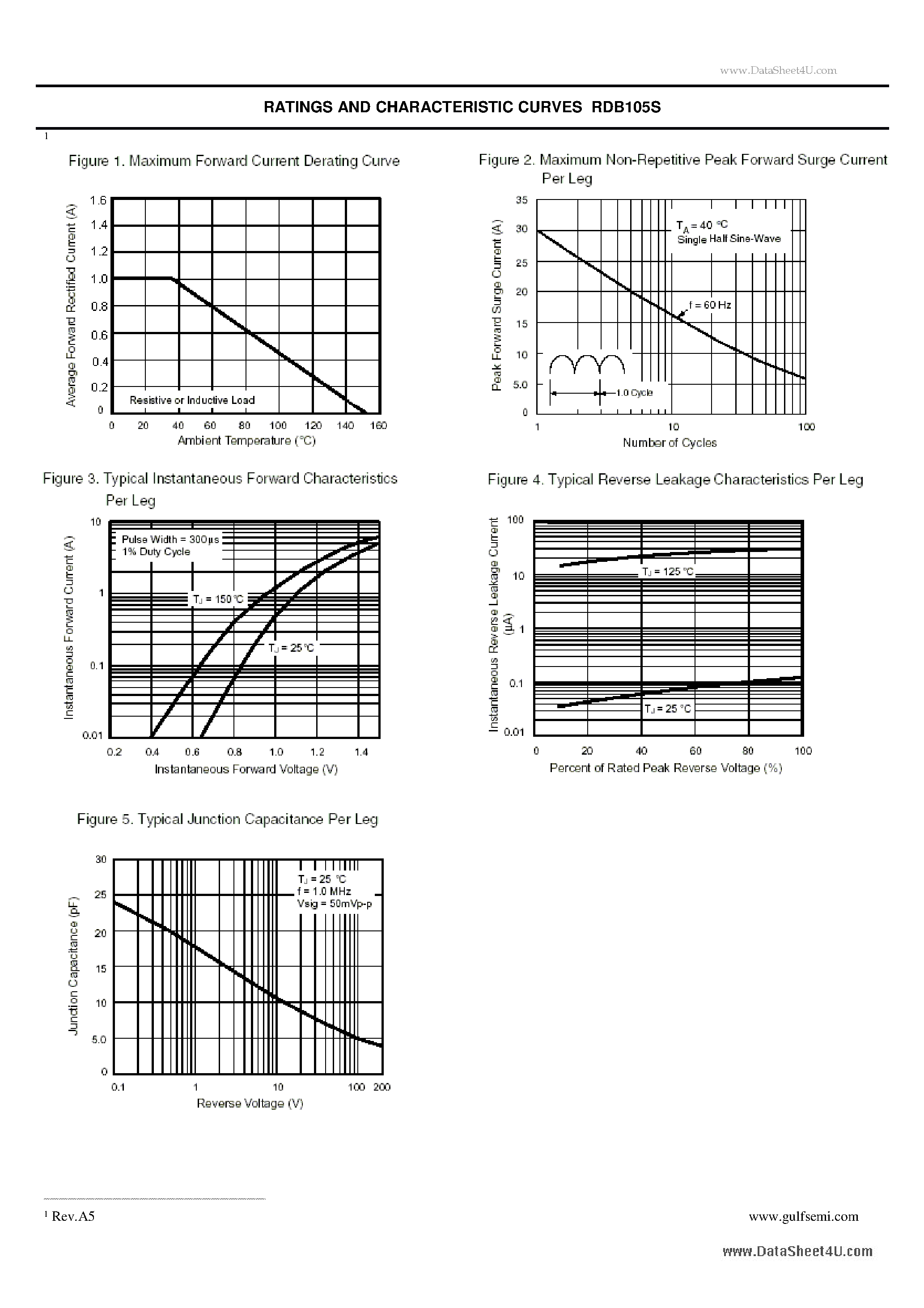

RDB105S-SINGLE PHASE GLASS PASSIVATED FAST RECOVERY SURFACE MOUNT BRIDGE RECTIFIER VOLTAGE:600V CURRENT:1.0A
Producer:Gulf Semiconductor
Description:SINGLE PHASE GLASS PASSIVATED FAST RECOVERY SURFACE MOUNT BRIDGE RECTIFIER VOLTAGE:600V CURRENT:1.0A
